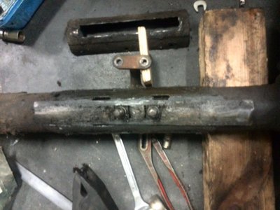

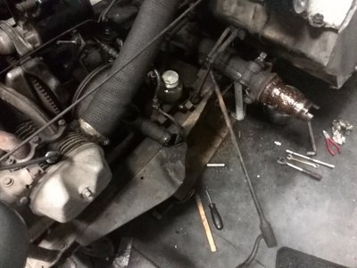

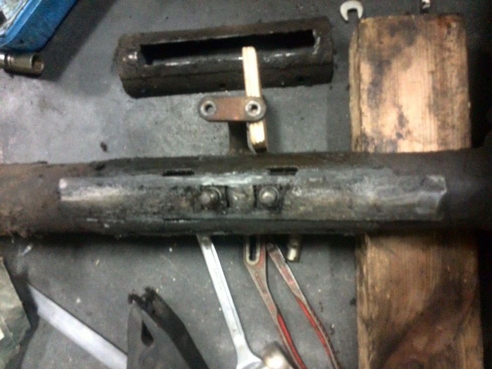

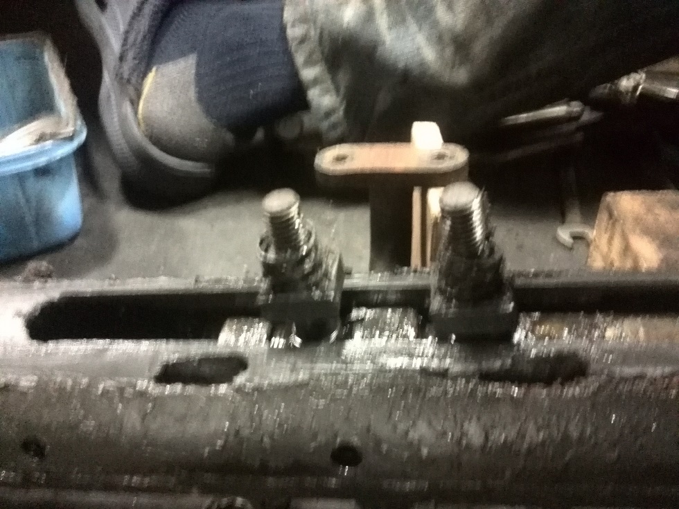

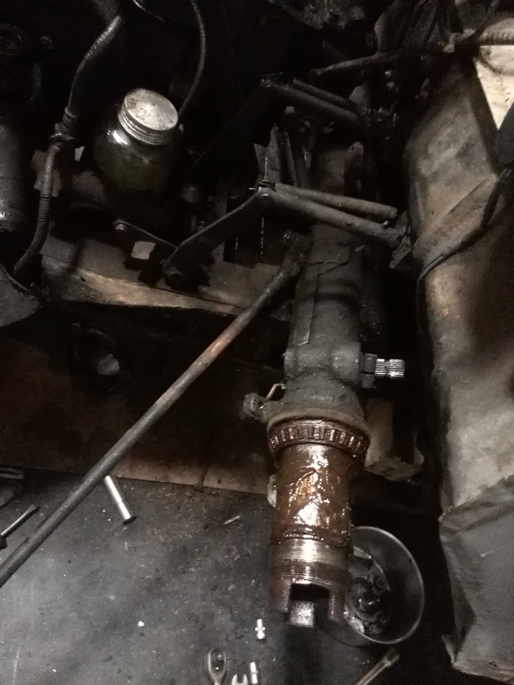

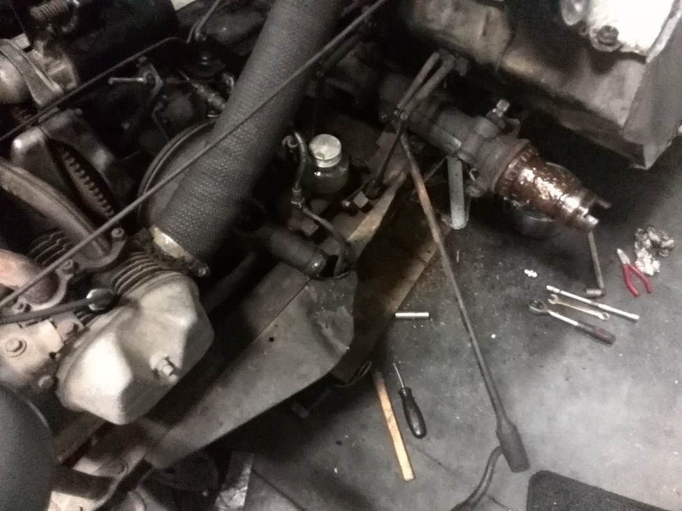

Post Havy vibrations in steering rack..

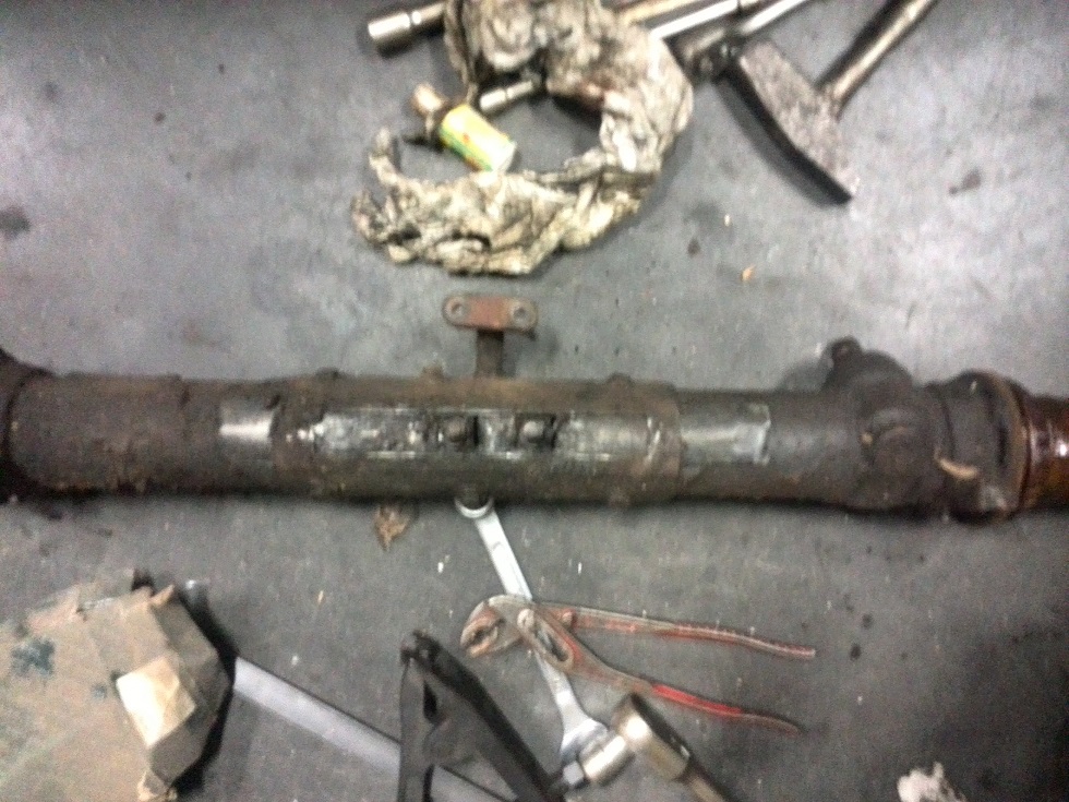

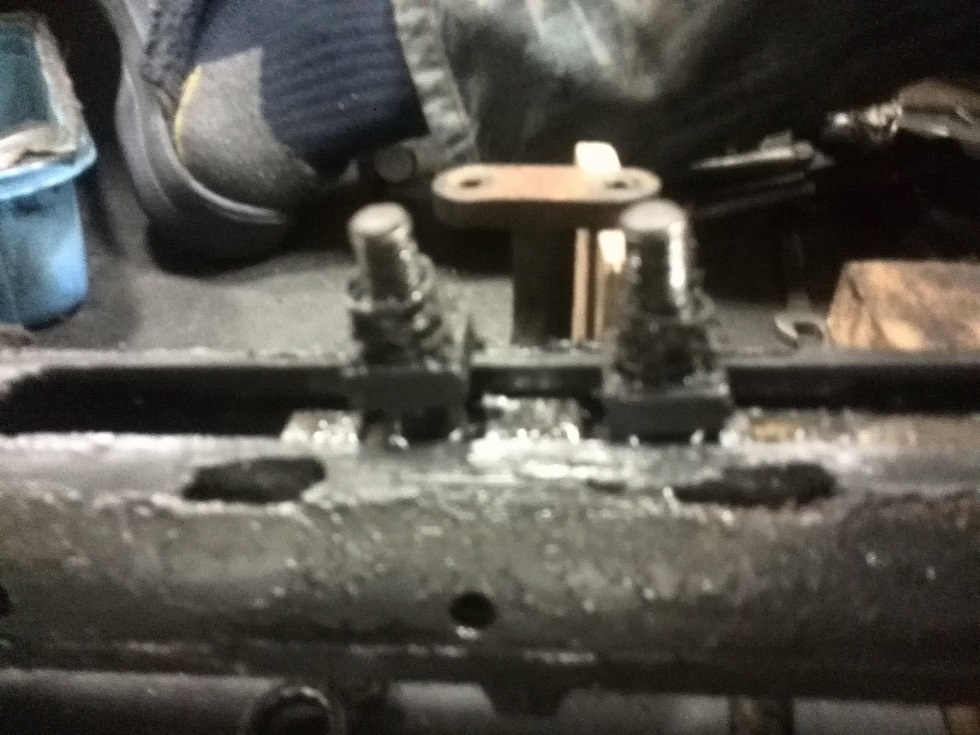

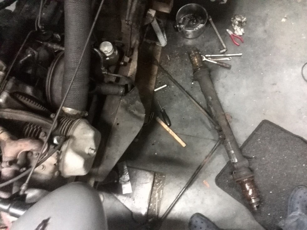

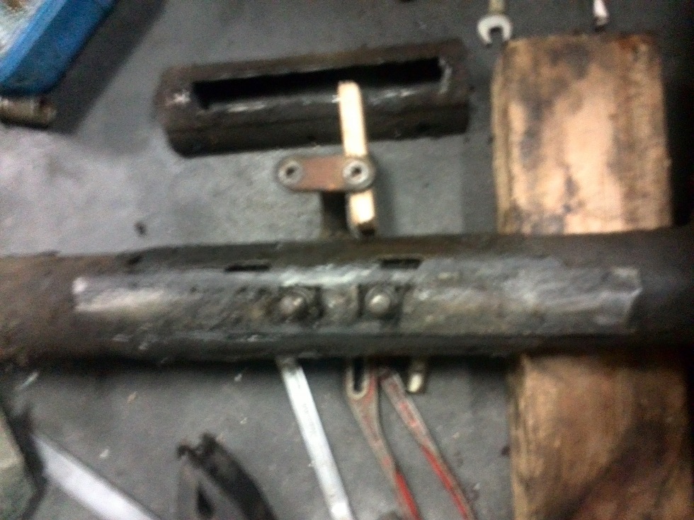

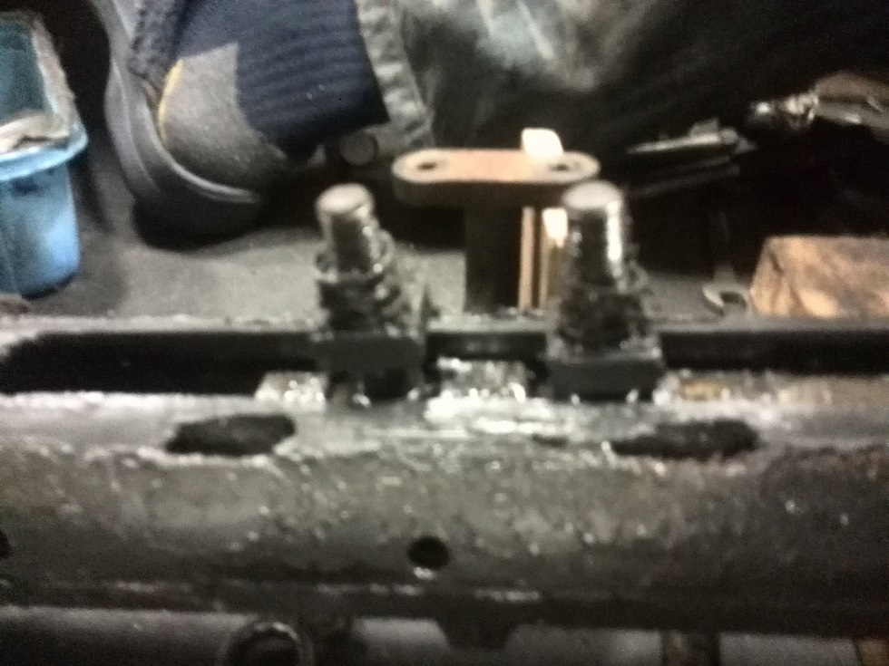

Ok. I need some help here...
The front wheels and steering wheel on my old snail are havy vibrating when I'm driving over 50 km/h. The only thing I can do then is reduce speed to about 40 km/h and then it stops.
What did I do sofar......... what not...
First I changed the left suspencion arm, nothing
Then I changed the left crossjoint (old type had to much play) and yes I lined them up as they should be (miror the inner to the other join)... nothing
Then i changed the right suspencion arm... nothing
Then I changed the left wheel.... nothing
Then I changed the right wheel.... nothing
So this evening I took the front axle out of the car to investigate the steeringrack...
Now for me it looks nice and has almost no play. The only thing I can notice is that when I
push the right wheel to the left the steering arms is pushed into the steering rack giving it play. So can anybody tell me what pieces an old steering rack needs???? I know the reqtangle rubber isn't used at the old snails like mine (1955)....
and now some (lowsy) pics....

are the track rod ends all adjusted up properly, thats the usual cause

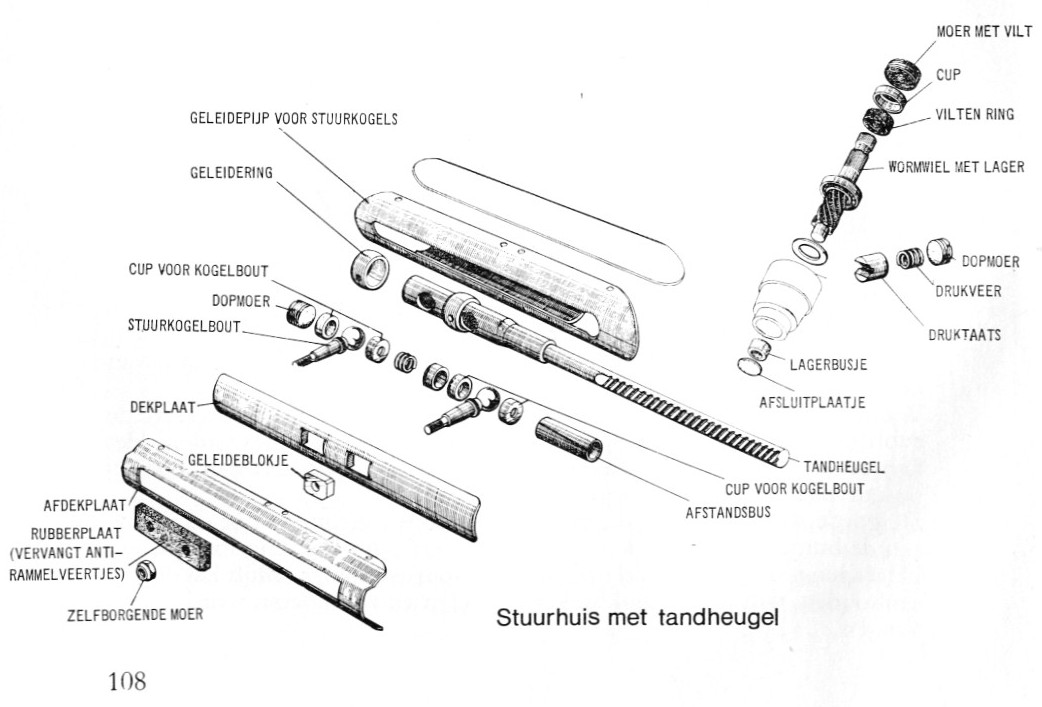

Studying this picture everything is looking allright, square slidingblocks?? are as new; ball-bolts?? are new with almost no play, play in the spring is about .5mm so allright for me.. The only thing I noticed thinking about it, is the sliding plates where very loose, the scews of the sliding-roll??? (geleidepijp voor stuurkogels) where also loose too, so I hope this is my problem... Tonight I will put it together as it should be and hopefully the problem is solved...

Replace the geleidering on the tandheugel, and possibly the geleidepijp.
