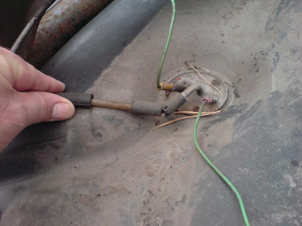

And anothet top tip-if you have the shell off at any point, replace the little bit of rubber fuel pipe from the tank. It's easier to get the tank saddle off (IMHO) than to drop the tank afterwards! :ugeek:

I wish whoever rechassis'd the baboo had changed that poxy little pipe...
