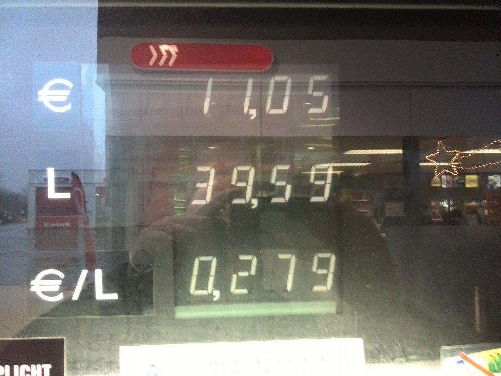

At the moment it is 26 eurocent a liter (just across the Belgium border)... so I luve it.......

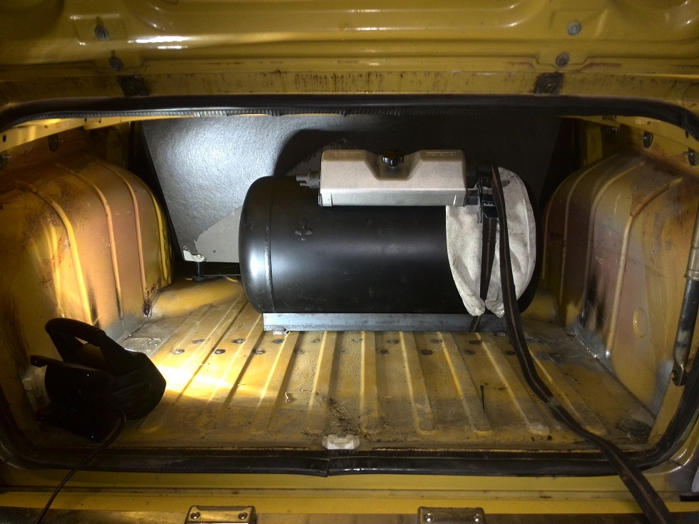

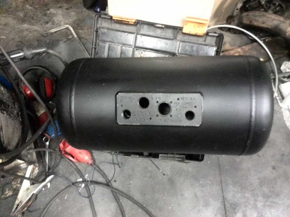

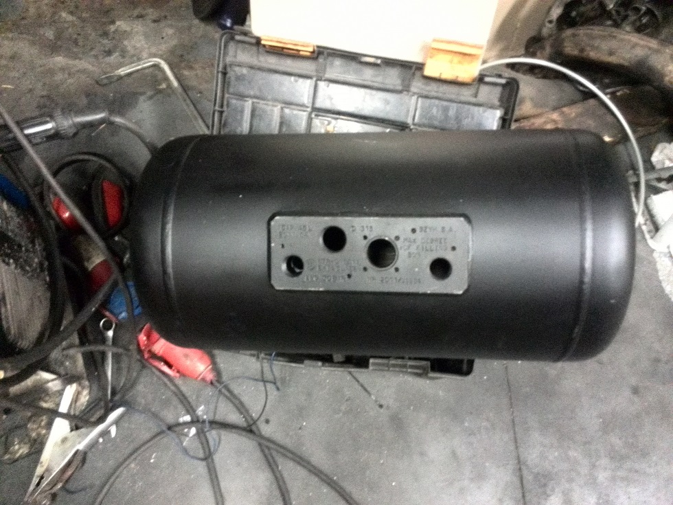

The tank I bought for 95,-- euro delivered to my door..

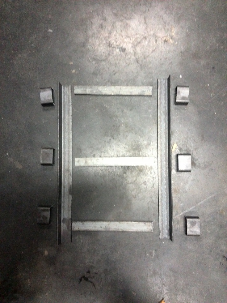

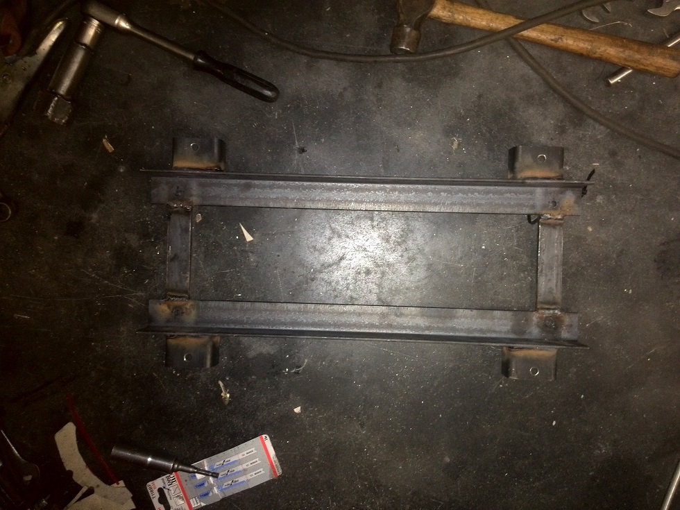

some pieces to make my own tankframe
a littlebit of weldie weldie :lol: :lol:

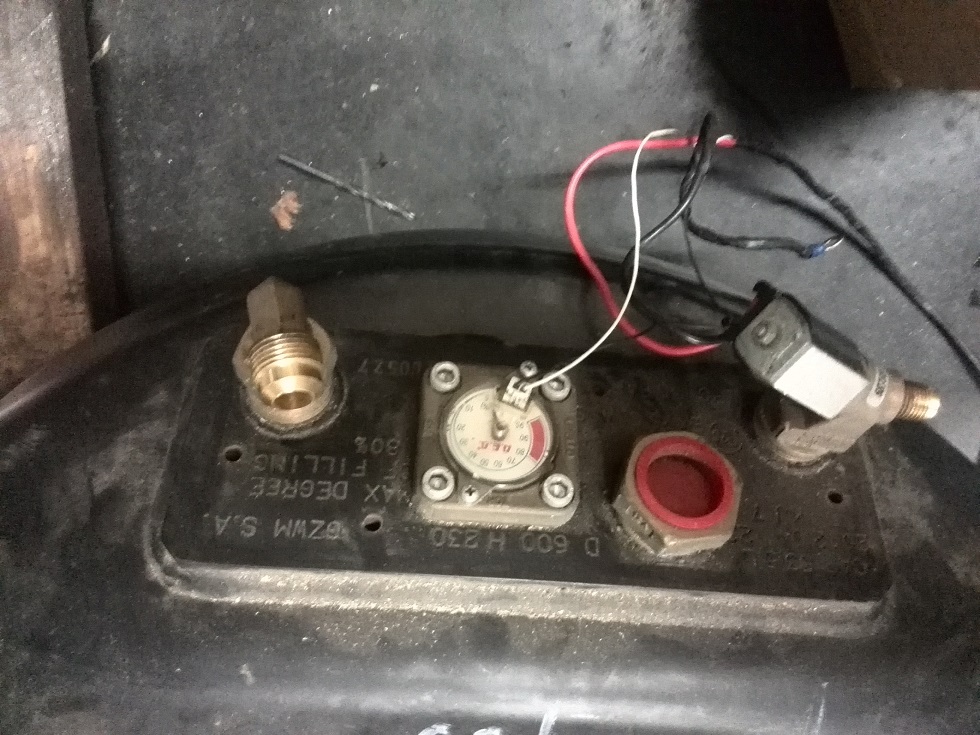

fitting of some pipes; shutters; a gauge aso.

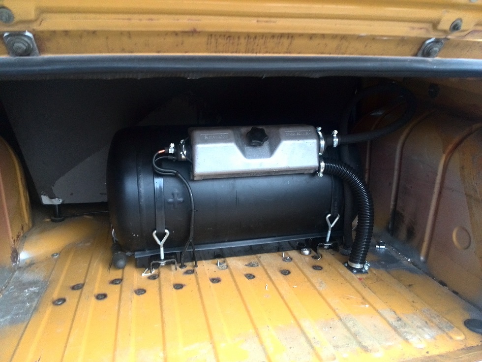

testfitting of the tank...

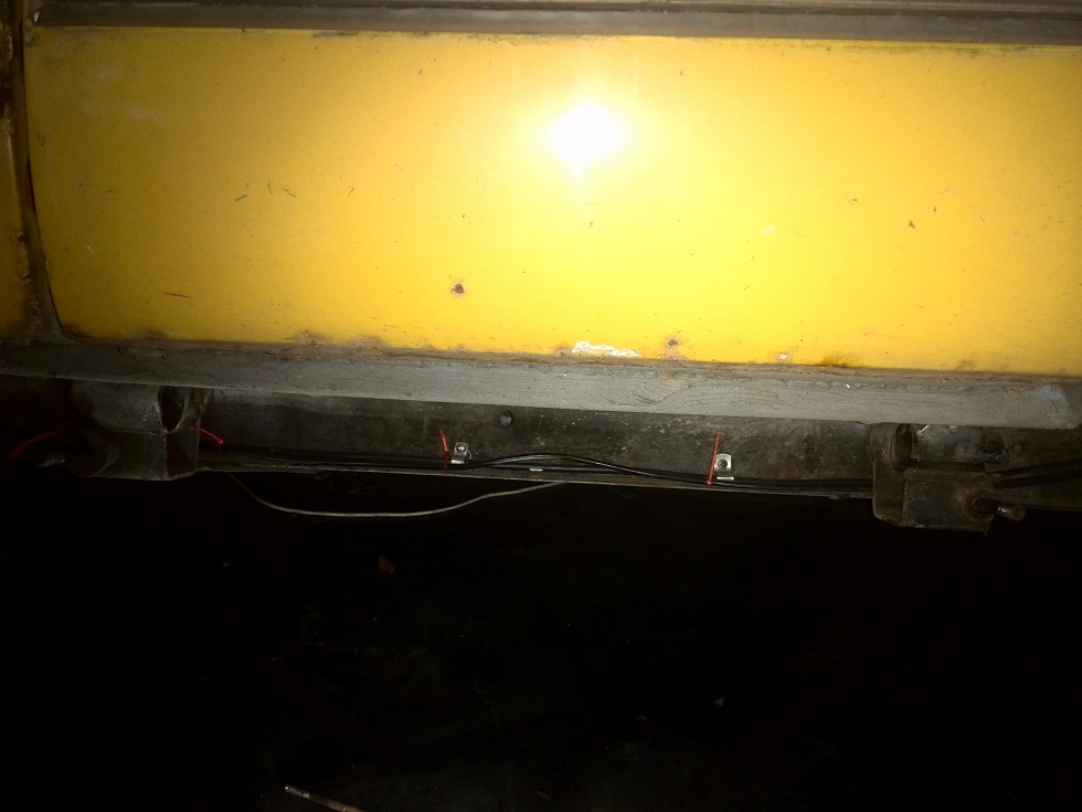

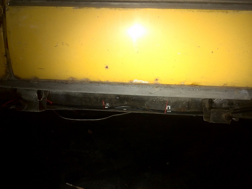

placing the 6mm lpg copperhose to the enginebay...

making everything nice and shiny according to the (Dutch) rules

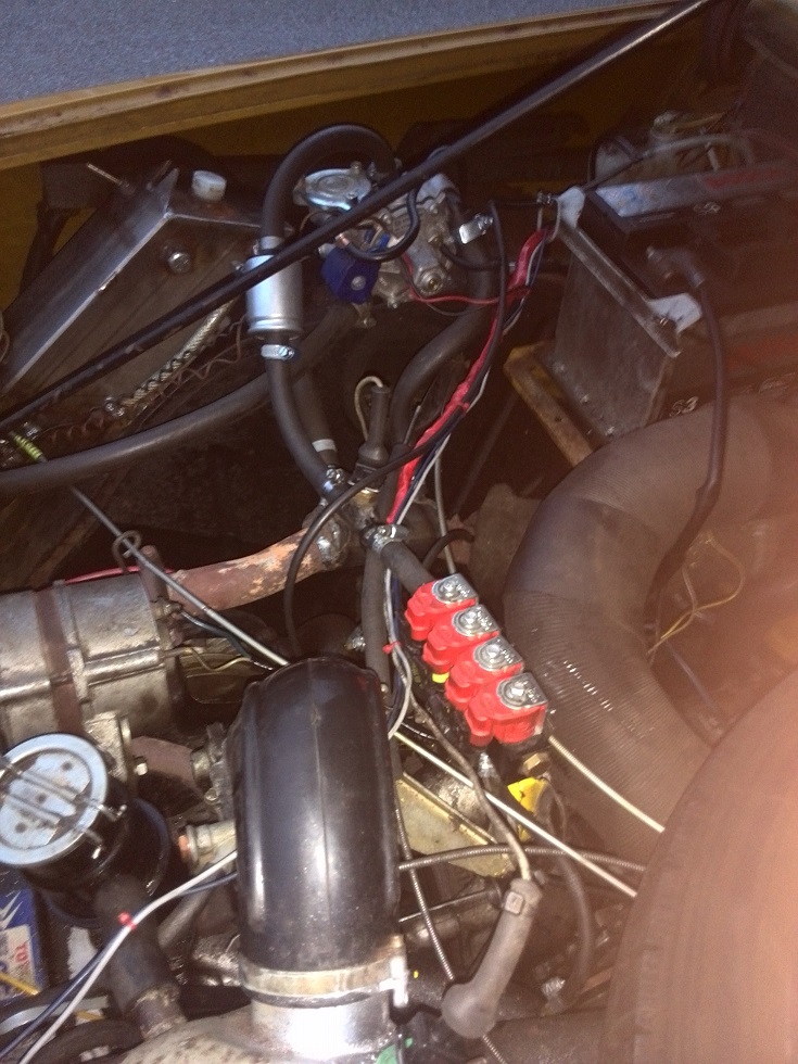

and a look into the engine-bay...
littlebit of tuning and of to the RDW...

I see 4 injection-valves (red) in your last picture - I assume you still have the 2-cylinder engine mounted and not converted it to an Ami-supre 4 cylinder ? Does this mean you apply sequential LPG-injection with 2 injectors per cilinder ??
with LPGO almost nothing is standard, also this application is a little bit technically upgraded - keep up the good work Geo !

These are the injectors comming from my Bx-sport and yes I now have several possibilities...
At the moment I'm running semi-sequential injection with 2 injectors... So I have 2 injectors available for 1-2-squirt... If somithing goes wrong I can directly switch to Megasquirt and drive on.....
You need to know it is harder to get a car run on lpg injection rather the Petrol.. The ARF bandwidht of gas is much less then petrol.. So if my engine runs decent on LPG it will surely run decent on Petrol...
and if I don't need to switch to Megasquirt anymore I can make sequential staged injection as you wish... However if we want to do our setup (1 BMW 1150/1200 throttlebody you best you can run is semi sequential...
