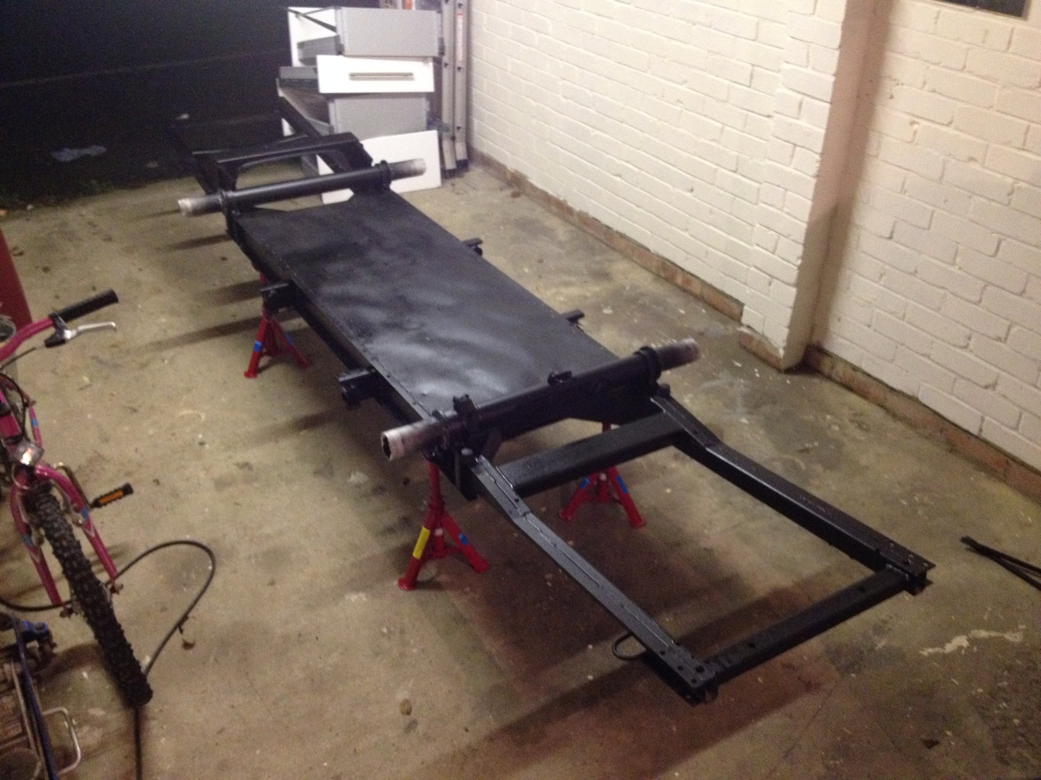

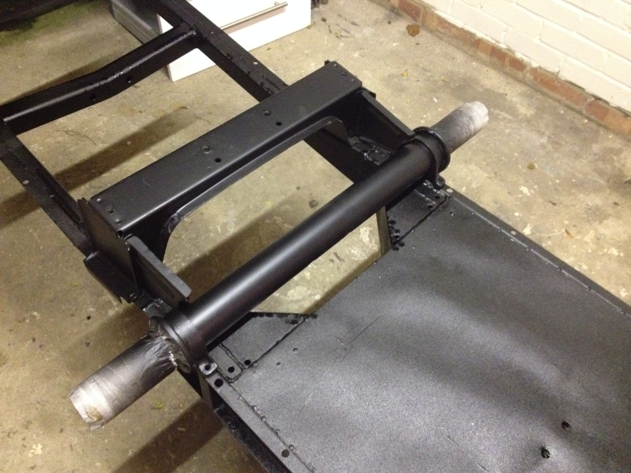

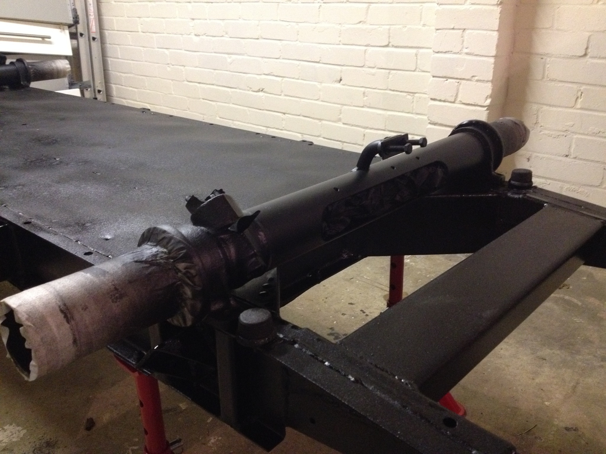

Today I took the pinion out of the rack along with sll the other innards, basically I made a sloppy job of it first time and got swarf from drilling the grease nipple holes. Now it's been cleaned out again a bit more thoroughly. I repainted it with s better paint product along with the rear axle, shocker mount plates, tank saddle and steering tie rods. Looks better, I wish I'd done the chassis in it too actually. I need three arm bearings, but five are absolutely fine. The inner bearings came off really easy by using a bread knife hammered into them to open the gap and then pull them off. It's a bit annoying doing everything twice but I'd sooner have it working better than when I took it to bits.
November 12th, 2014, 9:11 pm
A few pictures.
