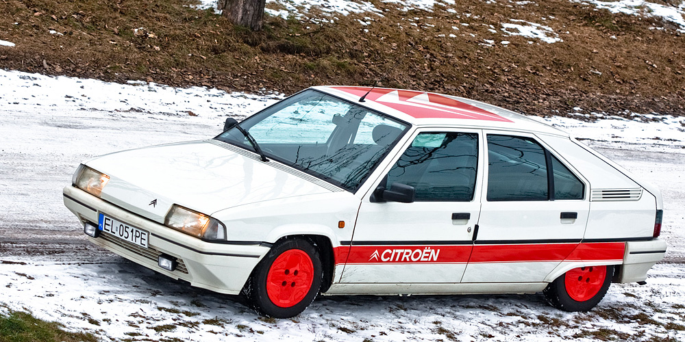

banjo wrote:
The main advantage with this method is you can submit want you want by email and the result is posted back for you to fit. The positioning is easy with soapy water spray then sqeezy out the water and air,so the image sticks in place 8-)
This is how I did my car, these stickers are quite large and required care to lay them out properly, but after a winter spent half outdoors, spring, summer and numerous car washes they are still perfect.
