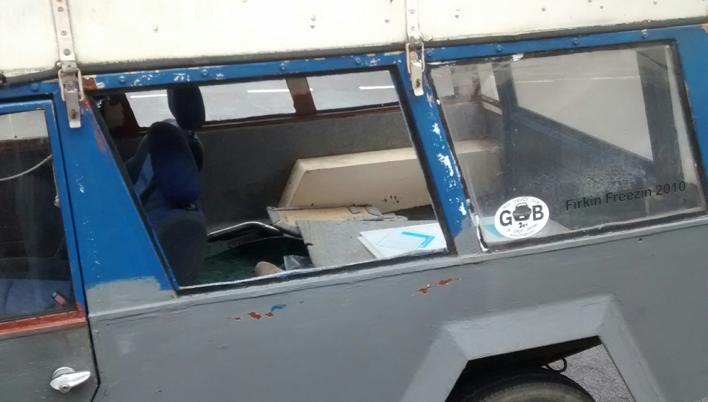

Time to install windows with rubber seals rather than have them glued in as the glue is becoming a bit unstuck. The missing one here is somewhere on the side of the motorway during a stormy trip last week!
Really wishing I had square or round holes rather than this shape.

Close the side up and make a van of it. Or punt an large plexiglass sheet over all the side?

I fall out of love with the Shed occasionally.
I've made a template for cutting the seal.
Angles are 110 and 70. So I new to cut them at 55 and 35 degrees. Gotta keep the inside inside, and the outside outside.
Does my head in. :lol:

AZL57
I like your thinking, with I had that idea before I bought the seals. Still, it will look awesome when I've done it. :D
Just gotta keep telling myself that. :lol:

Damn, I hate these windows.
So! Its measure once and cut twice!!!!

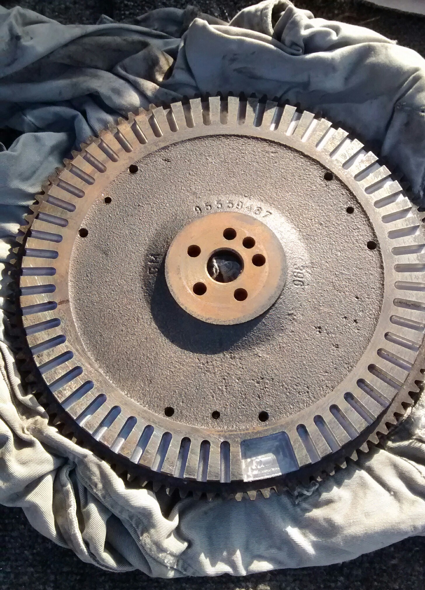

I had a trigger wheel machined into the flywheel. Both the engineer and I are both on a learning curve here, so we will see how it works out. :D

;) Rebalanced afterwards?
60-2?
