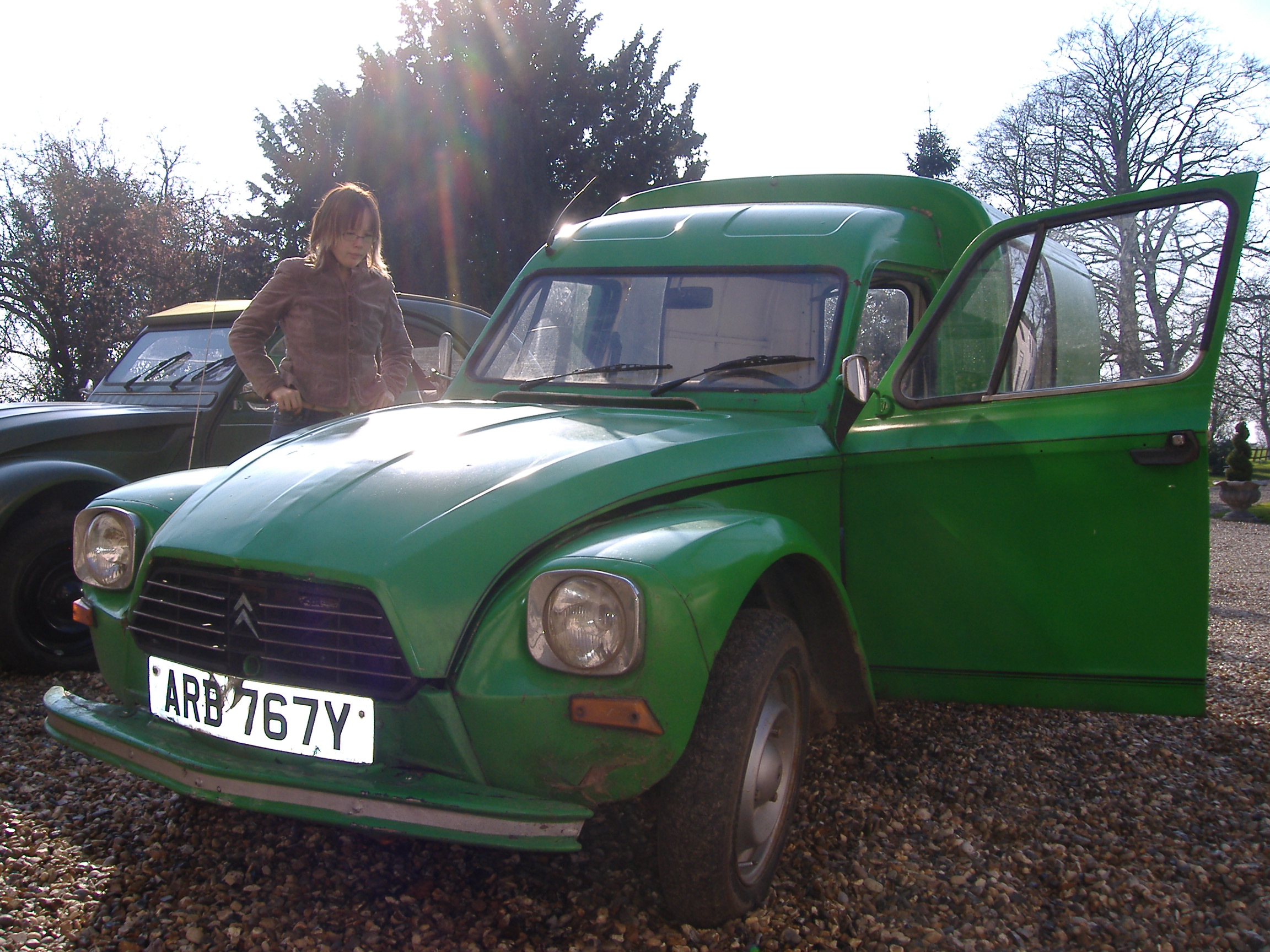

I *think* this rear bumper is the same as an early Dyane bumper:
http://www.ecas2cvparts.co.uk/bumper-re ... -1125.html
so that should be a case of lobbing the grey insert on.
2CV front bumpers are different to Dyanes, early or otherwise.
