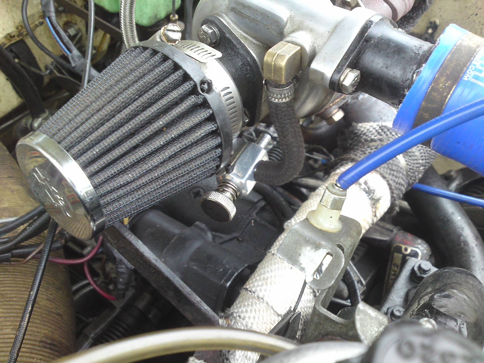

Fitted variable boost control valve today - now can go from 0.5 bar to 1.2 bar - at the moment set around 0.7 bar - no knock but will try on motorway with laptop next to me maybe at the weekend...

You can fit the controller at the dashboard, adjusting boost at the fly/on the run 8-) 8-) 8-) 8-) 8-)
Next a intercooler?????
p.s. Do you still want a run at a dyno??? at Burton, I'm going to deliver some 1-2-spark markII soon and 1 guy wants to go to the Burton day with it comparing it with 123 ignition 8-) 8-) 8-) 8-)

Did run down the motorway today and WOT and 0.7-0.8 boost and 135kph and no knock so no need to alter advance curve.
Was looking at one of these - will have to make mock up in wood to see if I can fit it somewhere.
