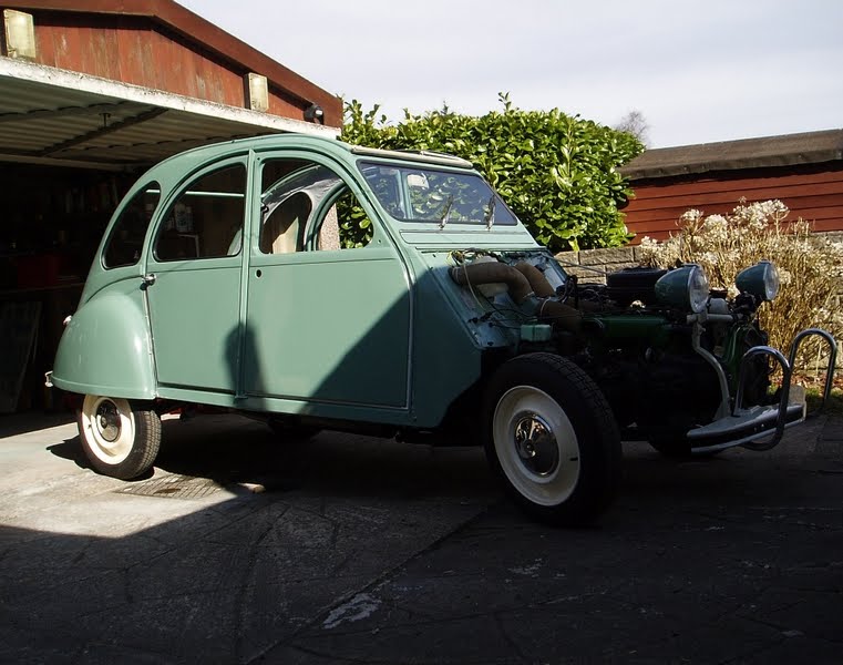

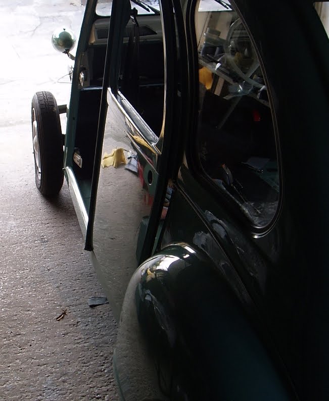

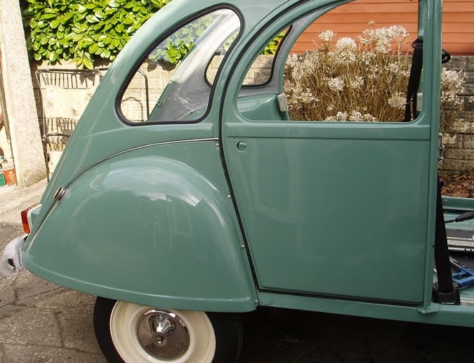

So it finally happened, a whole day without rain - and on a holiday weekend too! I was up first thing this morning in a bid to get those two back doors into paint before the clouds had chance to change their mind. As it happens the weather got better as the day progressed so I was able to put three good coats of paint over the tinted primer that I had put on previously.
Because of the general lack of room in my garage I opted to spray one door resting on my Mrs's long suffering pine chair, while the other one was suspended from the ceiling. Now both methods have their pro's and cons, but painting a door while it spins around in mid air with the force of the paint jet is not something I care to repeat. Being hung up sideways on while it dries means that there's less chance of any dust settling on the wet panel, but trying to spray a moving target certainly made life interesting for a while.
I painted two wet coats with a flash time of around twenty minutes or so in between, before putting on a final coat using premium high gloss thinners, which gave a pretty nice gloss straight from the gun.
I left the doors for a couple of hours to allow the paint to harden off some, before fitting the rubber door seal back on using waxoyl in the channel that it sits in. I also used plenty waxoyl in the hinge on the central body post, then slid the doors home. I'll fit the glass and door locks/handles tomorrow to finish the job.
I have still to buff out the paint yet using Farecla G3 as I did with the rear wings, but I'll do that in a couple of weeks when hopefully the front doors will be on there too, and I'll be fitting new bright metal trim strips to them.
As I pushed the car back into the garage I saw how well the paint had gone on and so took the photo below, it just left me wondering was that the door painted on the chair or by the spinning technique! LOL.

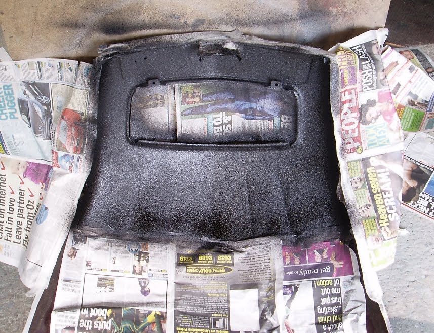

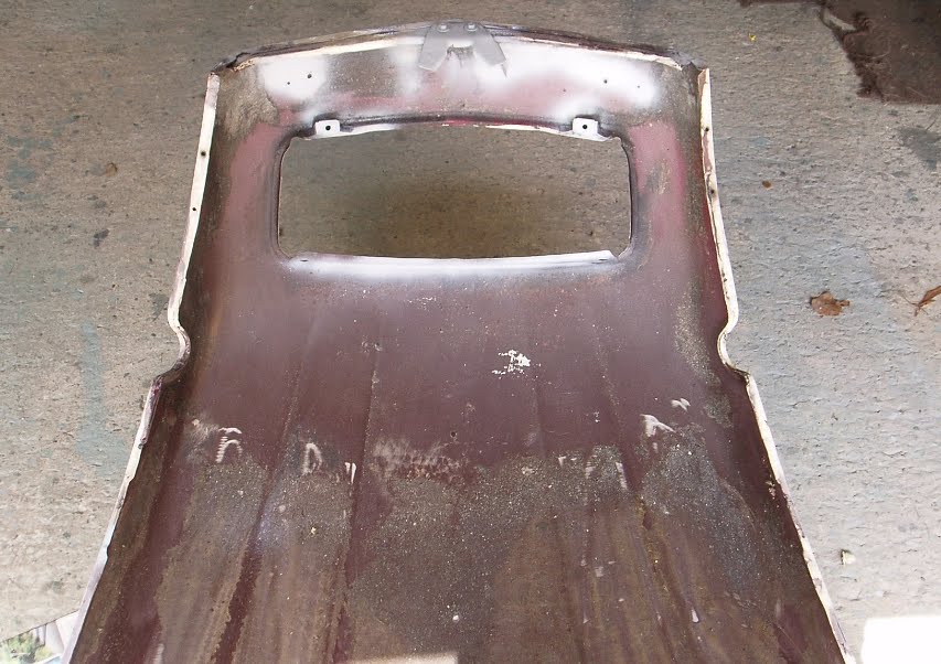

My last post told how I'd managed to get the back doors painted, which leaves just the front doors, bonnet, and front wings still to do. I do tend to hop around a little from one job to the next and today has been no different. The picture above shows the underside of the bonnet stripped out ready for primer, but after applying some etch primer to the bare metal I decided that I'd put stone chip on the rust prone inner grille section, the rest will be painted in the normal way before the new sound proofing is added.

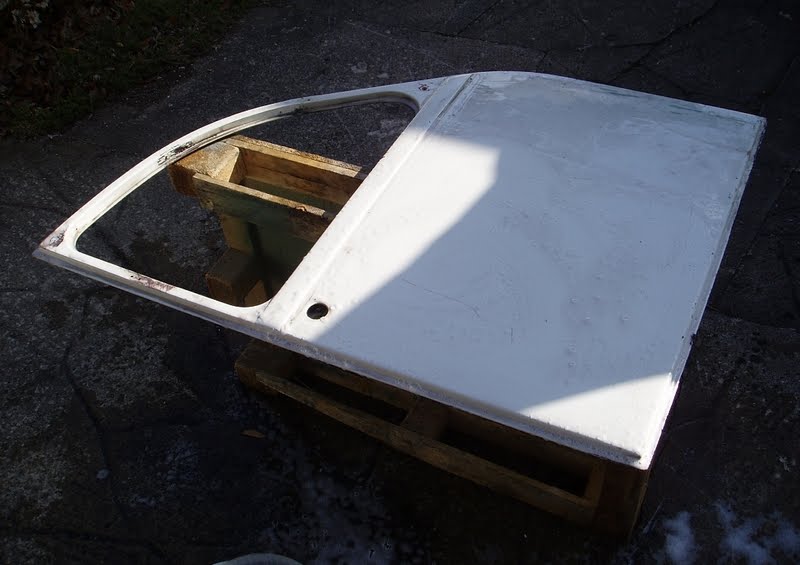

With that done I tuned my attention to the front doors. The pic below shows how they are after the fire that consumed the donor vehicle. Lots of burned paint and mess. I started out by washing them with soapy water, then let them dry in the sun for ten minutes before wiping them over with cellulose thinners. This should get rid of any wax polish that might have been on there before I started sanding the paint, as if I began sanding with wax still on there, or worse still silicone, then all that would happen is that the silicone would be embedded into the paint and the whole panel would need to be taken down to bare metal to get rid of it.
Now despite how ugly this paint looks, it is mature two pack which means it's very tough, and once the surface has been skimmed off it will make an excellent substrate for my new paint. Lots of sanding followed...lots... and all done by hand because it's too easy to get carried away and go too far when using a mechanical device. As the sun started to go down I was left with two doors that just need a little more detailed attention before the first coat of primer. The bubbly effect in the photo below is just soap suds by the way not bad paint.

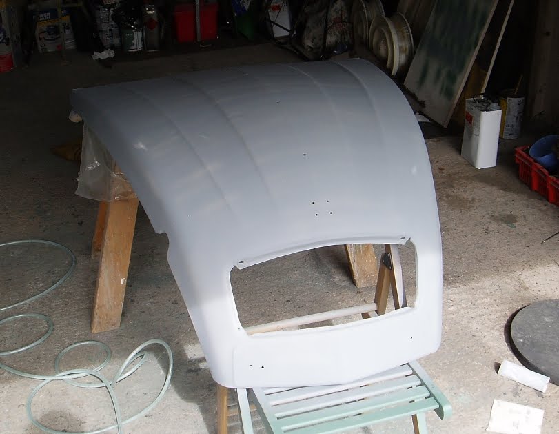

Another spell of nice dry weather has seen me prep the bonnet fully in readiness for the top coat that I hope to apply tomorrow. For those of you that are interested in the process I use then here are a few pictures showing the different stages of work.
I started out (above) by wiping the panel with laquer thinners to remove any old contaminants such as tar, wax or silicone spray polish that might have been on there, this was followed by panel wipe. I then started sanding down the existing topcoat using a dry open coat paper. I do this dry so that I can see where I've been, if I used wet and dry here then the water would confuse matters, making everything look too shiny.
I had previously circled with marker pen any areas needing extra attention, or that had edges needing feathering out, and made sure that I got them all attended to. Next step was to lay a couple of coats of grey, high fill primer, leaving them to dry. After they were dry I dry sanded them down again to level the surface, at this point I'm still using dry sanding where others use wet simply because Cellulose primer is porous, and I don't like the idea of putting water on there for it to absorb and trap under the surface.
After the sanding is finished the panel is wiped off again before a coat of primer tinted to imitate the colour of the topcoat was put on, this too is then flatted back. At this stage the surface is beginning to look pretty smooth, which shows up any minor imperfections such as the small chip below that I had somehow missed.
There were quite a few such small imperfections so I filled them with stopper, before flatting them back level again.
There followed a final toned primer coat and a final flatting back, still done dry using a foam pad on a block.
Once this was finished and once more wiped down with panel wipe the surface looked ready for the topcoat. I'll leave that job until tomorrow though, as I like to give the paint time to fully flash off overnight, maybe it doesn't need that long, but doing it this way gives me peace of mind.
