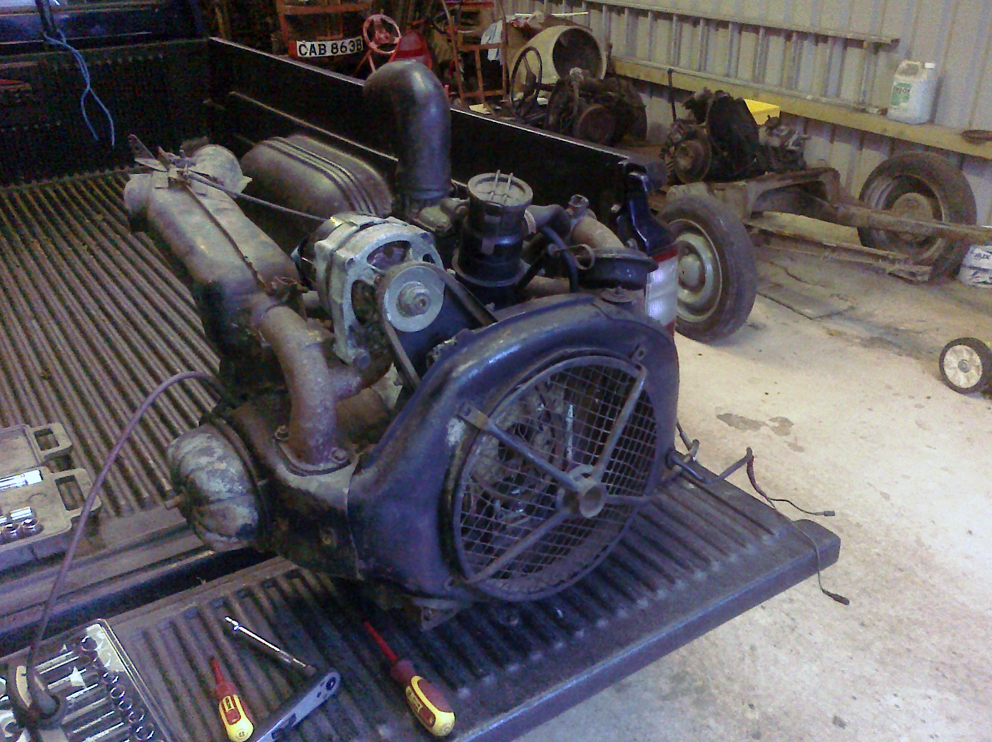

Just spent the afternoon dismantling the original engine that came with my van. Here's a few pics:
started with this:

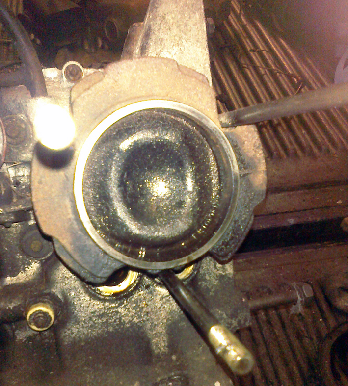

Offside barrel very oily:

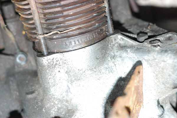

Can anyone identify this engine from these marks, stamped into both barrels? The stamp says AM111.101A
There is no tag on the engine. Page 7 of this thread shows other serial nos. that are stamped onto the bottom of the engine case. Other than these, there are no identification marks.

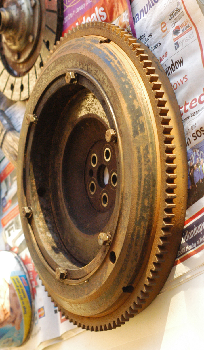

The heavy flywheel looked particularly rusty, but 10 mins with the brush and it's looking surprisingly good:

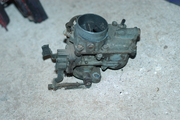

Carburettor is all there, but I have no clue as to whether it works.

Parallel heat exchangers = 435cc.
Alternator pulley sits further away from the fan cowling than on a 602.
However, cylinder bore, is it 68.5mm?
They usually have a rather distinctive flywheel, mind you, with much less metal
near the outer edge and the pcd of the flywheel bolts is smaller than that on
a 602.

It is the same engine as I have in my van , so must be 435 cc, also the same carburettor.

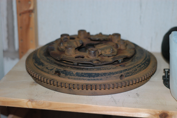

This is my flywheel before cleaning :
I presume it is the original, because the bolts where "sealed"with red paint.
Your flywheel looks more like Ken's description, Geert. Mine's got more metal:

That is what I mean , The engine is the same, the flywheel is different

Smiffy,
was that flywheel mounted on the engine when you collected your 'self assemble
van kit'? ;)
If it wasn't, might be worth checking that it will fit, as those 435 engines I've seen
had a flywheel the same as that shown in Geert's photograph...
