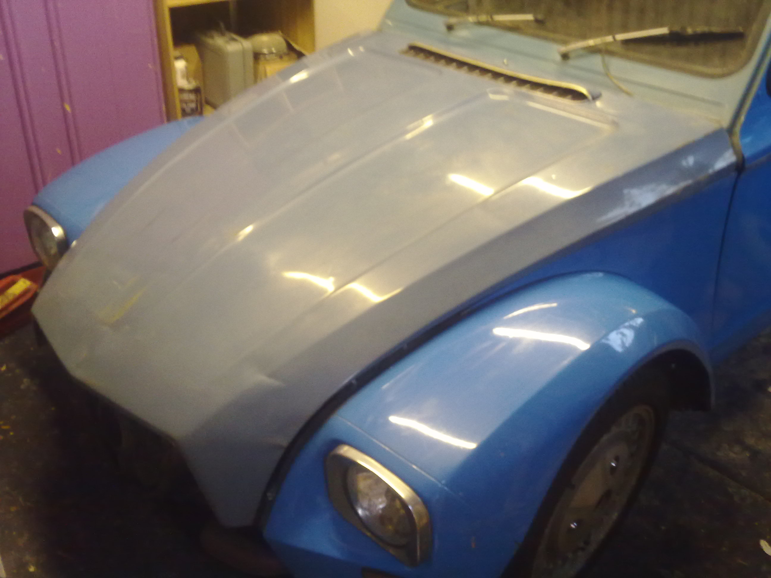

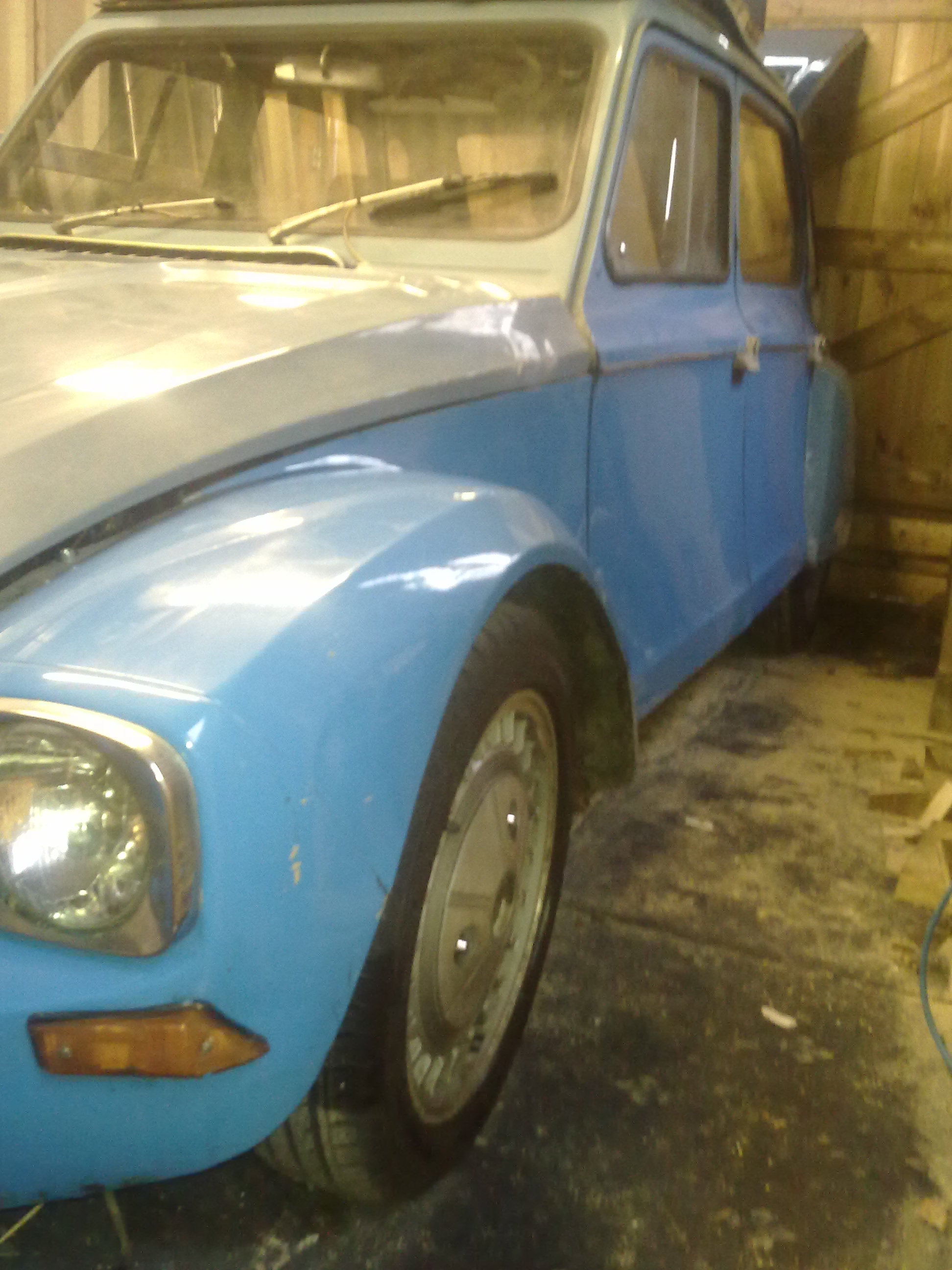

Have also moved it to its new home (my garage at home now) complete lack of space but at least I can now work on it much easier!! And have also added some joe to the panels and they have seemed to come up rather nicely....Almost lost the ole Rat look!!
