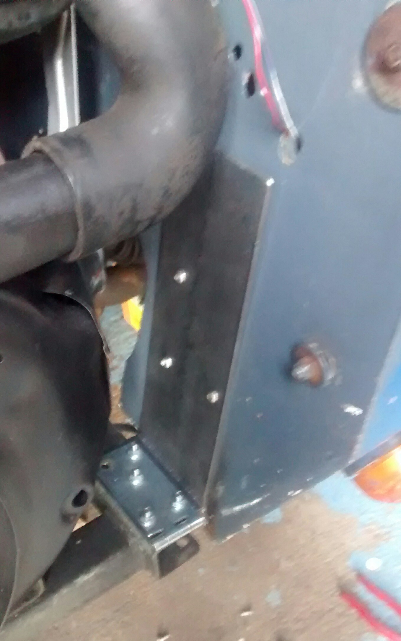

Having sorted the exhaust, and not wanting to climb under the car for a few bits I need to check out, on account of having a cold. Read that as very cold nights at the Hat Camp. :D
I fabricated a plate to attach the wing to the hinge for a tipping front end.
