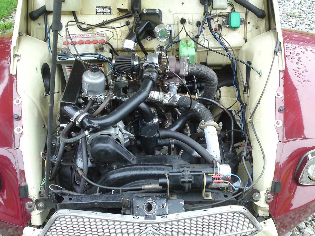

so about this turbo then chris?..where do I put it?? :lol:
Just about here..... as per mine - Geo has his slightly different....
