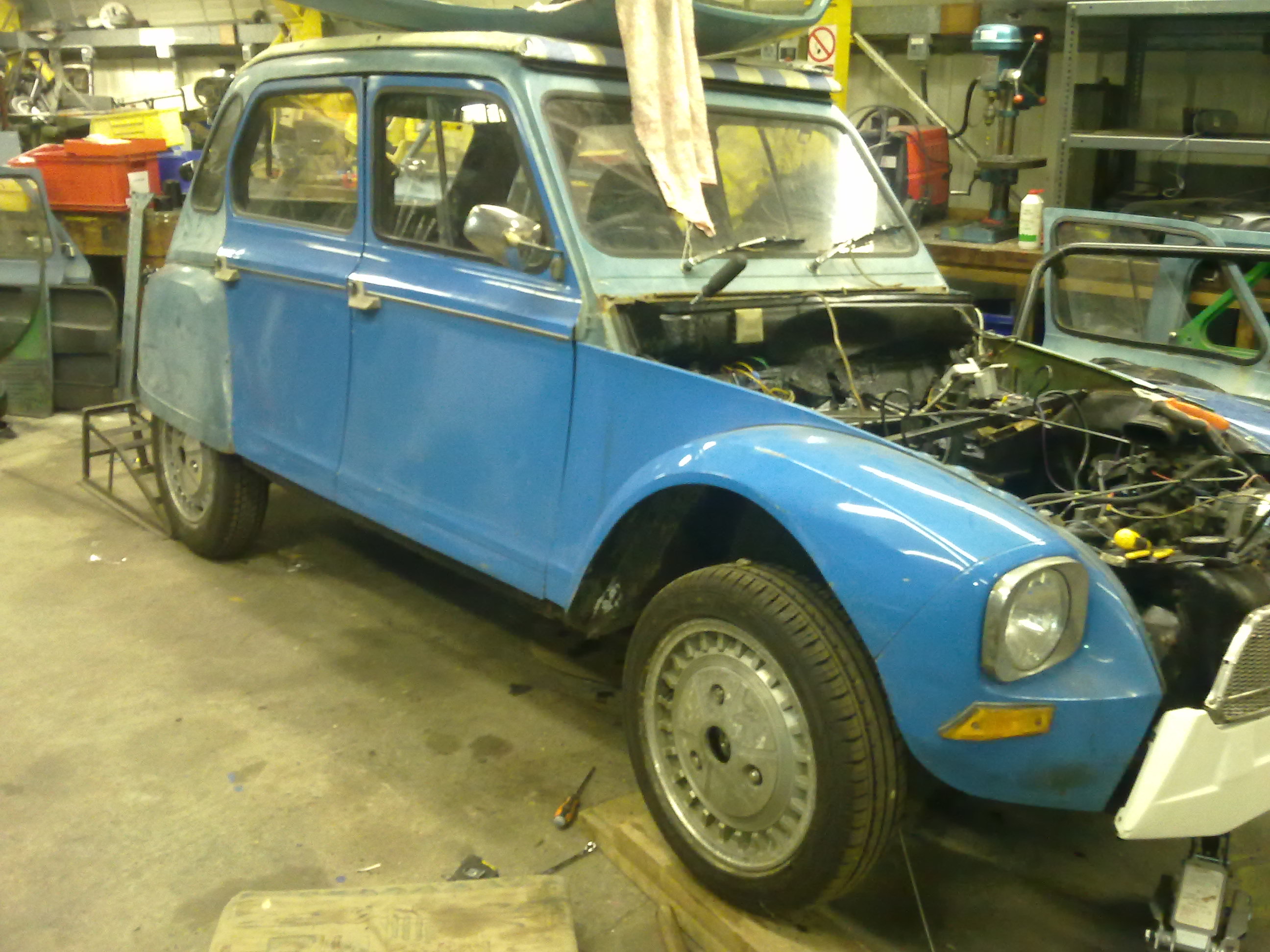

Not much progress this week, having problems with the accerelator cable and clutch cable...
Although have managed to get some decents doors wings bootlid as you can hopefully see in the picture!!
