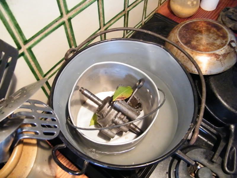

Too wet to do anything much today, I played with mobylette engine instead. (Nicely stewed crankcase, with bay leaves and a bit of ground black pepper. mMm, lovely :D )

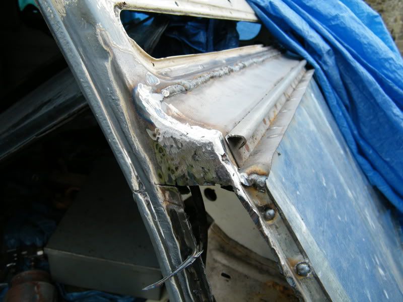

I really hate those bits there! Real pain to get nice. Still need to weld the holes, grind back again and so on. And I'm sure when it's shot blasted a load of pinholes will appear. :(

Also when filling up the areas like the winscreen A pillar put a copper support behind and dont go grinding back with a hard disk it gouges and is rough use 80 grit flap disks they dont last too long and are relativley expensive but you can blend your welds in loverly

oh, and why the cases in a Bain Mari with the Bay leaves ?

I'd guess that George has been banned from using the oven to heat up crankcases and cylinder heads.
However, the ban may not have mentioned other parts of the cooker. :)
Bay leaves? For good luck, of course... ;)

Actually the bay leaves were a (Futile) attempt to mask the pervading oily smell that lead to the oven ban in the first place. The pepper was just for flavouring, obviously. :P

Offcuts of copper water pipe flattened at the end and filed flat tight contact with the back of the metal and you can just weld over the holes
