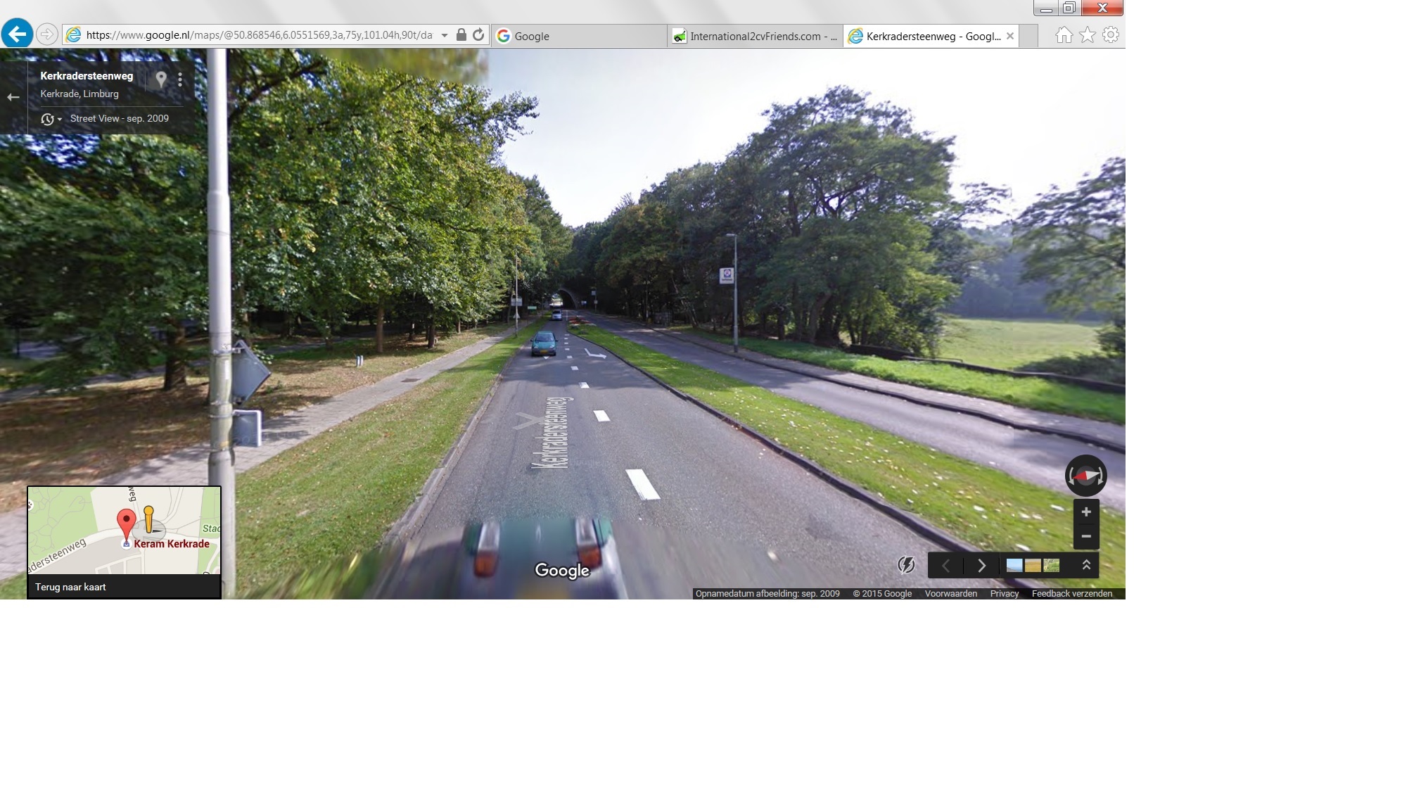

Ran the 57 without fuel today.... :oops: I did check the dipstick this morning. It showed 2 litres but on the way downhill coming out of the tunnel the engine stopped. Nose down the petrol runs forward away from the fuelline. I could push it just on the bicycle path and phoned home to bring the jerrycan .... :mrgreen:

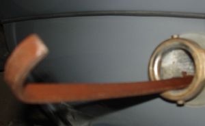

Here's the spot AZL57 means....

Yes had a lot of people looking... Dipstick is in the tank,
