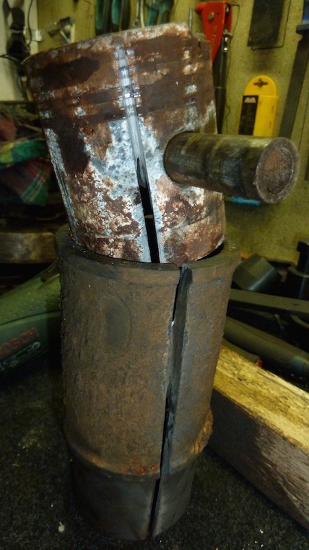

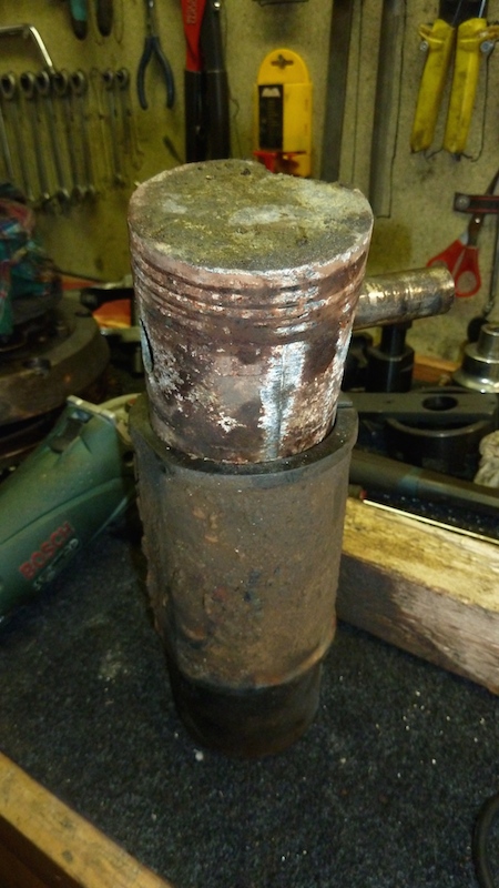

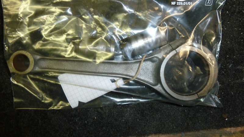

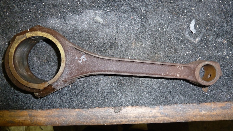

So I managed to get the pistons out of the sleeves today. I tried hammering them out but absolutely no movement.
So I just got the grinder out and cut them apart. I needed the con rods for the new piston set as new con rods are €75 a piece...
A little bit of micro bead blasting and they came up like new. Put them in a bag and sprayed loads of WD40 in to protect them while I wait for the engine.
