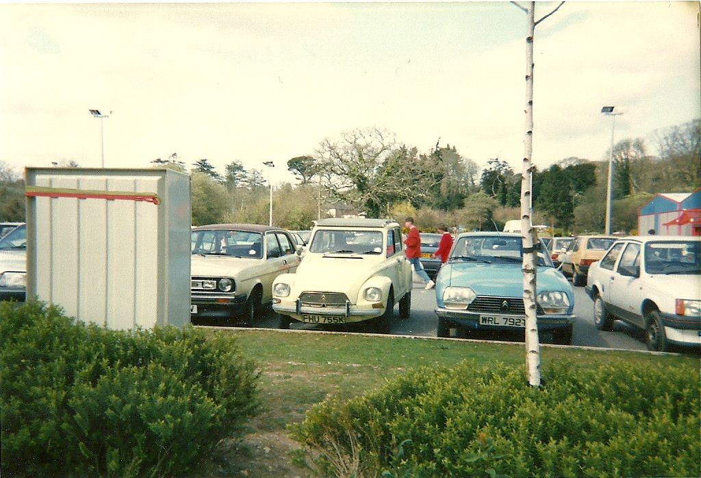

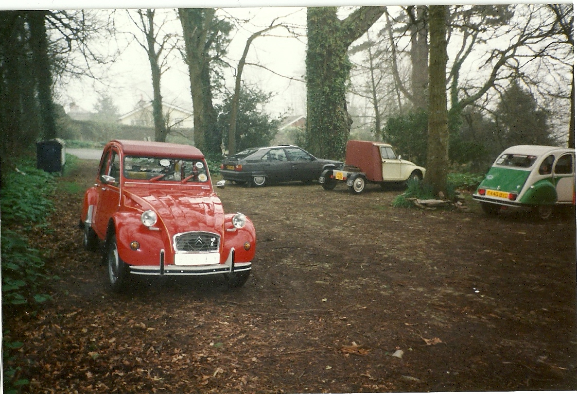

apologies for the thread hi-jack, Joolz.
Top photo shows FHU 755K - when i photographed it at St. Austell market in the summer of '89! check the GS with cornish 'plate beside it! 8-)
The bottom picture was taken at a Devon corndollies meet c1996? after Kevin converted it to a pick-up...

yup thats it :D does it still live ?

Not as you remember it I'm afraid. The reason I asked was purely because, when I had it, I used the engine, gearbox and (Ami Super) driveshafts in my Dyane. Sadly the rest of it had gone too far by that point :(
