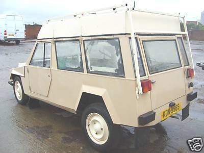

what is the white roof bit

Apparantly it hinges back on the rear frame, flips upside down and forms the base of a tent (which I have got but not tried yet) which clips onto poppers along the sides. Here's a pic that Neil sent me. Looks like a circus tent, but hey - if it works, why not?

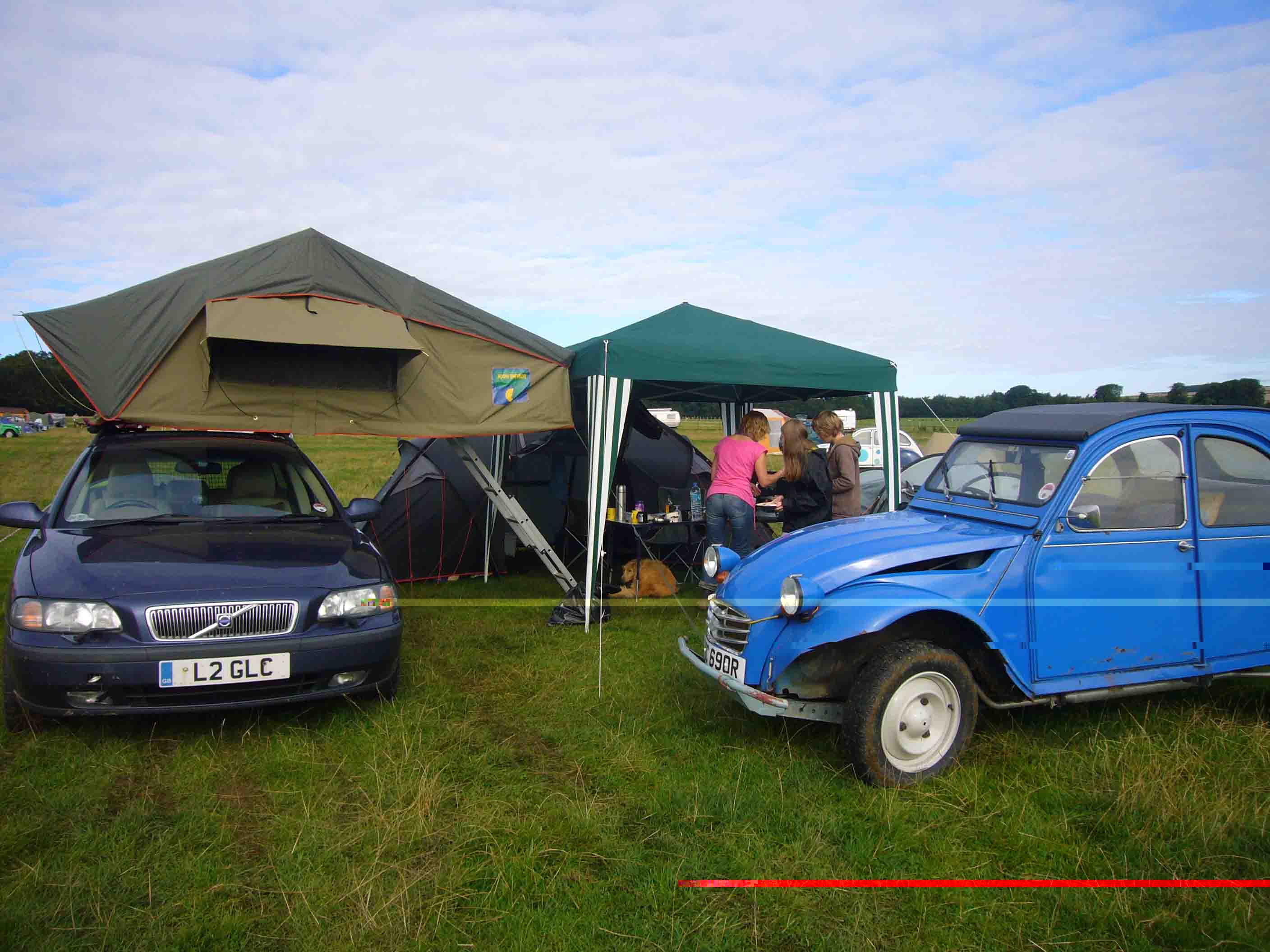

reminds me of my setup of tents at the national
