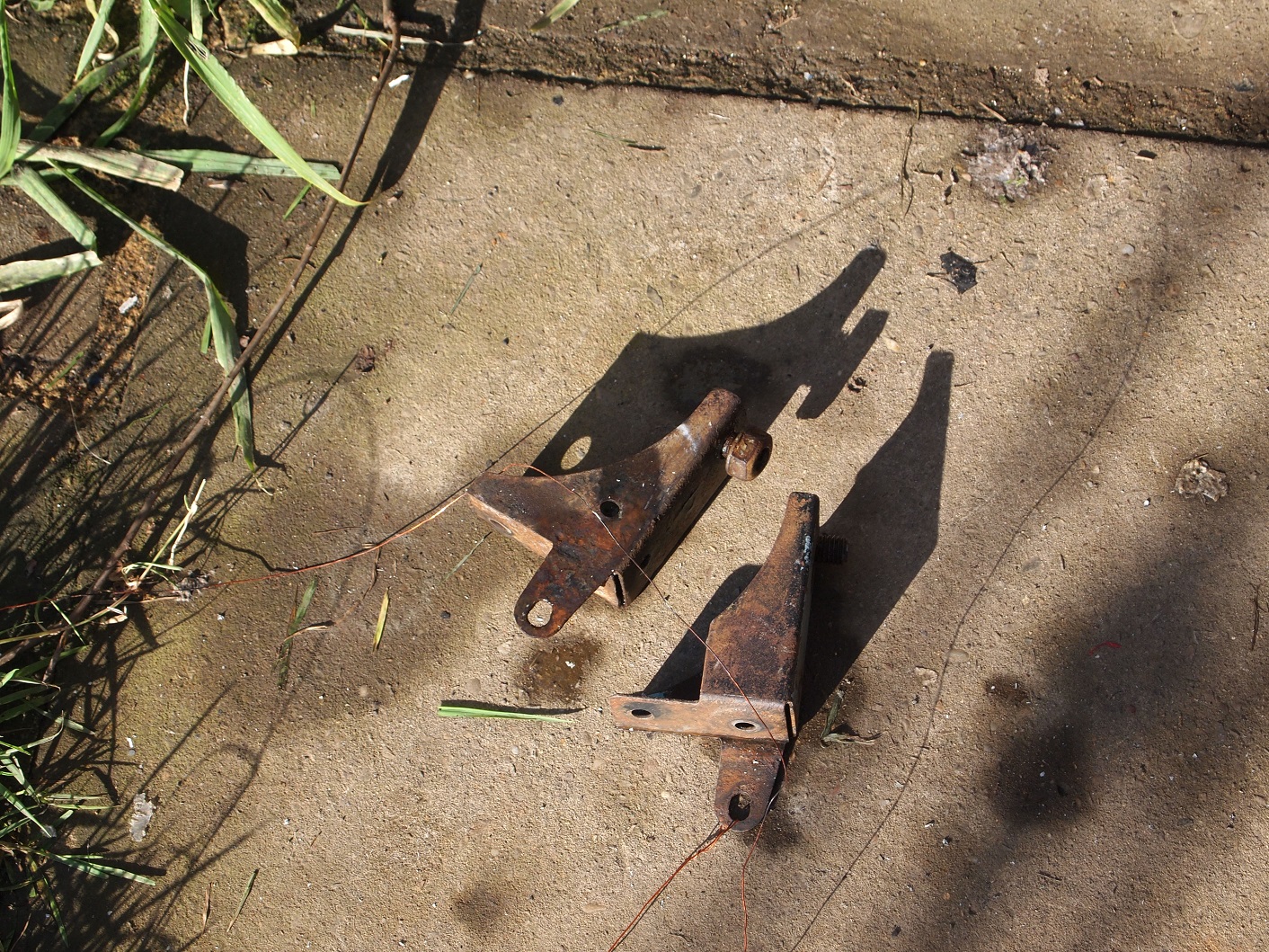

Fun with attempts to clean metal has been had; viz :
File comment: The one on the right has been in a strong washing soda solution for 5 days, the one on the left has been in Cocacola for 5 days, no effect really...

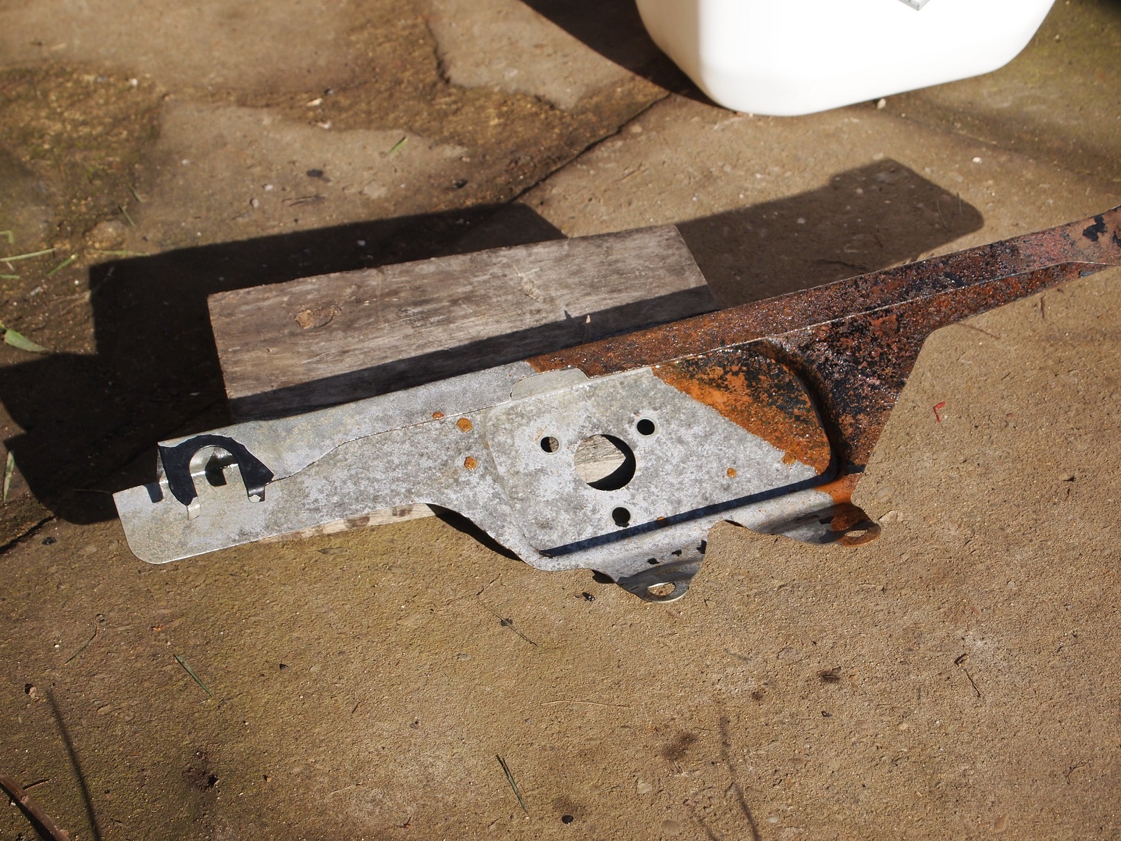

File comment: This has been in Patio cleaner over night... Much more the effect I was aiming @!
Much more the effect I was aiming @! Sadly bath not deep enought to get it all in one hit.

Rinsed off in water, then the strong soda solution, then water. Now we see if it has all disapeared by tomorrow...

That's interesting. I have an ice cream tub of nuts, bolts and small things that've come off my 2cv, do you reckon Cementone would sort it all out and leave it as good as new?
