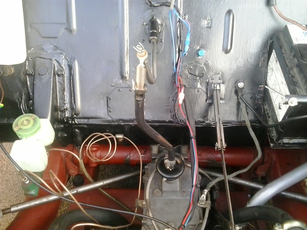

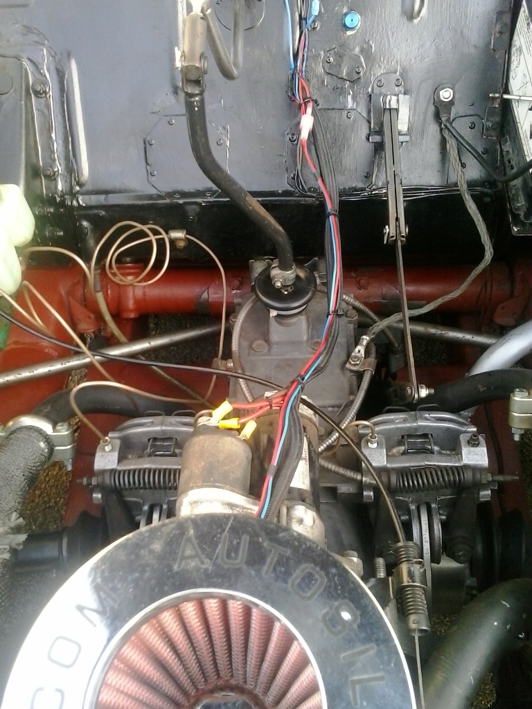

engine bay tidied up

I think I'd move that P clip on the brake pipe to the other side of the coil. The master cylinder and chassis aren't (hopefully!) going to move in relation to the bulkhead, but you do need the coil to cope with the movement between the gearbox and everything else!
