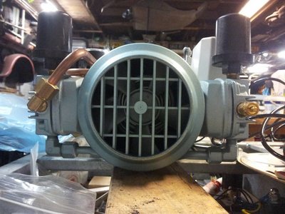

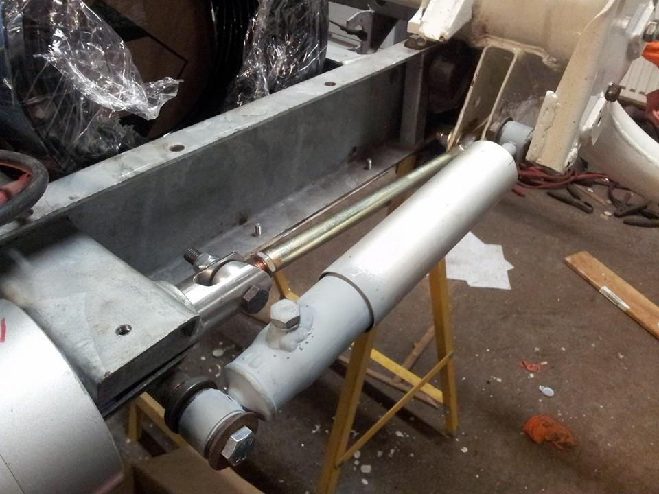

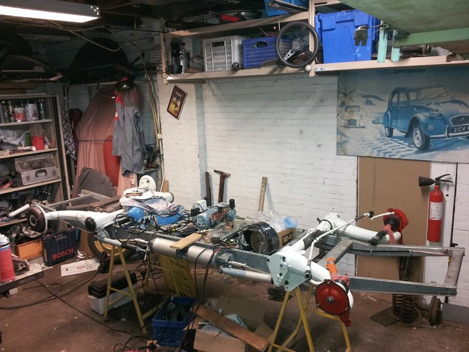

Some older pictures.
Hydraulics and pneumatics are basically working now.
Now working on modifications to get everything else fitted again.
File comment: 2 cylinder boxer air power, not sure if i'll use this one, because of the weight.

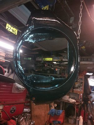

modified the cooling tunnel to be able to mount the engine 24mm lower in chassis
April 10th, 2014, 1:42 pm

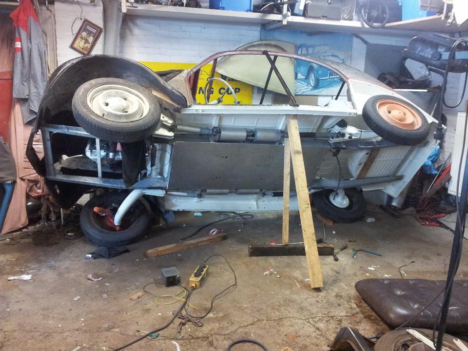

Flipped it over to trial and fit seat belt mounting and suspension end stop frame, still possible for 1 person to achieve.
Flipped it back on it's wheels for final fitting and tack welding.

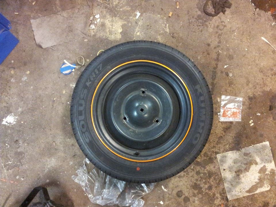

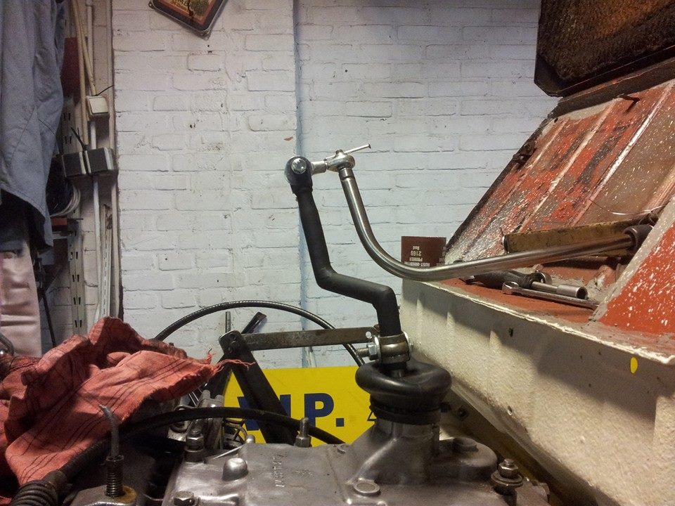

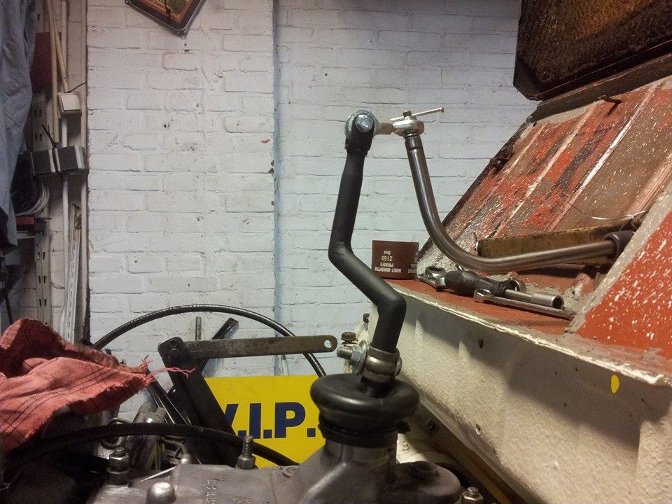

Fiddling with the gearchange and handbrake, handbrake assembly is moved to the other side of the gearbox.
And did a bit of playing with the wheels, the tape was very helpful in hiding the damage on the rims ;)
May 7th, 2014, 9:43 am
