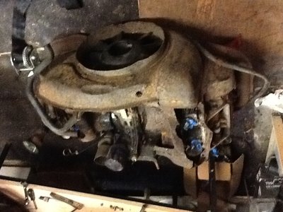

im not running anything at the moment haha, engine is hanging around like this:
i will add the supercharger when i rebuild the engine again, im going to put some larger cilinders on it, other camshafts, and lots of flowing of the housing and such. only it will cost pretty much to do al that, so most things i will do after the world meeting in spain,

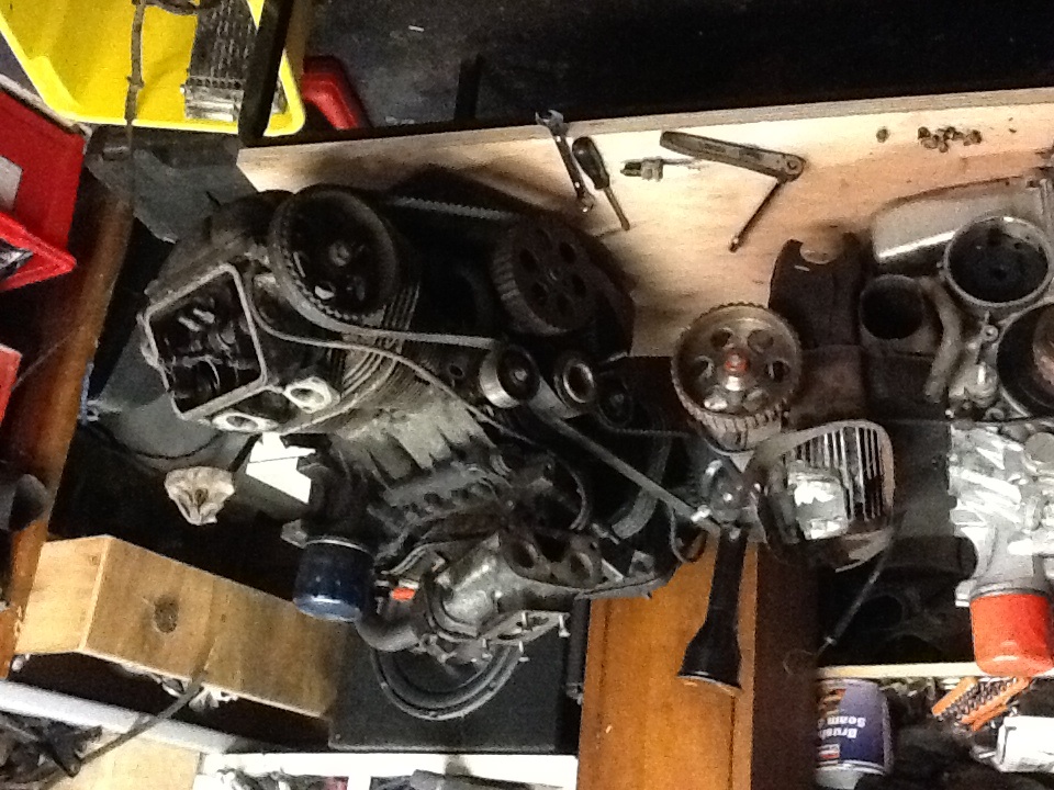

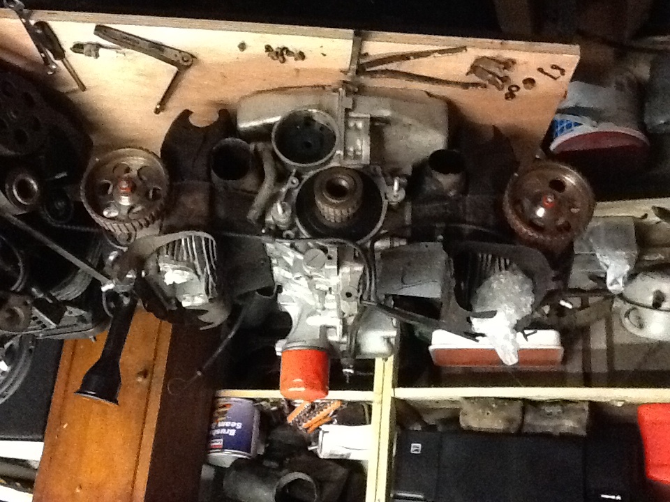

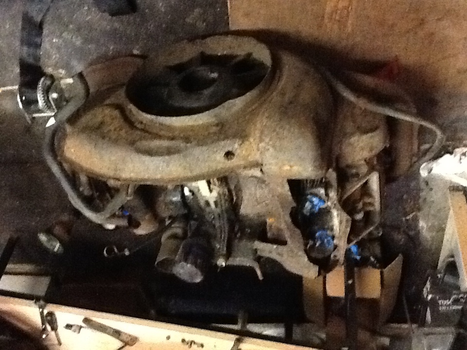

Snap got one in the same state well 3 now!!!

the one on the last picture looks pretty good already, i need to take mine appart, and let all the rotating parts be balanced, and then the housing sandblasted. head's revised, but need to relocate the oil filte, and alternator i want the supercharger in the middle of the engine
