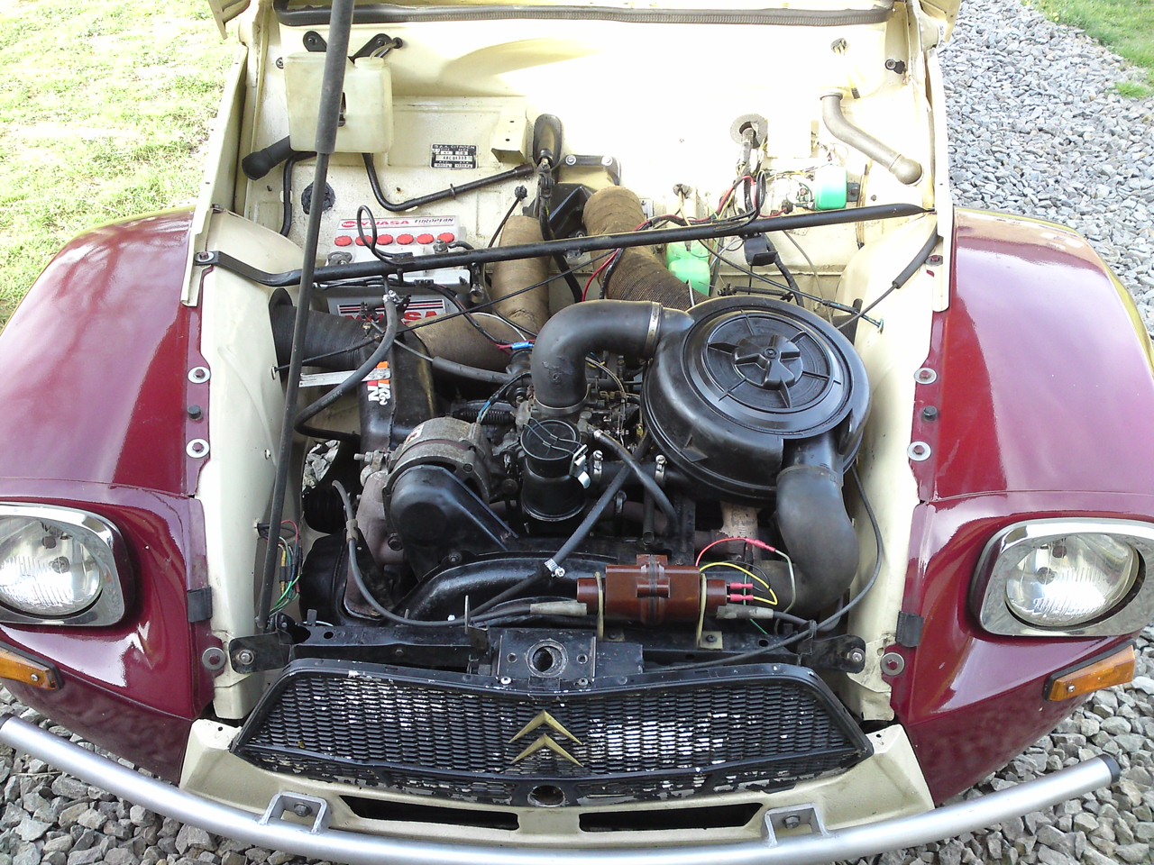

Original engine took me all over the place and old Dyane took me to Italy etc. This Visa engine looked fine on the inside and outside but the ignition left me down all the time - 2 sensors went and 1 computer. They are like gold dust to find so fitted 123 ignition. Also ran it first with standard carb but would only run properly with big filter and etc. Changed to 2 amals and worked hard to set mixture correct - many parcels from Uk with different jets. But now ( my theory please shoot me down if wrong) is that the pistons are forming the crank case to pressurize (New breather fitted) and all hell breaks loose with oil bleeding at highish rpm. Cannot have unrealiable car.
March 22nd, 2012, 6:44 pm
Post Re: 1976 Dyane 6.52
Ah well back to Dyane 6 now. It was lovely to turn the key after putting the plugs back in (turned over first to get oil pressure up ) and it started first time. Even gone backwards in power with 8.5 : 1 pistons so can run on cheaper petrol ( long tour coming in October ). Maybe I will put the Amals on this engine but just be glad to have reliable engine again.
