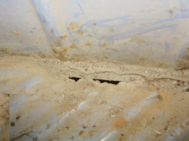

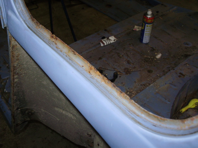

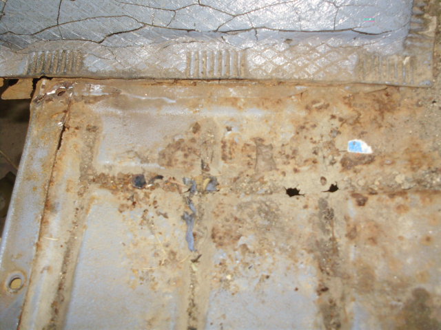

Time to decide what to do. All this rust is nothing new. No short cuts, all new panels all around. Some could be repaired but RUST NEVER SLEEP. To avoid trouble down the track, everything will be changed.
File comment: Triangle window frame
File comment: Triangle rear window frame
File comment: Inner rear mudguard right
File comment: Rear number plate panel
File comment: Boot floor
File comment: Windscreen panel
File comment: Both floors f.....
File comment: Lower firewall
File comment: Outside lower left corner
The old chassis is buggered and will be used as work bench, lining up the body panels. Danger is that the body will sink a fraction, when front lower firewall and floors are removed. More photos later.

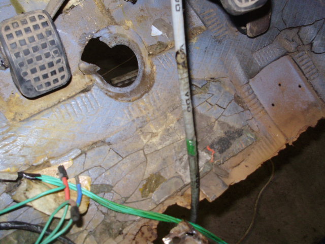

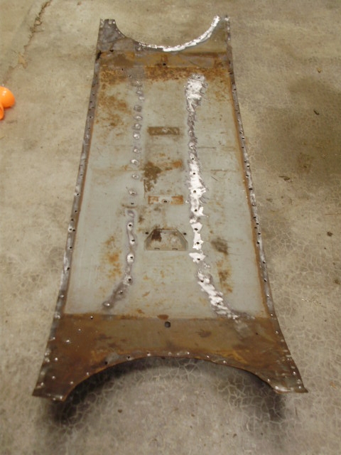

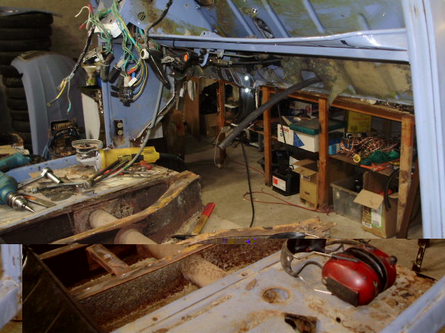

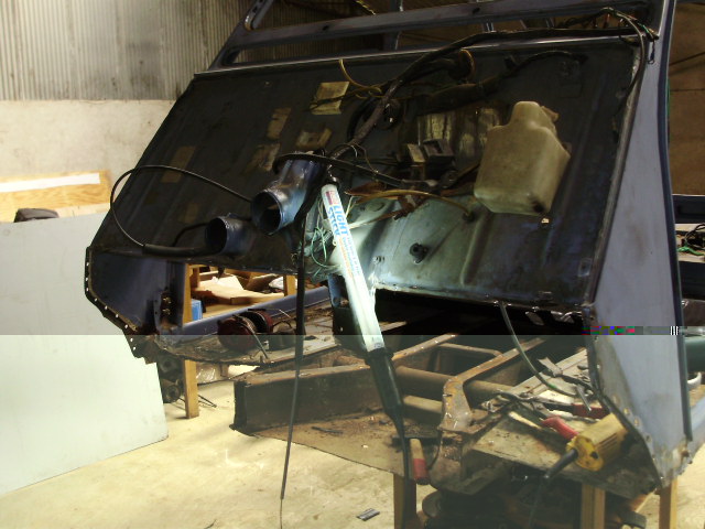

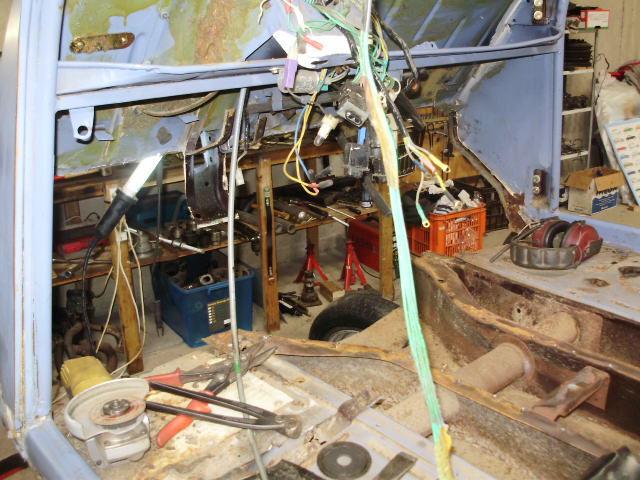

First panel to disappear is the lower firewall (pedal floor). It took 2 hours to completely remove the panel and prepare the new panel to go in.
All factory spot weldings are drilled out using a small step drill making new holes to weld in at the same time. Luckily all edges are still solid except the front of the sills which are rotten. Can’t remove the sills as the front door post is support the front of the body. Later when the new lower firewall is in together with a set of new floors, the sills can be worked on.
Saved the top chassis plate to keep as a templete for future jobs.
