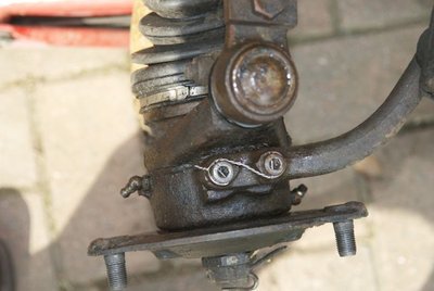

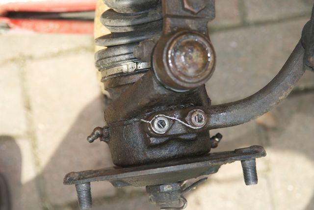

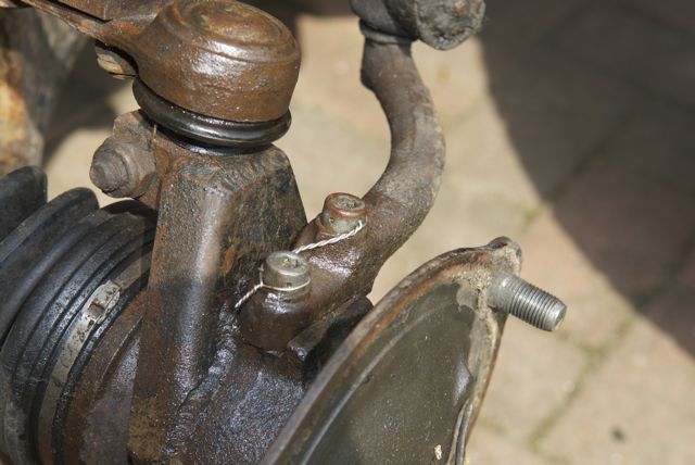

to make it really secure, wire the bolts

pete will have lock bar made from 2 allen keys fitted as locker.

Like the idea, of "lock-bar", pictures?
