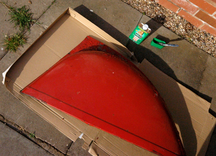

1 can of Nitromors + an old brush + v thick rubber gloves:

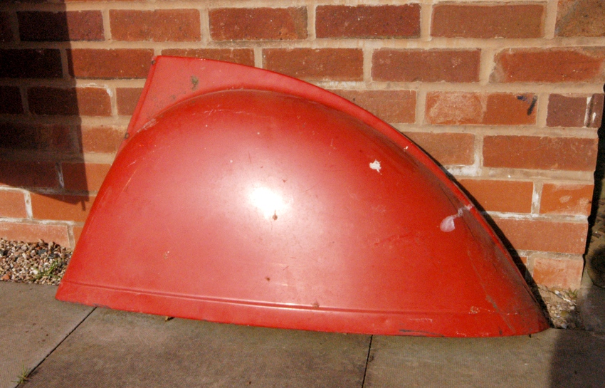

1 D0lly wing, in good condition:
To save on a crappy clearing up job after (and getting moaned at) I did the job over an old box, to collect the old paint:

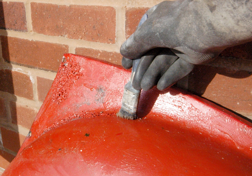

Applied Nitromors in jabbing motion, working on smallish area (30cmx30cm) at a time. After doing the first area, applied some to another 30x30 area, then another and so on...
After the first area had had 5 mins for the Nitromors to start blistering, I jabbed some more into the paint and left it for another 5 mins or so. THEN I get a course metal scourer (actually a metal dish scourer, bought from Lidl) and simply scrubbed. Where paint didn't come off, I just jabbed some more Nitromors on and left that bit alone for 5 mins. Meanwhile, I scrubbed away at the bits that were keen to come off. Didn't use any water whilst scrubbing, but if the Nitromors dried out, I just jabbed a bit more onto the paint.

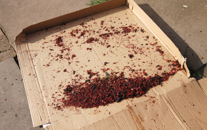

After 10 mins of scrubbing, my old box was full of this:

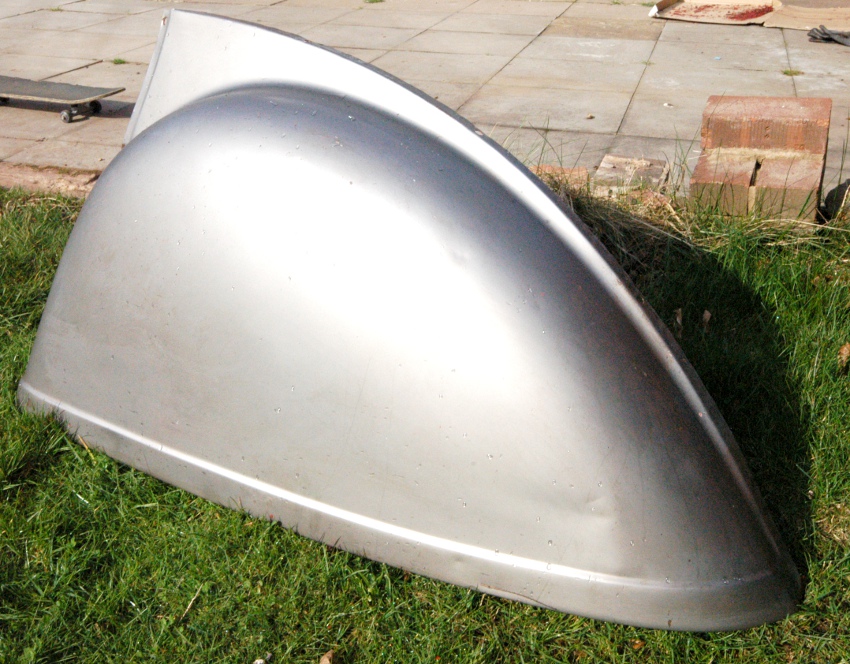

... and after I'd chucked a bucket of water over the wing to remove the last bits of crud, my wing looked like this:
Result! No deep gouges or blemishes to deal with before painting, other than the odd ding picked up by the wing in its previous life, of course.
Time taken for job: 45 leisurely minutes.
