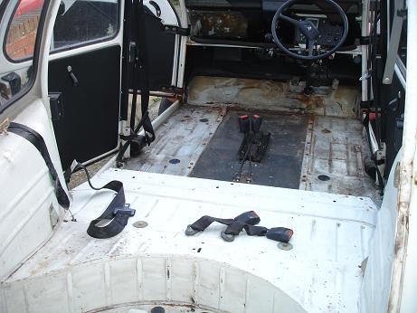

Dilemma number 2 – Chassis (oh dear ….here we go !)….its on its original. Frankly from what you can see, its looking like a good original chassis. All I can find is a bit or rust about the size of a 50p piece. The seams all good, the arms good….everything looks great from the outside. However I happen to have a brand new, unused Galvi chassis and the outer bulkhead has gone and I want to take off the body shell and make sure all is good underneath. Thing is my original Jade has a rubbish chassis and so my thoughts are to put this Red and White on the new Galvi and check over the chassis I take off to put on the Jade.

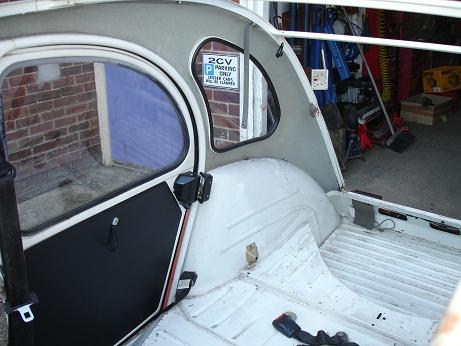

ANYWAY…..got the seats out, roof off and started to have a prod and look around. This is actually quite an amazing car. There is rust in the front floors, and where water has sat its gone through the toe board and the outer bulkhead has dropped away. However the rest of it isn’t too bad. Sills are amazingly good, rear seat belt mounts are superb, some very good bits here on this car. All four doors are excellent, bonnet too. Work to be done, but finally having looked over it and got it in the garage I am now feeling pleased….even excited!
Actually I am rather appreciating the fact that this car has never, ever, been molested or touched at all from new. No bodges, nothing to “undo”, just a real true honest car that needs and deserves to be brought back into life. This is a once in a lifetime chance for me to really enjoy bringing this up to a good standard. I hope I can do it justice.

If you put the R/W chassis on the Jade you'd have the hassle of changing vin number with the DVLA. Or would you bother. Either way your Jade would then not be original.
Seems a shame to part a good chassis from essentially, a good body. If twere me I'd try and keep both original, but it's a tough decision. Toss a coin :D

If I was having my car resprayed tomorrow, I'd certainly look at having it done in one of the early shades(Old-Nail's car has definitely influenced me there). When you remove the shell, give the chassis a good going over and if possible, retain it (an original Citroen chassis is far and away more superior than a galv. chassis, if you're wanting to retain the legendary 2CV ride and handling).
In reference to chassis numbers, only early cars had the chassis plate on the chassis, late cars have it on the bulk head/fire wall.

My thoughts on where you are at. If the chassis is definitely good after checking with the body off then re-use it and save the galvy one for your jade rebuild. I take it this won't be a cheque-book build, which means restoring a lot of old parts to re-use. In which case one or all of the cars are likely to become contributors, if not donors, to get at the best bits.
The more restoration work you do, the less money you spend (but you still spend a lot) conversely the more money you spend the less time it takes.
Make the decision about colour now. The reason being if you have a clear picture of what you want to achieve from the outset it gives you something to work towards. Also, when the car is fully dismantled is the time to start painting gear lever tubes, door hinges, dash panel, bonnet and boot props, all the little things that seem insignificant at the time. If they're not being black you need to know. Store them away ready for refitting, they come together to make a big detail difference later.

I agree totally with the comments above - keep the original chassis if at all practicable. Once the body is off, you can clean it up, repair it and then fully protect it from future decay.
