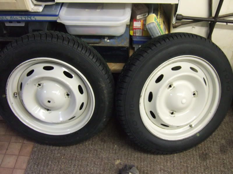

not much to report, at least picture wise, but i now have 5 super slots clad in 135 toyos, they'll be fitted sometime!

Beautiful car! those super slots are going to look a treat on it!

cheers, Joe! it should look half tidy with those rims on & a healthy suspension drop! ;)

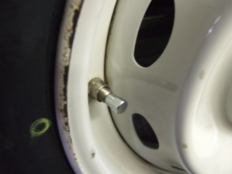

neil... did you get them from mytyres?
or do all the toyos have them yellow rings?
they look great btw! and i agree with louis, it looks good without the bumper!

yep. mytyre all the way! last time i ordered a set a couple of years back i had change from a hundred quid!
line the yellow rings up with your valves - it's supposedly the *lightest* point on the tyre, Joe. Bumper is re-instated, sorry chaps!

:o ahhhh bummer... wish i knew that yesterday when they were being fitted...
will err... sort that out :)

how much it actually matters, i'm not sure...
http://www.toyojapan.com/tires/pdf/TTT_13.pdf

well at first, i thought mine felt abit wobbly... but down the dually at 70+ last night, didnt really feel anything different...

Neil, I've just noticed that you've re-fitted the retaining nuts on the valves upside down! :ugeek:
