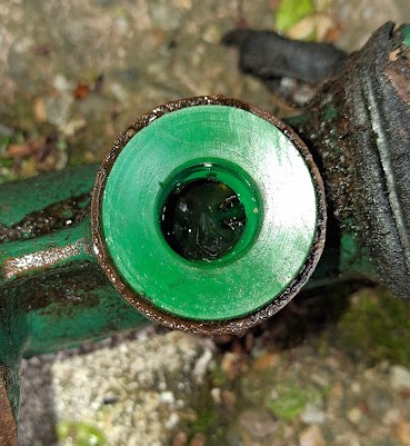

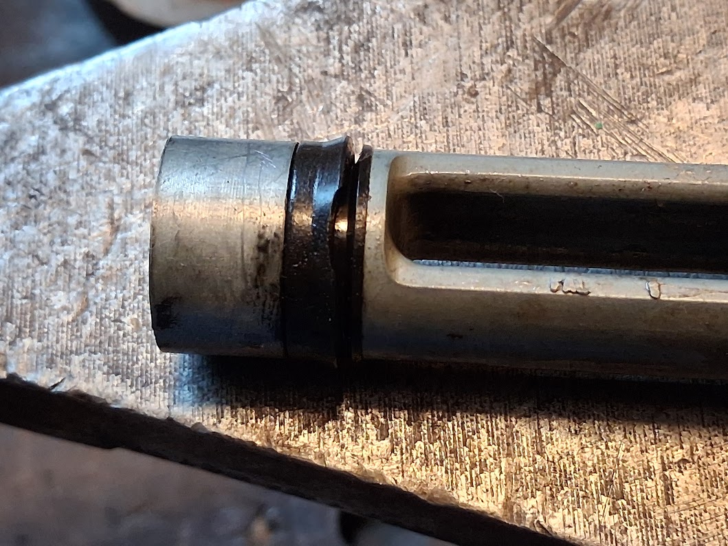

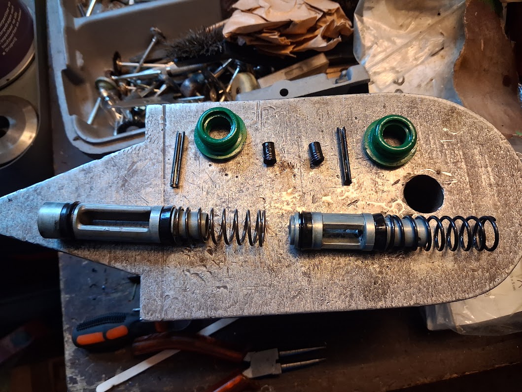

[url][/url]Replaced a blocking master brake cylinder in a friends 2cv6.
Took it apart today. It was filled with a lot of black sludge. The rear rubber was rather desintegrated. I think someone dit fill up with DOT braking fluid instead of LHM once???

possible ? :shock:
May 14th, 2026, 7:01 am
Posts: 2303
Post Re: AZL 1957
yes i have seen that before.
