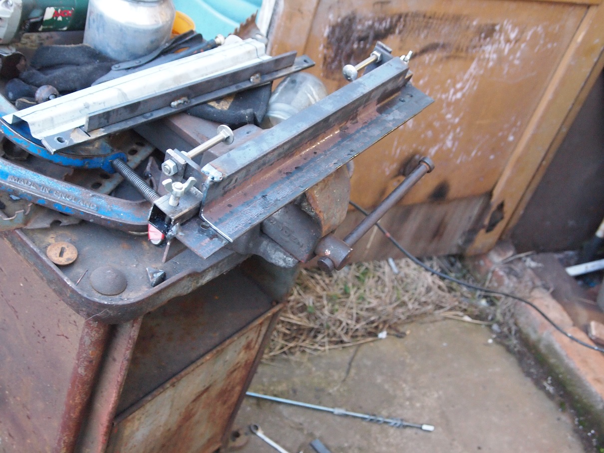

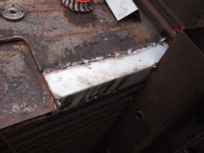

File comment: Being a cheapskate, set about making some bits to make bits...

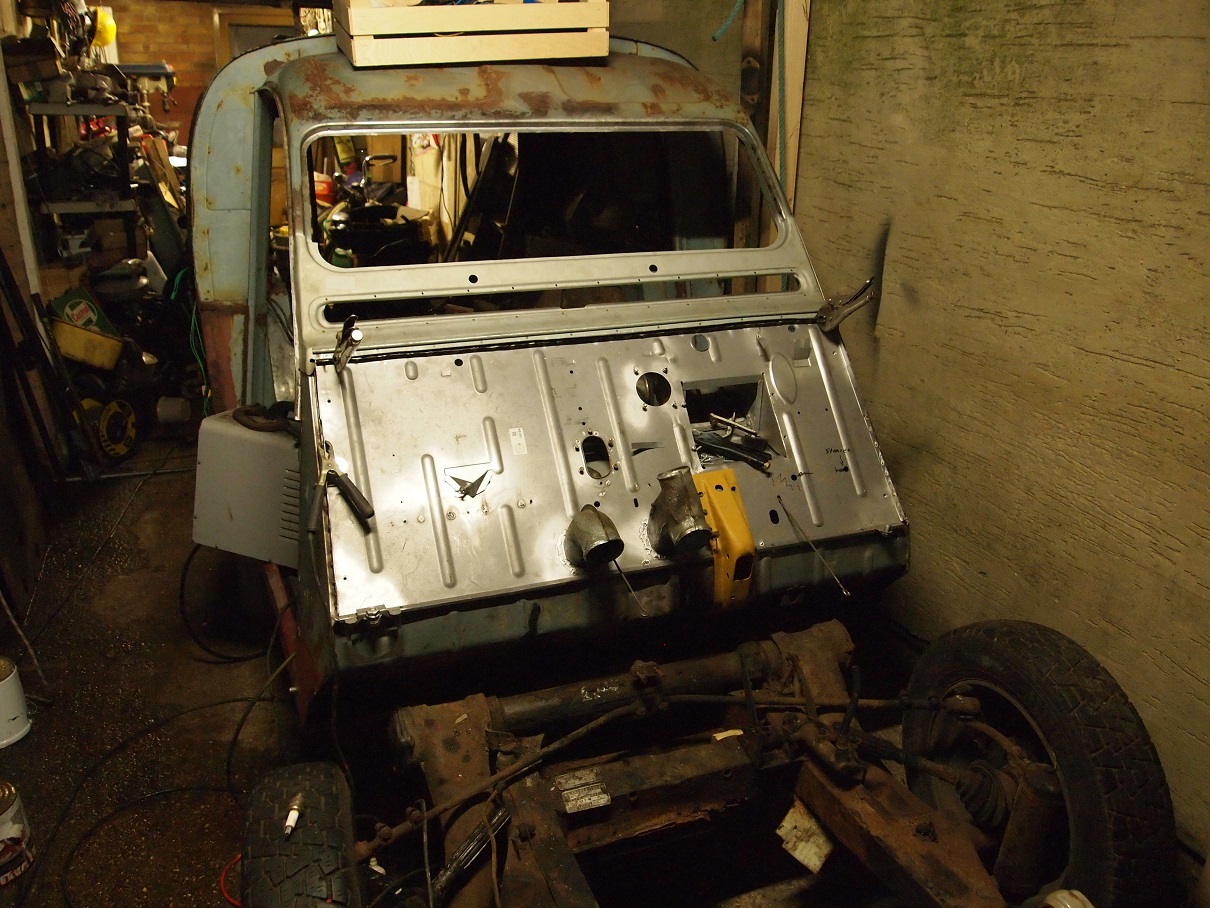

File comment: Bulkhead done, now for the back end...

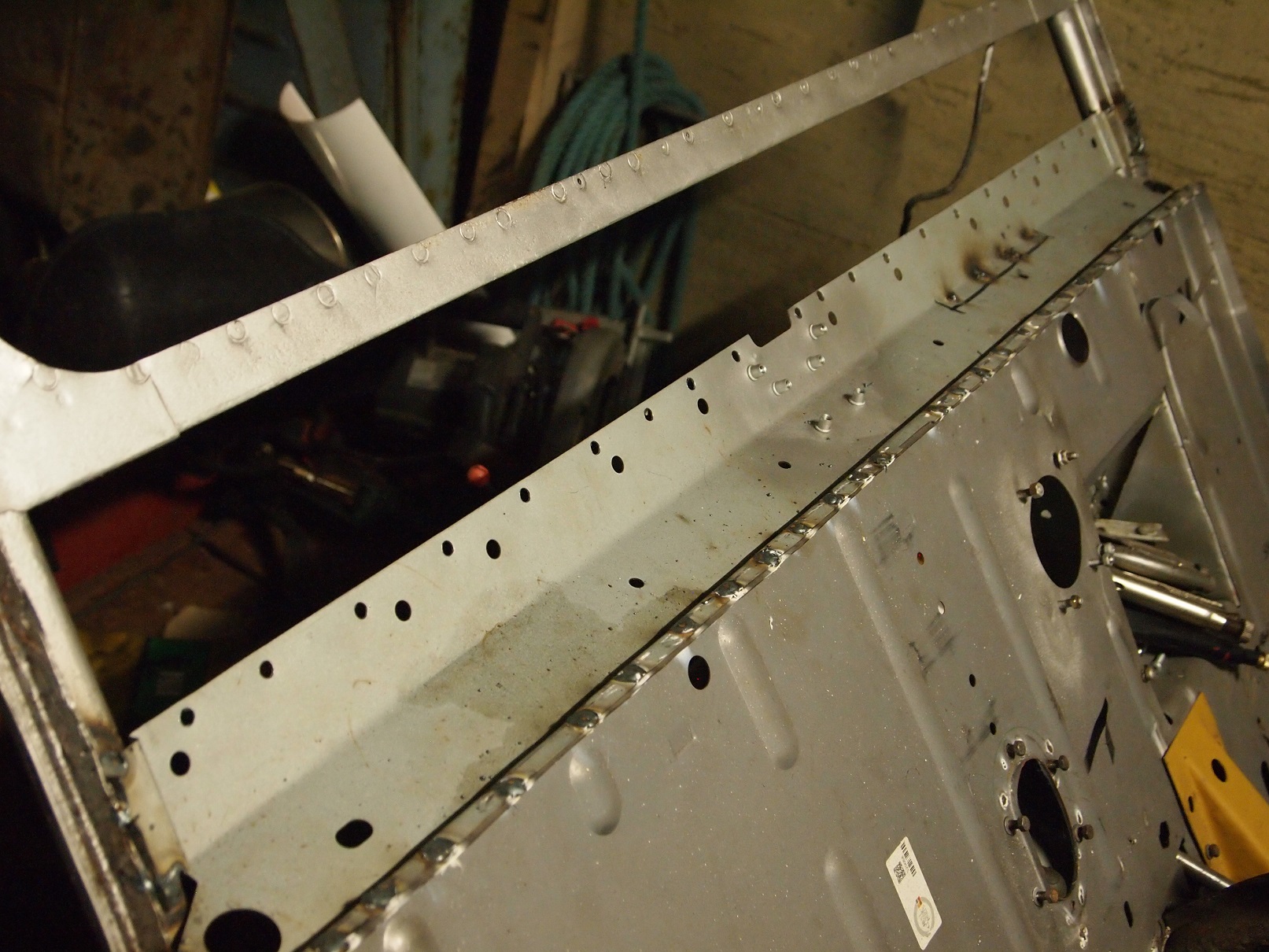

Looking back down this post the last pics show the main bulkhead panel in, a bit more happened before the work stopped. The vent/lower windscreen area got replaced..

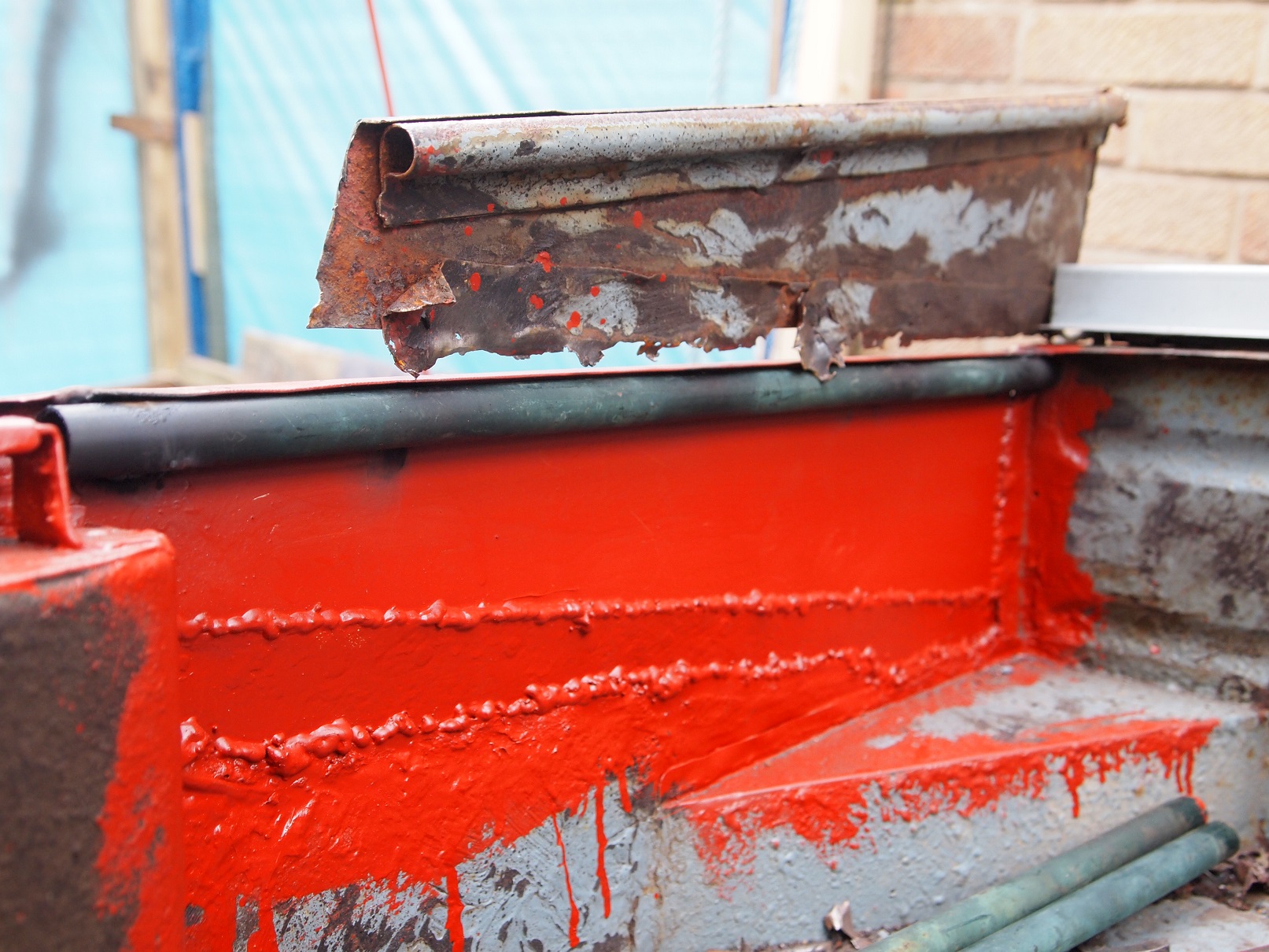

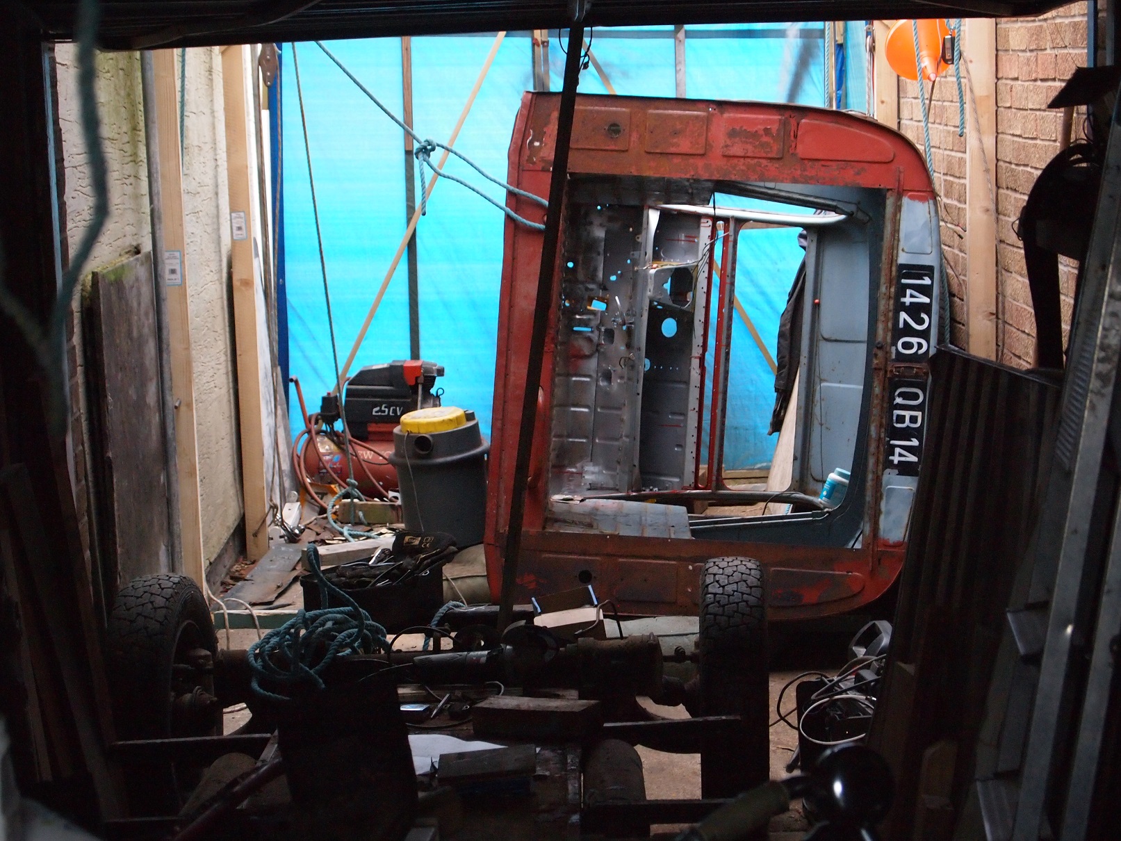

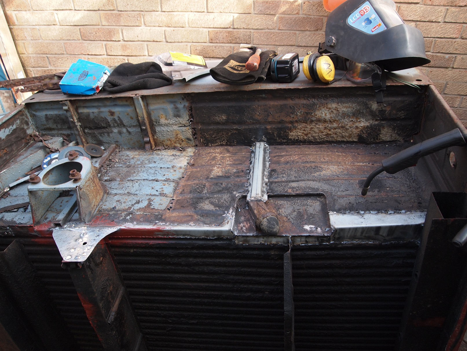

I knew the van body needed some work; the waist rails were missing, the inner wings were a bit lacy, the rail above the rear doors had fractured in the middle, a more detailed inspection of the body commenced :?

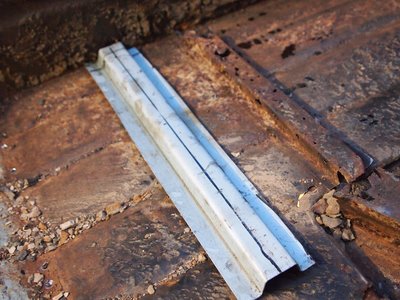

Not so good. I'd hoped to be able to patch most of it, the cab floor for e.g. these were new panels, as were the cills but on cleaning them up they were rotten - same reason as the bulkhead; sat there full of water...
Happily the cills are galv so they are fine.

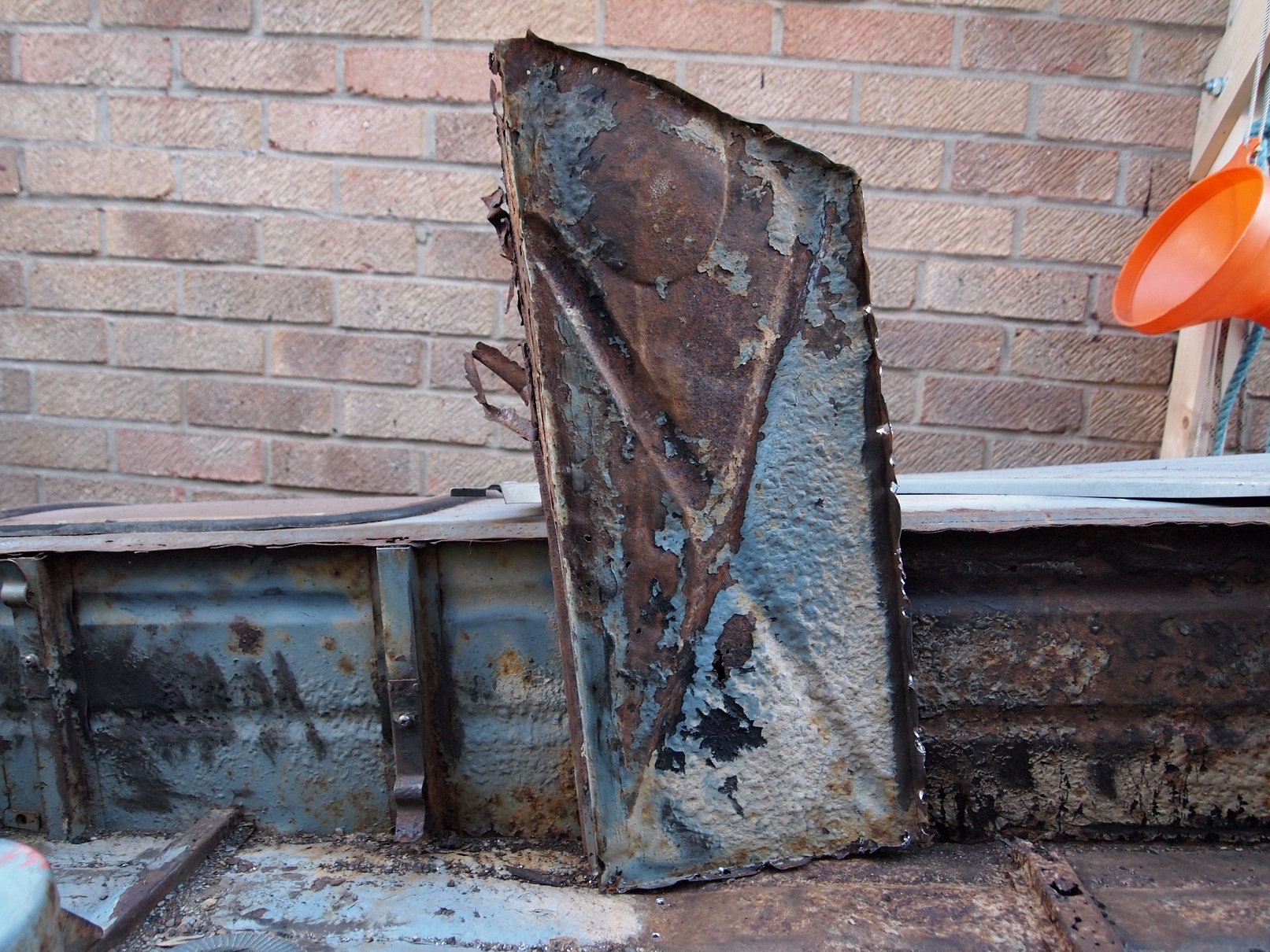

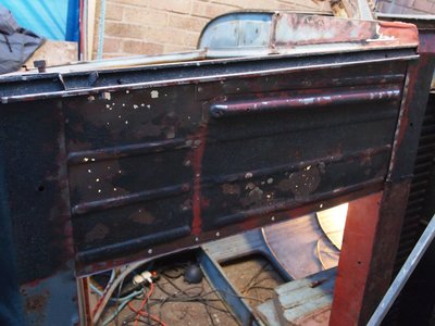

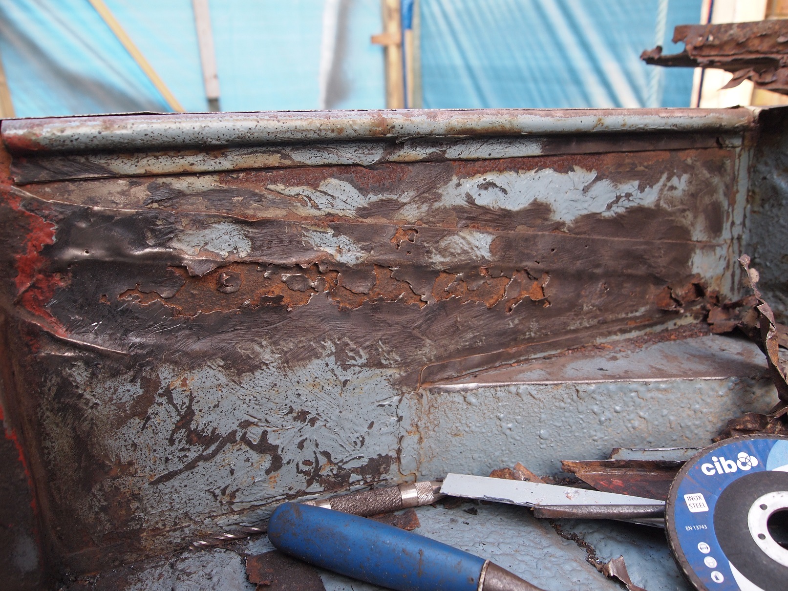

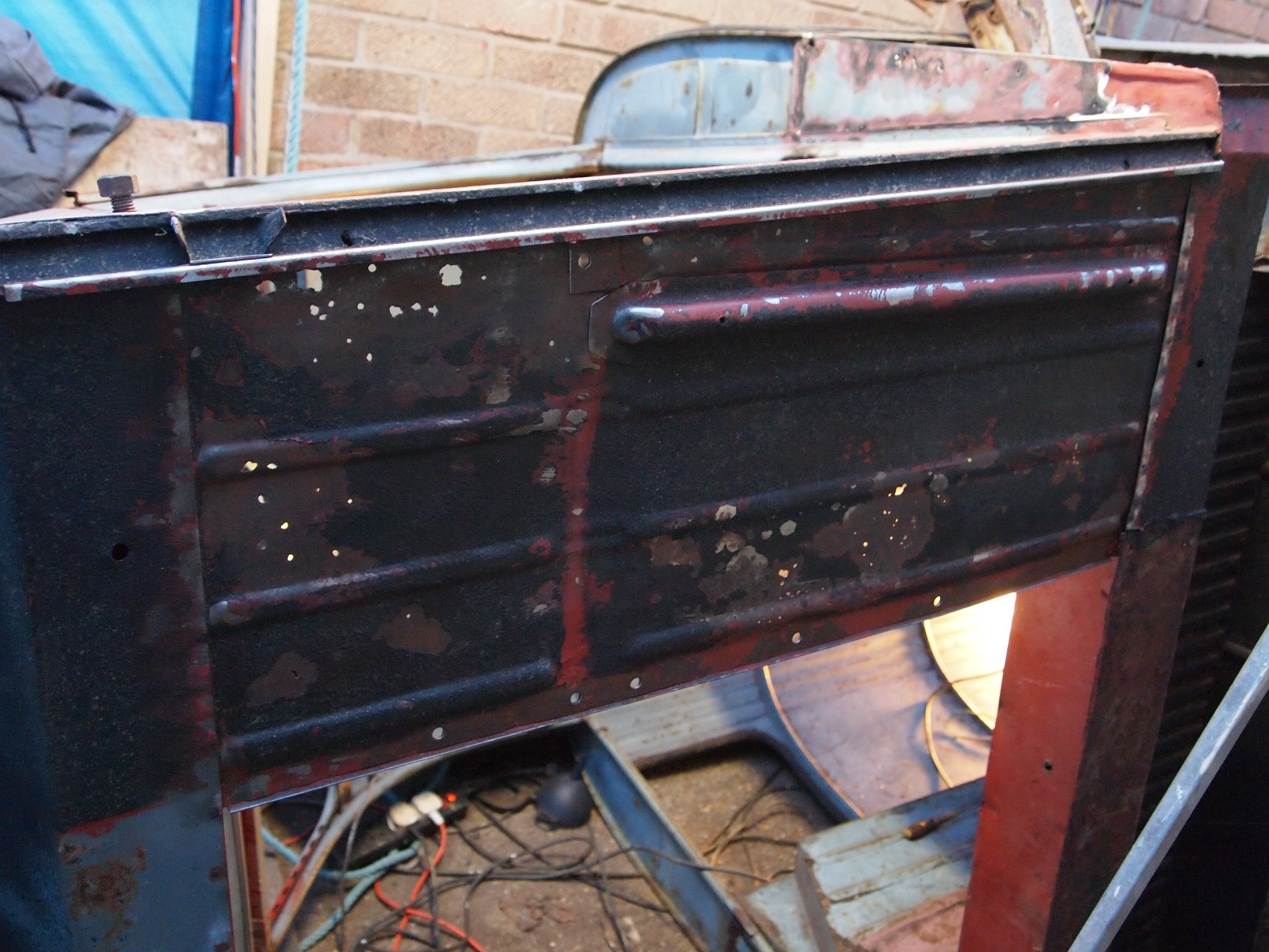

The panel behind the passenger doors from the waist down, which forms the front of the tank and spare wheel bays, is a bit of a sandwich and water and damage had rather trashed both sides.
So they got replaced, some old galv tent pole of the right dia. got pressed into service as the rolled outer edge.
