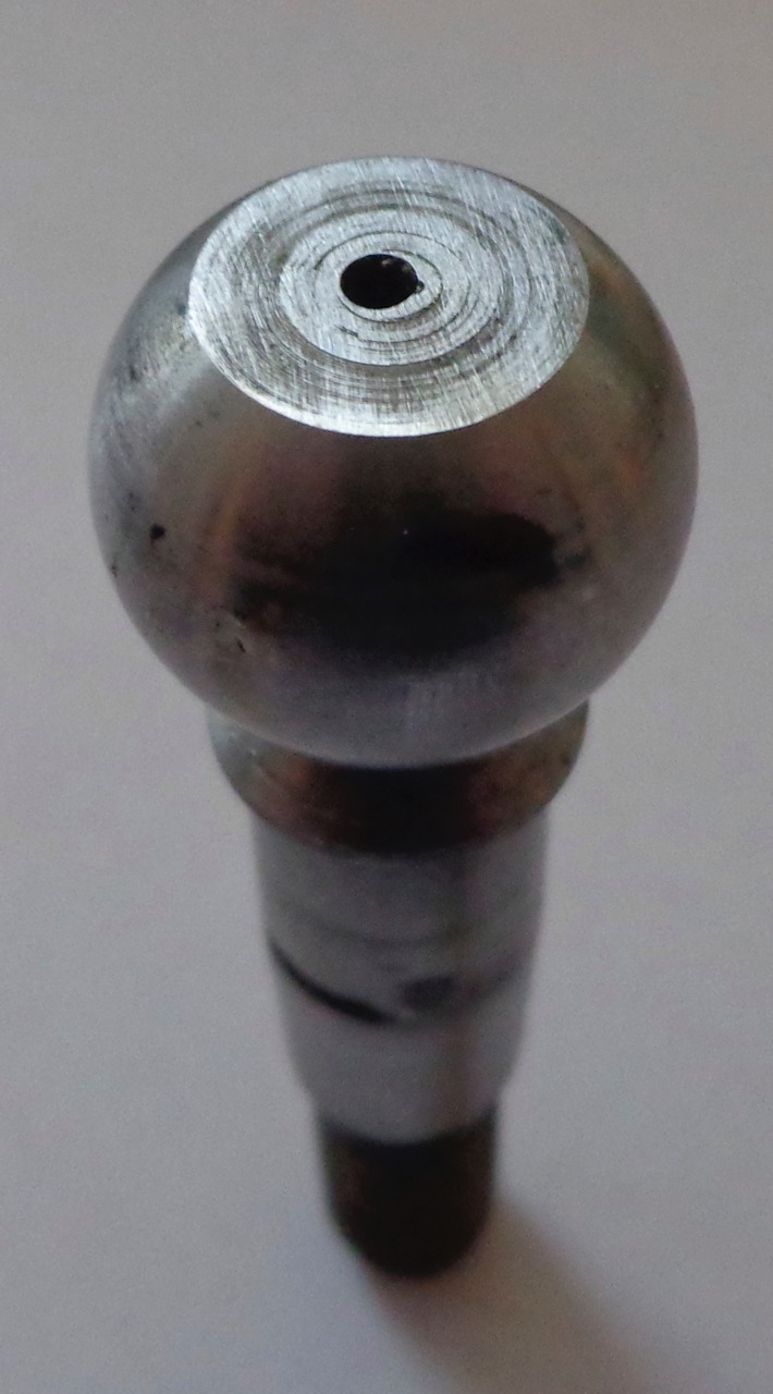

That's a good idea. I wondered about fitting nipples there too, but the old ones I took out had barely any wear on them, presumably because they're only subjected to a very limited range of movement, as opposed to to steering arms for example. Also I couldn't work out an easy way of drilling them through without having to deal with the existing hole for the split pin. I like your solution though, might steal it when I do the rack on dad's car.
July 7th, 2016, 10:19 pm
Posts: 2251
Post Re: Albert the AKS400
Agreed the inner ball-pins, don't wear that much, but the guide ring does.
By greasing through the ball-pin, the surplus grease spills out and lubes the slide at the front.
Have also a small hole at the back so the guide ring gets grease as well.
Did mine in a lathe with a carbide drill(S)!, takes a lot of time, just drill 1mm at a go and back the drill out...
Also newer knuckles are not as hard.
