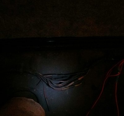

Cleaned up some of the wiring today which seems to have helped with the charging issues. I'm seeing a maximum of 14.7v now, which is an improvement over the 15/15.1 from before.
While I was on, I found a couple of bits of wiring that looked strange.

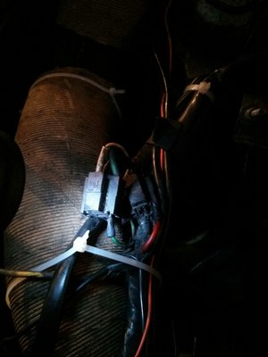

Is this where a dim dip setup used to be? That red bullet that's hanging on the bulkhead doesn't have anything on the "other" side to connect to.

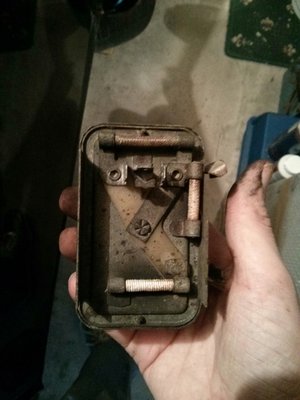

Also, the voltage regulator I have seems to be an older style to what I've seen - do I need to do any maintenance here?

Sorry Adam, no one seems to have answered your queries, you've probably worked it out for yourself now. But if not, the first picture does indeed look like the sockets for the dim-dip relays, although I wouldn't have expected an '85 car to have had it fitted.
The red connector you mention would have been for the brake lights, but if they're working then I guess someone must have run another wire to them.

Post Re: 1985 Black Spécial
the socket if it is near the firewall will be for the voltage regulator. no dip-dim relays on a 2cv.

On UK 2CVs (RHD), dim-dip was fitted from about 1987 onwards and even if this is a 1985 car, it's not unknown for wiring looms to have been replaced... ;)

Thanks, I did manage to find a picture later on. There are a couple of bits of evidence that there has been some wiring damage at some point, so explains the later front loom.
