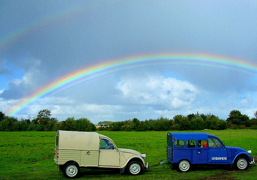

In the photo, apart from the windows, are the 2 vans the same type? I thought the blue one looked longer, or is that just because it's got windows giving it a false appearance of length or is it a low roof 400?

Both vans in the pic are the same length. The beige one is a mid-70s AZU250, and the front one is from the early 60s. I don't know so much about earlier vans, but I guess it's an AU.

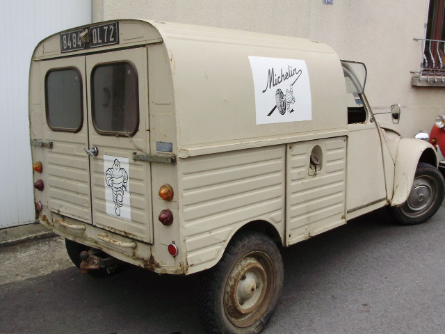

:o
Wide ripples, big spring pots, club dash, 602, rectangular lights the list is endless.

That's an AZU250 (to be precise, a post-1972 AZU250 GA *I think*). When new it would have been 435cc.

No you are very wrong. It is a 1974 original AK 250 :mrgreen:
There's no such thing. Certainly not for the French market.
