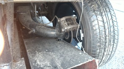

Here you go, its a pain in the ass doing this on my phone.. This evening more..
Gs Bx Xantia C5 all will do..

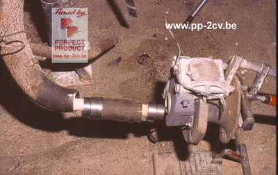

One solution from Finland. GS wheel hubs/discs, Xantia calipers...
AZL57 wrote:
Would GS rear discs fit on 2cv arms?
Yes, some little metalwork needed, the axle shaft is same diameter etc...

Received this from Belguim :)
