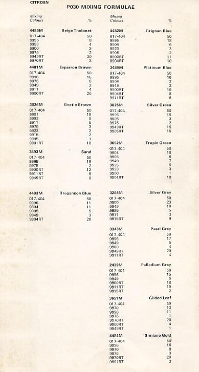

May help...

Thanks again.
Taskos, the matchcolour app looks good but I will need to get a friend to load it as I am using Apple/iphone!

Thanks Rustman and Taskos
I will see if I can get some samples mixed if they can find the formulae.
