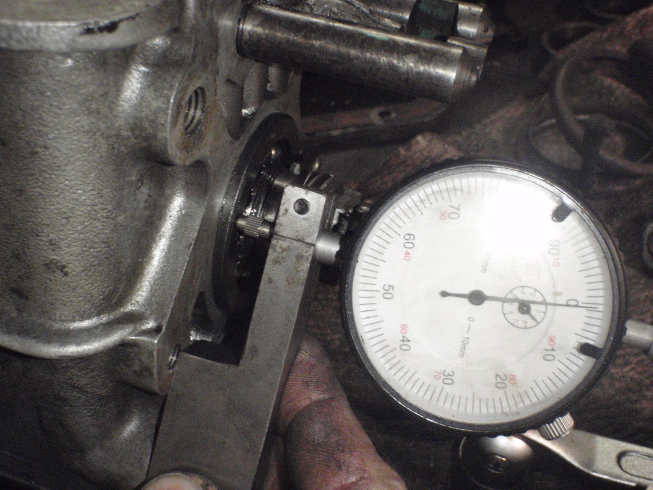

Rear covers on modern gear boxes are machined not to have any shims, whereas earlier boxes need shims
