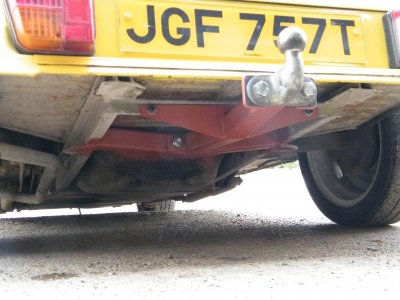

Which chassis do you have? I recently made one for my car, but I also happened upon one that I removed from the car some years ago. There's not much measuring required, a couple of crossbars to each chassis leg and a single central spine for the towbar.

Id bolts bits on to get an idea for support, and tac weld as you go, then remove for proper welds

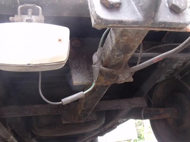

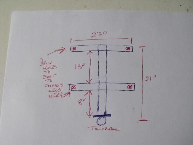

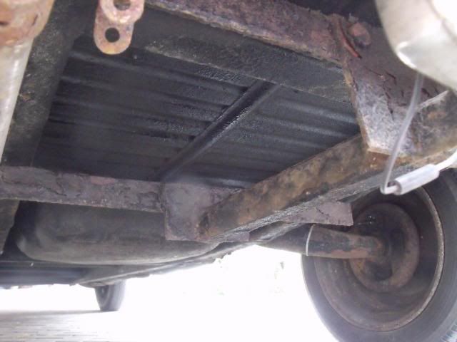

Pics speak louder than words ....
"Witter" towbar,fitted to an [early] non-galvanised SLC Chassis.
Dimensions .....[in inches ....sorry,I dont do "Euros"]
Looks like this when bolted to the car.
:shock: OMG ......I had'nt realised that the underside of my car was so rusty & crusty .... :oops:
And yeah .....I know I'm a cr@p artist,and an even worse photographer,so if anyone can do better,please feel free to have a go y'self .... :P
hth

Thanks mate!!
having worked from sketches on the back of ciggy packets for 30 odd years, yours is a Rembrant!
Thats all the info i will need.
thanks again, just got to find some shiney stainless steel in work now to knock one up!!
