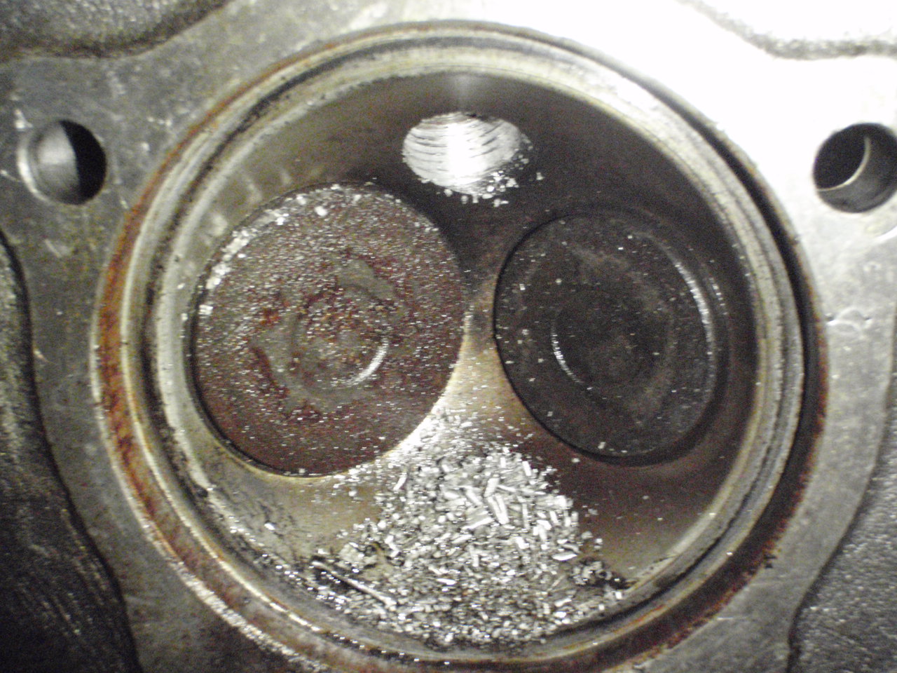

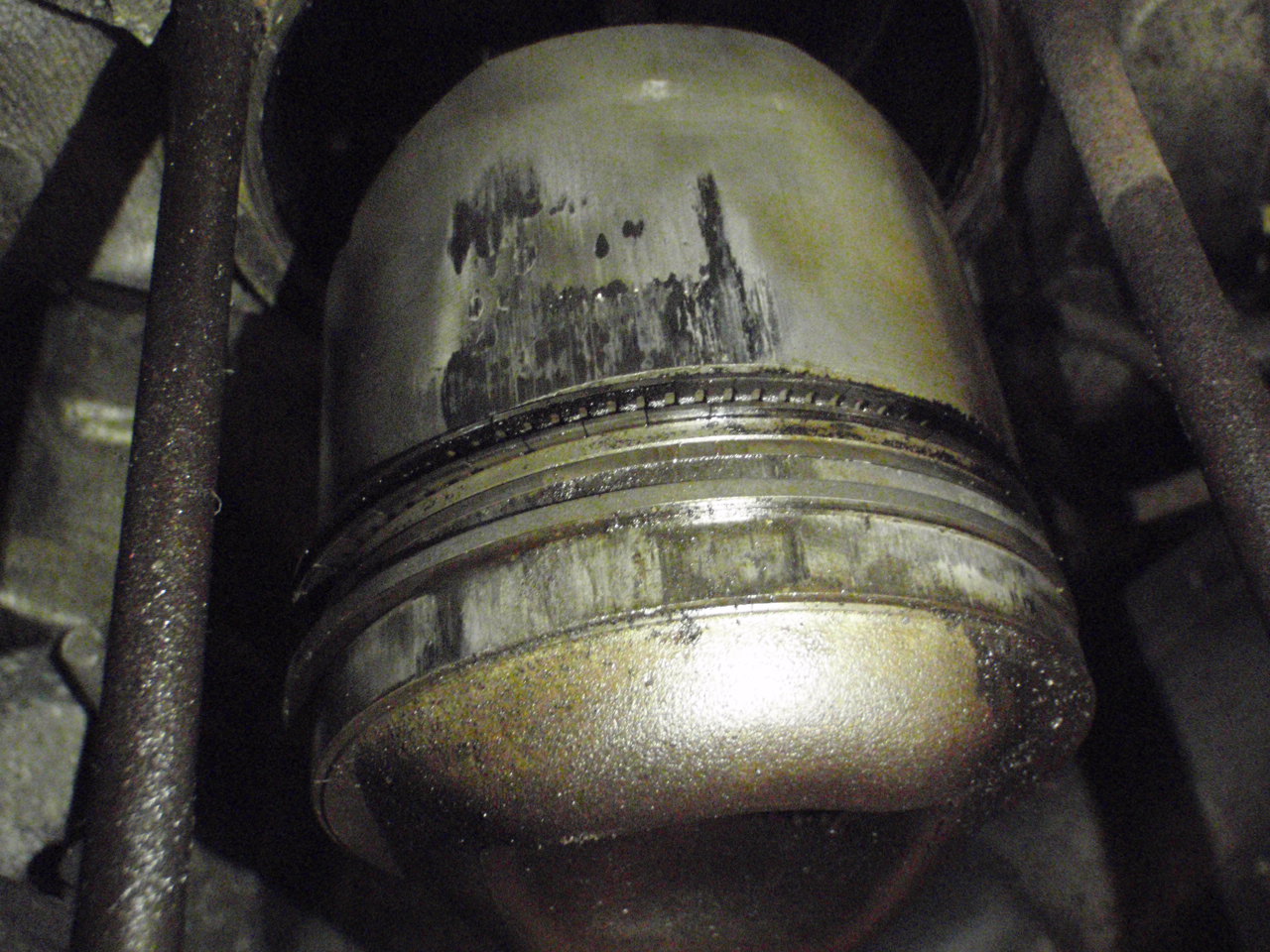

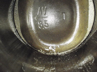

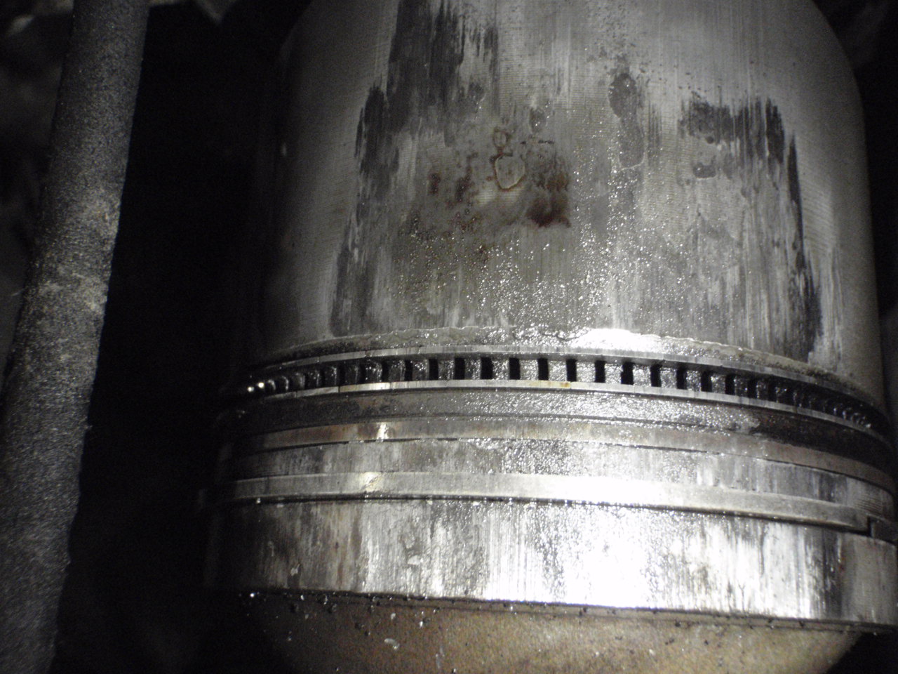

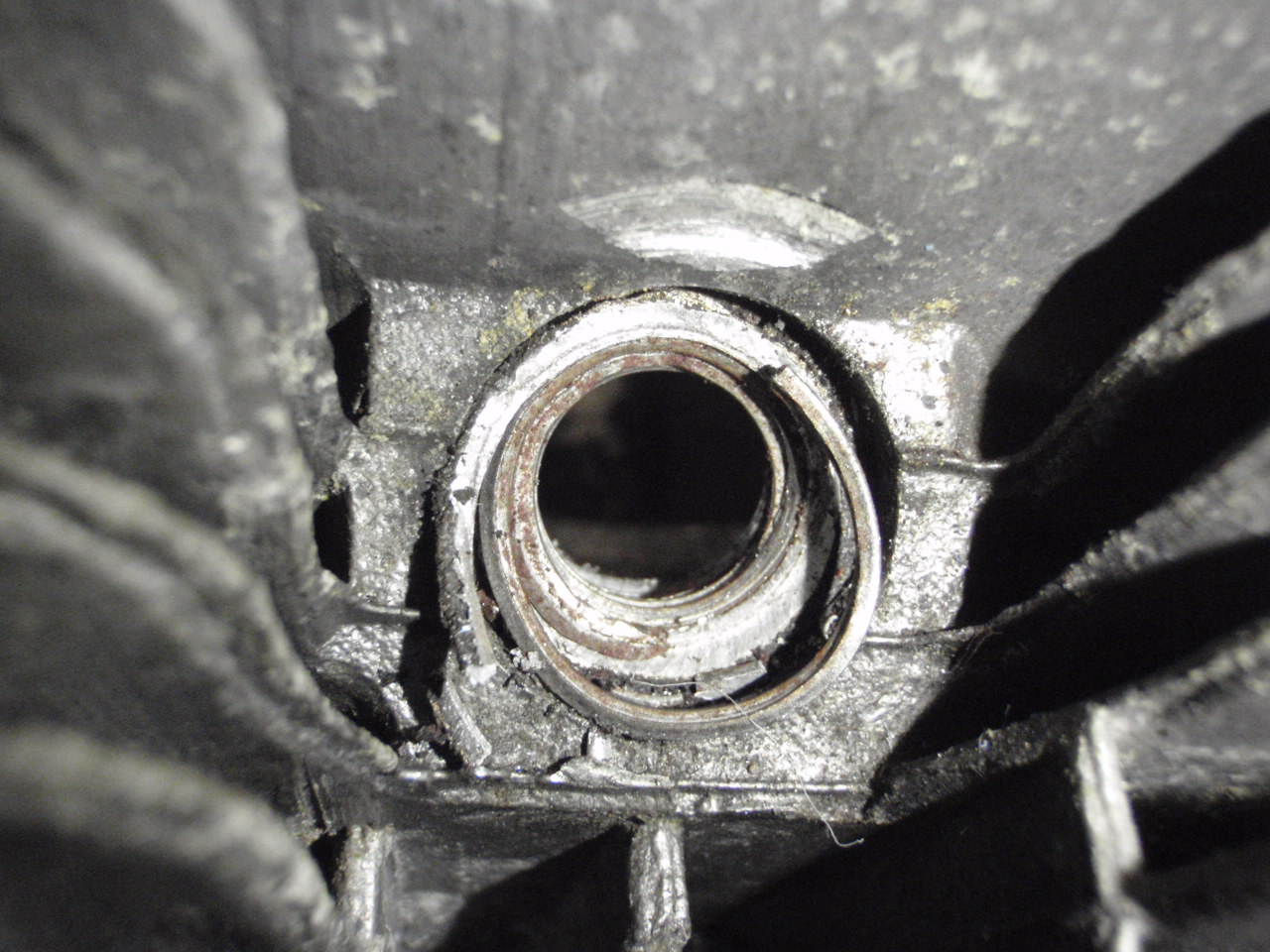

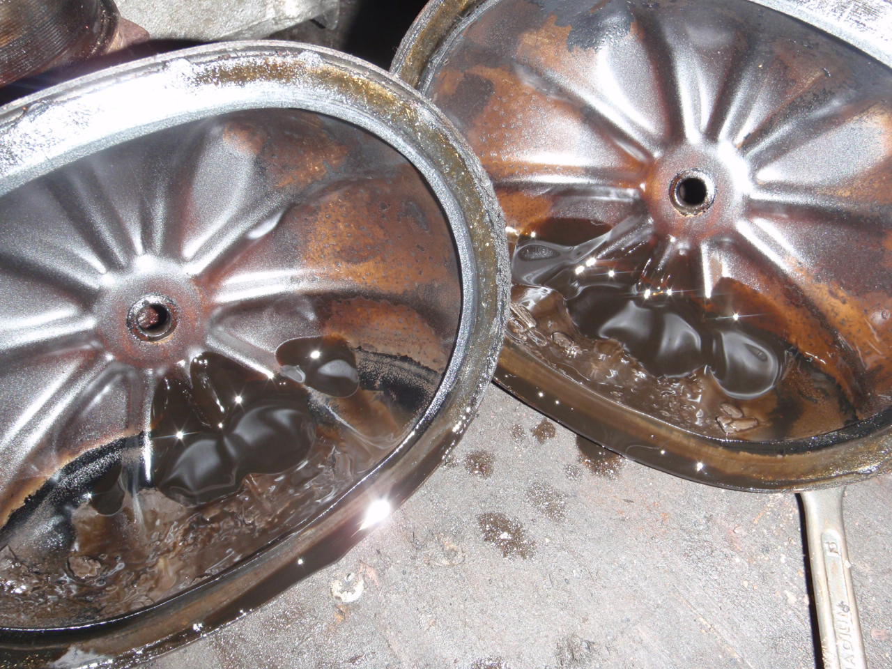

Don't believe what I discovered today.
Mehari arrives with fucked engine. Advice to fix it but owner takes off to buy used engine. Back a week later dropping an engine ''only done'' 40.000 clicks. Asked me to reseal the entire engine before fitting it in his Mehari booked in for next week.
Turned out that he paid 500 euros including 2 tires. What a rip off. Bloody hell, this is sold and done by a so called professional. Haha what a joke. No wonder mechanics have a bad image

Do you also have foto's from the engine which has done 40K ????????
March 1st, 2013, 5:58 pm
Post Re: Bloody mechanics
We quoted for a complete rebuilt, waiting for his verdict. If yes I'll stip it bare to look at the crank and cam. Photos will follow

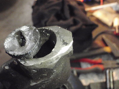

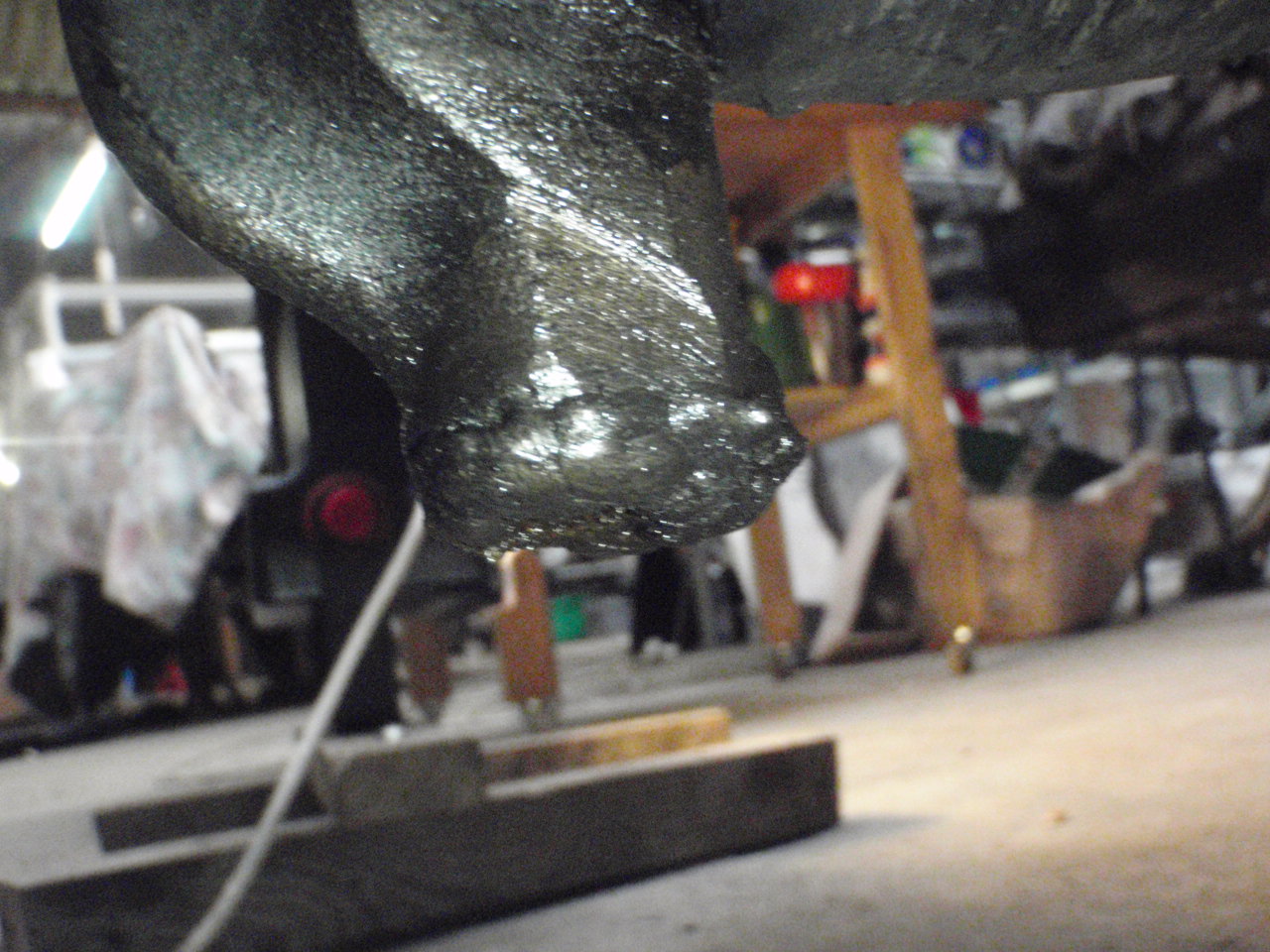

More shit
King pin bottom plug welded. Thread fucked, plug dropping out. What to do? Oh ya weld the bloody thing solid. What a joke.
Pin loose too. Fitted new hub and pin with 17.2 mm, next time new suspension arm.

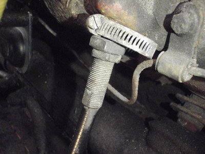

Oh yes, new way of adjusting the clutch. :roll:
