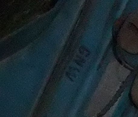

The only number I can see in the photo is this one, which seems to be 6NW? It looks to be in the right place, but doesn't seem right to me. When I put that in the ORGA checker it comes back with 1977, but that seems to be a default response to an assortment of numbers.
I guess I'll have to wait until I pick up the car to make a closer inspection.

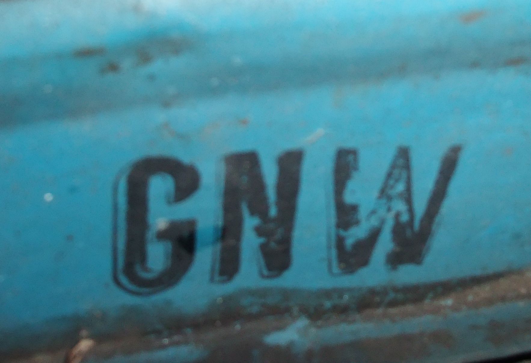

The alleged ORGA number is definitely only 3 characters and is definitely GNW as far as I can tell. Once again, meaningless to the ORGA calculator it seems.

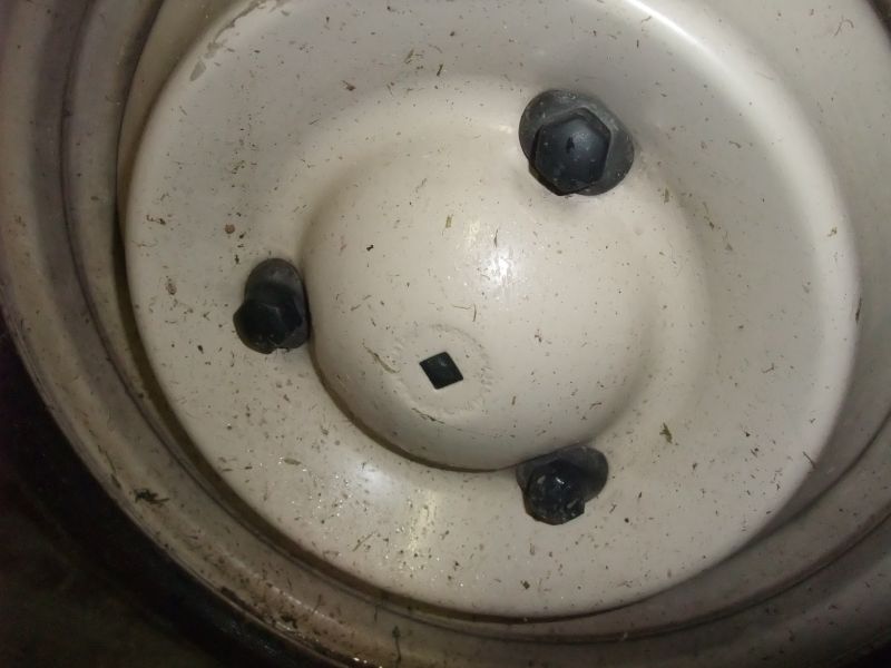

And this car seems to have fancy plastic nut covers rather than hub caps. Does anyone know what year they came along?

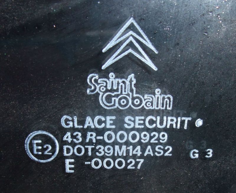

And for good measure, if anyone knows how to suss out the code on window glass, here's a photo of the window stencil

GNW relates to the colour - Bleu Tropiques. This colour was available from late 1983 to mid 1985, IIRC.
The 'Saint Gobain' markings on the glass would point to it being built at Levallois. The plastic nut covers were standard issue.

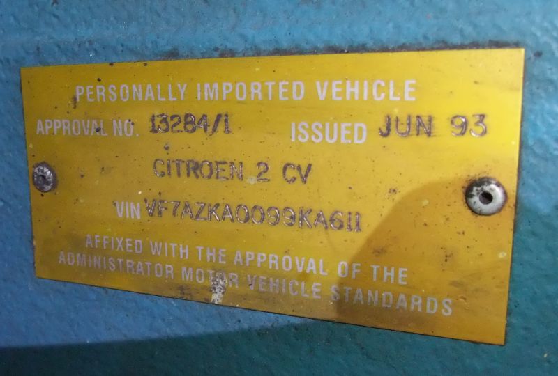

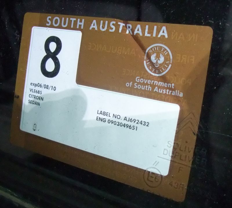

Some more factoids are coming to light. The full VIN for this car, as stated on the build plate seems to have transposed figures and letters, and the number has been incorrectly copied onto the importation plate affixed in 1993.
All that being said, I'm forming a theory that the year of manufacture is reflected in the engine number?
I've seen two numbers that were 1985 and 1986 respectively and they started with 0905.... and 0906....
Our engine number starts with 0903... Does this mean a 1983 model maybe?
Pictures attached for perusal and maybe decoding.
Any help will be gratefully received.
