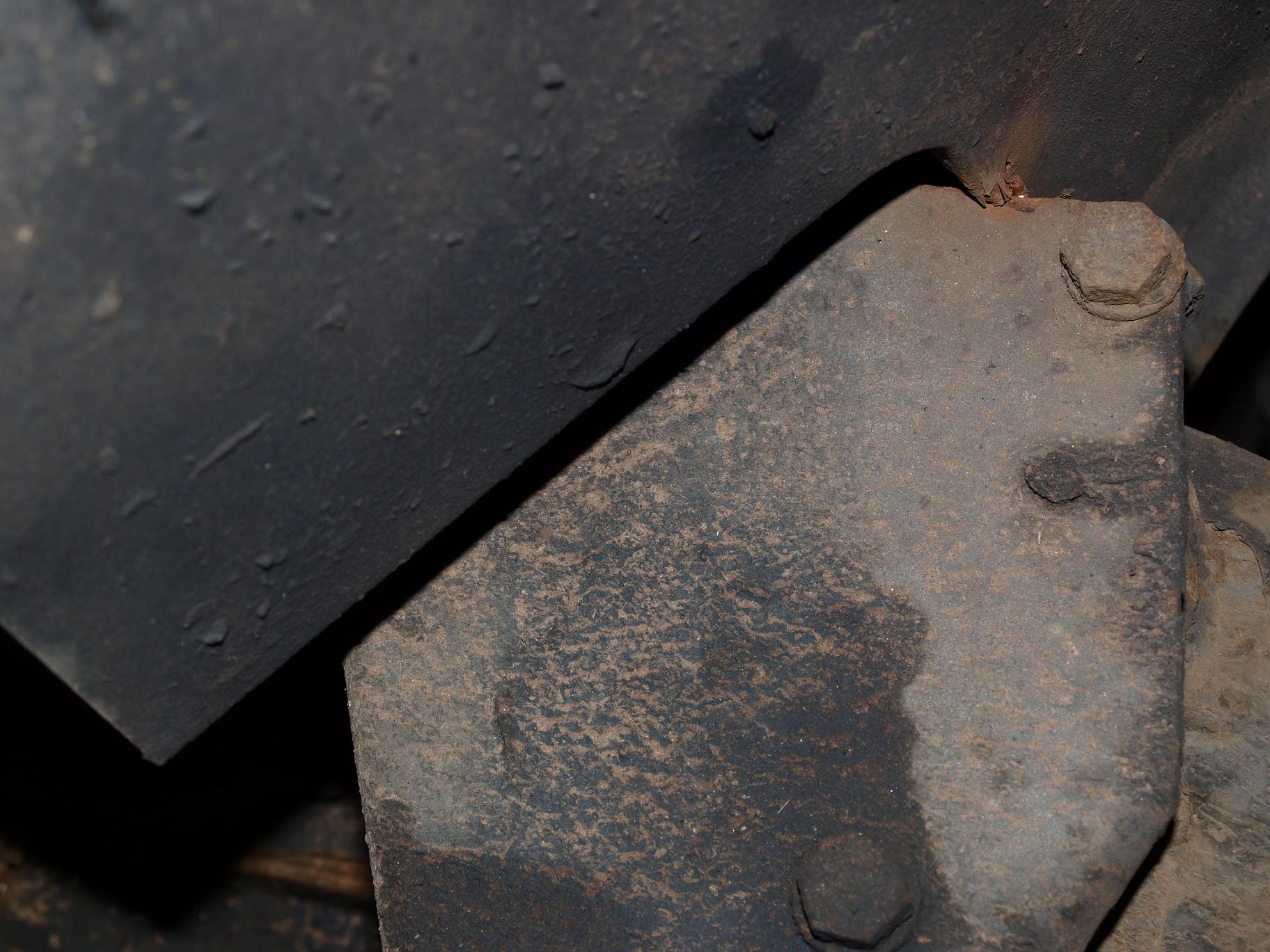

Secondly i've got a very strange noise coming from the drivers side front. I had to get a new wing and have fitted that no problem but every time I go over a speed bump even slowly or turn sharp right I get a "doing" as if somnething is catching. I've looked underneath and cant see anything obvious, any one have any ideas?

Sounds like the inner wing hitting the drive shaft. If you look down towards the drive shaft, how close is the 'sticky down bit' that goes either side of the shaft? I bent mine out of the way :lol:

Watch the inner wing doesn't rip the rubber driveshaft gaiter to bits. Do you know how to disconnect the hood from the front bar that holds it in place above the windscreen?

If they are 2cvchitty wings, they foul on the actual suspension arms towards the footwell side of the car - you have to bend the flat bit away from the arm....know by experience!

Pic to show.....

Thanks for the replies, I found the strap, I thought they were just hand grabs but I dont seem to have an outside stud just the 2 studs inside to make a grab strap. I think the bottom of the inner bit of the wing is catching on the chassis, I have tried pulling it away and will see if any improvement tomorrow.
