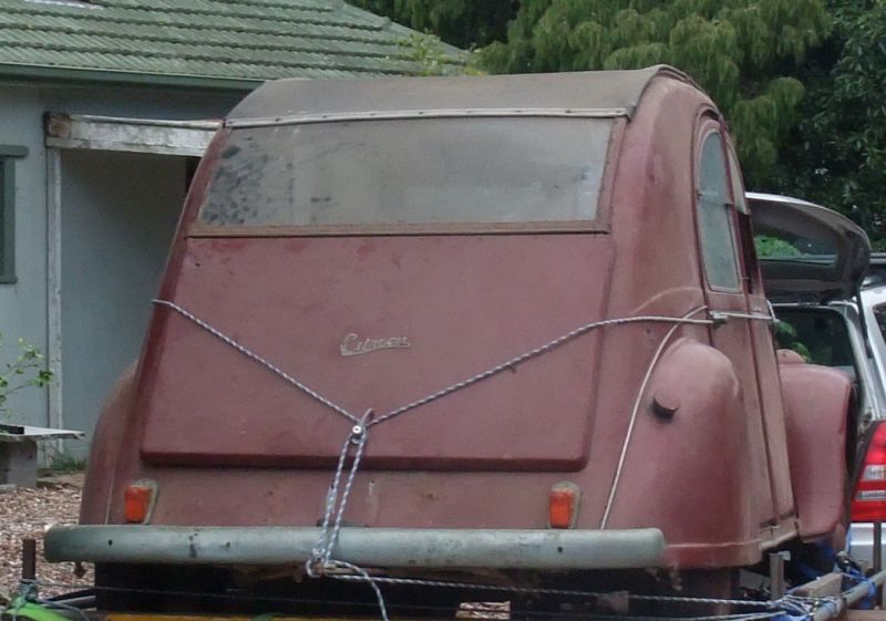

And the little back window. Did this change later to full width or is mine a later replacement? My car has a perspex window the full width and the roof stops at the top of it. I've been informed by the previous owner that he put a new roof on in 1967 or thereabouts, so maybe it's a later one on mine? (Photo attached)

Small back window is original. Yours must have been modified at some time.

rear bumper is A35 van front bumper is morris minor. some had overriders some didnt. those thar did the overriders have got the bottom cut off. wish i could get pics on here id show you what i mean. rear window was plastic not glass. the slough cars were actually made in the uk and to keep the tax laws happy at the time had to use as many english parts as possible to make them english cars. hence the bumpers (MM) electrical system lights (lucas) starter cables and choke cables also morris minor as well as other bits to many to mention. quite a few were expoted to far away places such as australia thailand south africa. india and so on. total left in the uk maybe 20 on the road at present 2-3 including ours. dad has now taken ownership of the slough register that ccc ran (from david conway) hes currantly updating all the info. if you want to know more contact John on 01453 542220 hes always happy to talk slough
