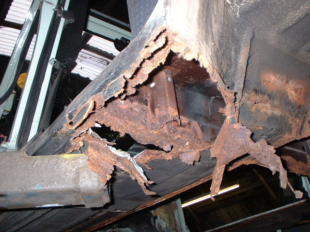

Here's the Full Frontal...
And the Ant 'n' Dec...

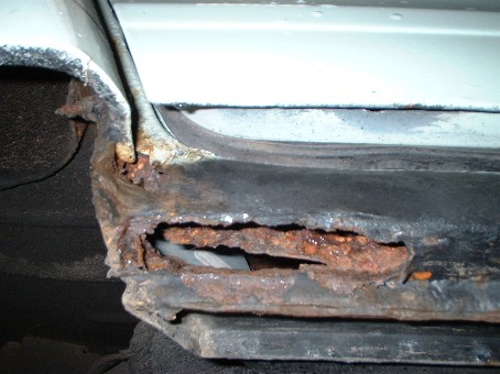

And N/S heel and sill where I poked it wiv me finger...
And the O/S sill...

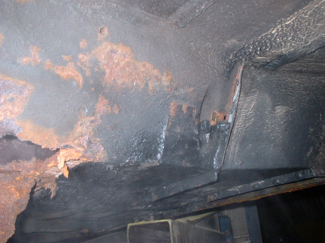

And one repair that had actually been done (must have been really bad), with a neat little piece of tin tucked up in front of the swinging arm, rubbing against it nicely...

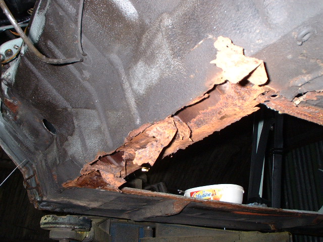

And, whilst it's nothing to do with the MOT, I thought we could share in admiring how the new boot floor has been dropped in on top of the festering rusty margins which have been left in. 'Just pop a bit of weld round it...'
Perhaps we should also consider the mismatched 'pair' of front shocks, one of which was really only fit for the bin anyway, and the rear shock with no metal insert in the bush.
That's even without the quick mask-out and flashover, where he managed to get paint on the window rubbers, mudflaps, etc., etc..
All in all, looks like the sort of the thing the worst kind of amateur does to flog something in Exchange & Mart, with a bit of collusion from the MOT station thrown in. One stop shop, my arse, although, as Total's current slogan in France runs, 'You won't come here again by accident'...
