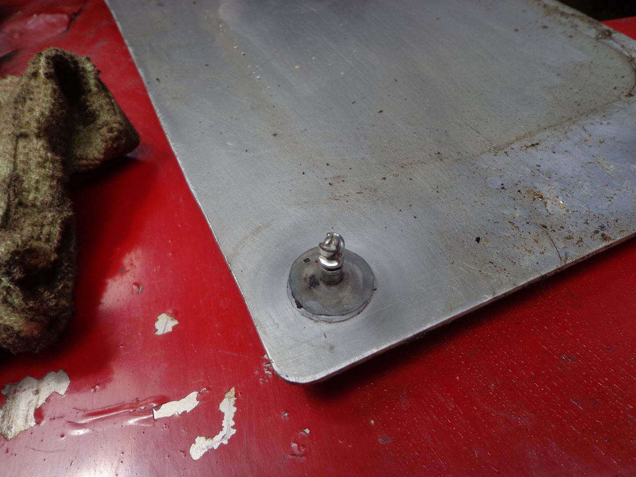

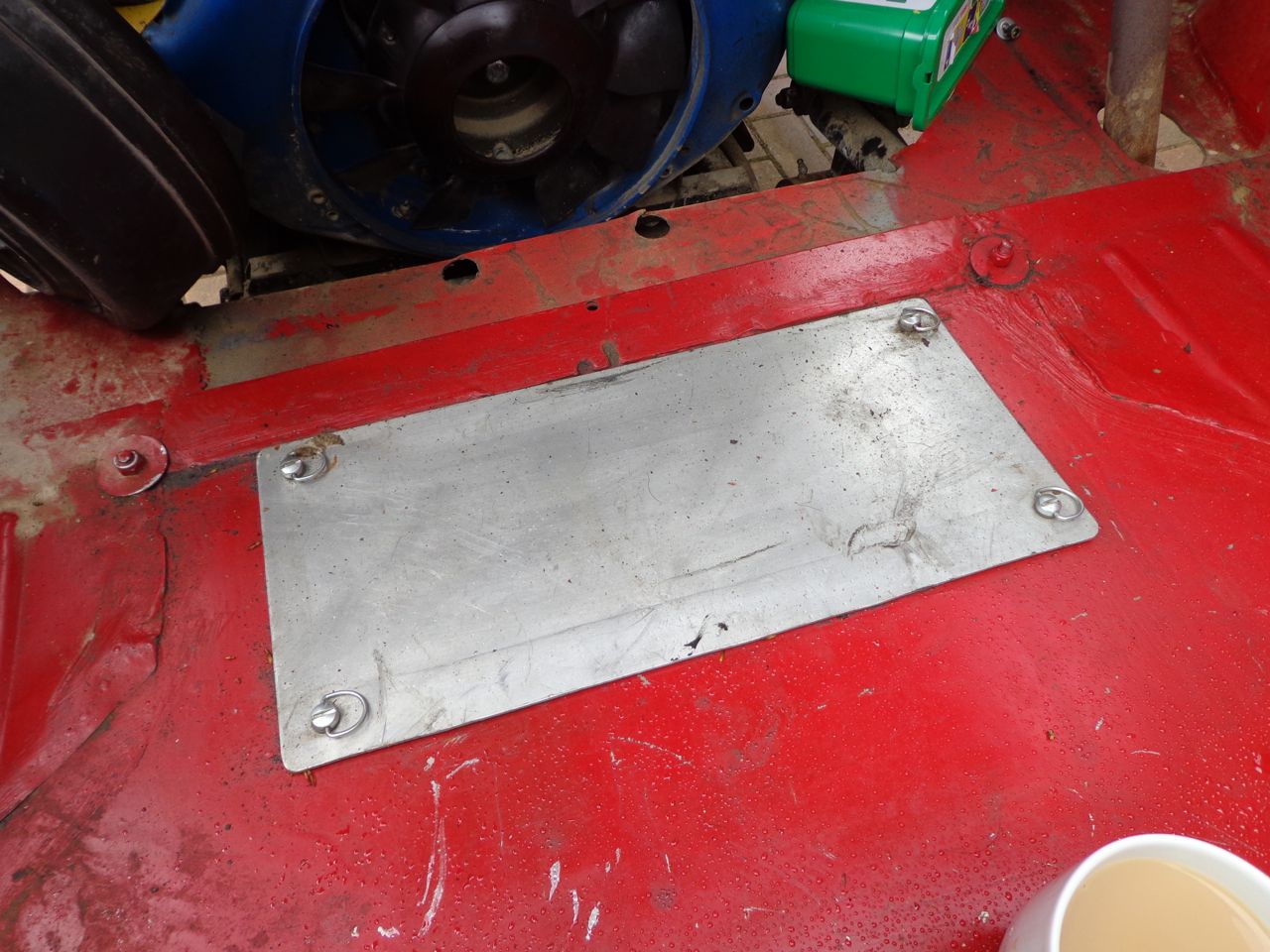

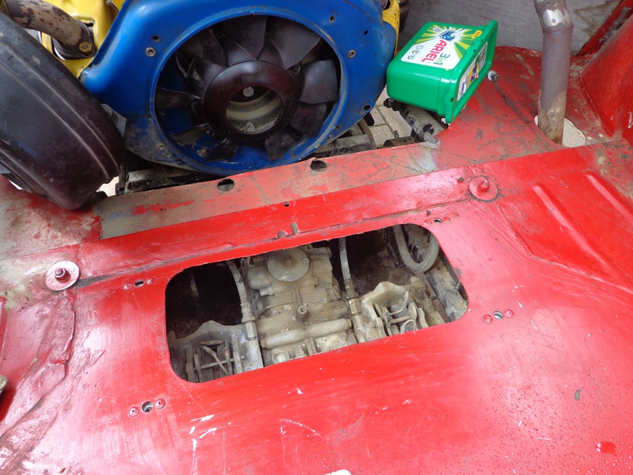

DZUS fastners are for body panels and the like.
Measure panel carefully and select the correct length, else they don't fix properly.
too long by 1mm hence the washer...
Rivet in clips are easy to fix http://www.ebay.co.uk/itm/GENUINE-Dzus- ... 53de05239a
See pics

Thanks for the help guys, might just get rid of the thread, drill a hole through a bit of rod ad stick a couple of R-clips through it... Cheap and easy :)
