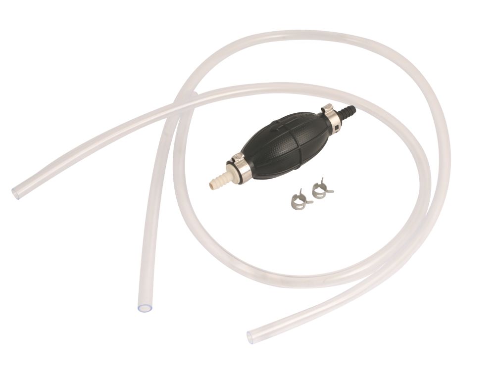

something like this?
£12 from screwfix
March 19th, 2013, 4:20 pm

yes, not quite what i meant, but thatll do!
