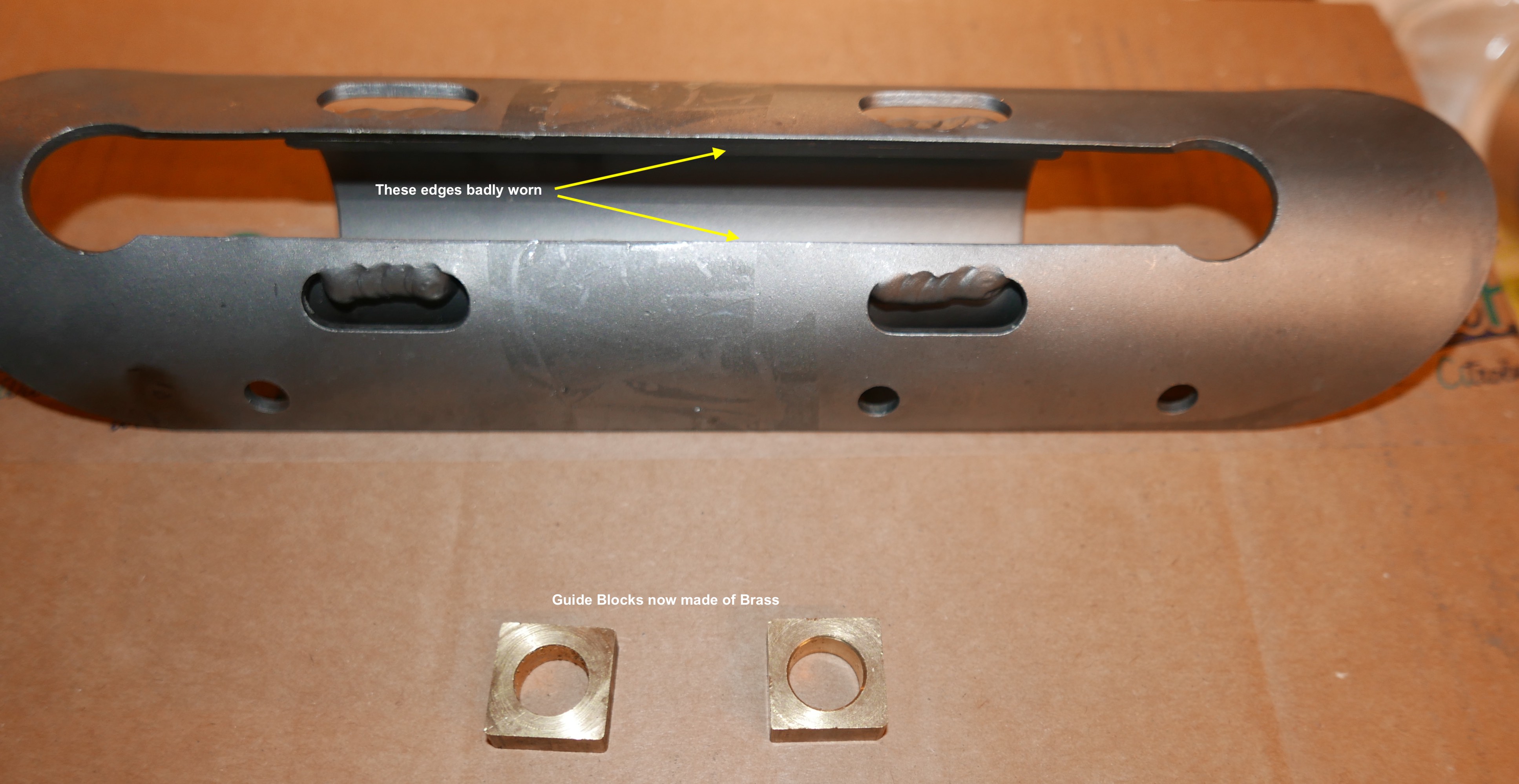

Rebuilding the steering on my road car, last MOT had advisory re Steering!
The guide tube for the rack is badly worn, even new guide blocks had too much play.
A new guide tube came with brass guide blocks.
I assume that they will wear out rather than the steel tube and very easy to replace.

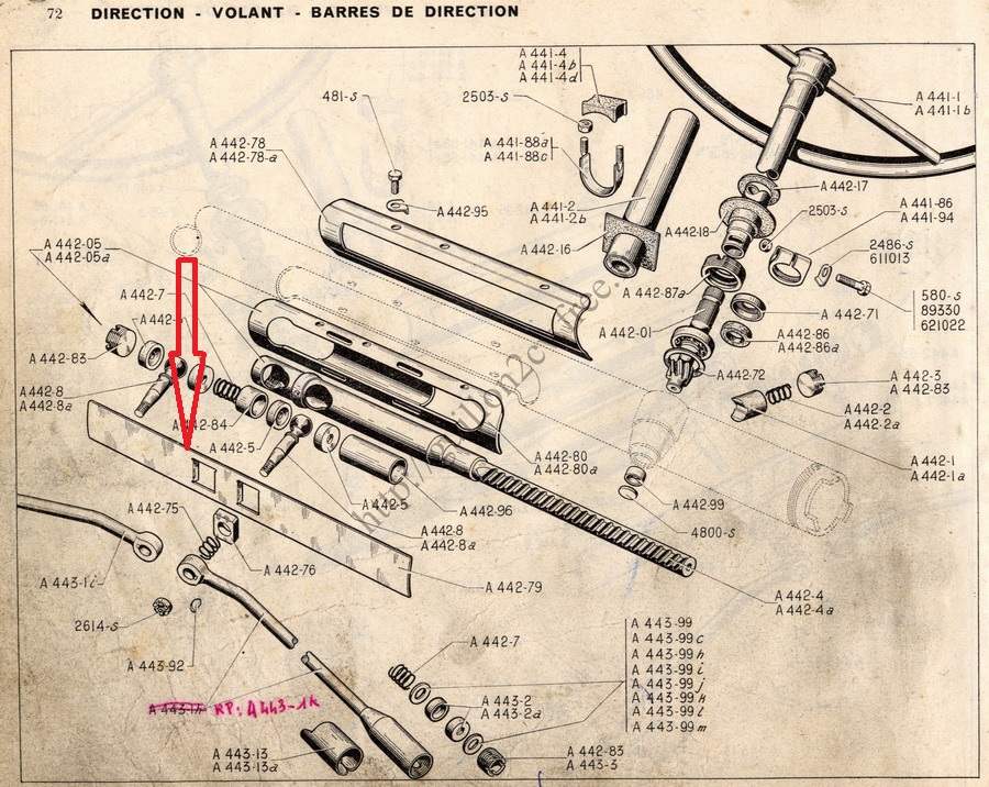

There is plate that slides on top of this, that holds this bronze blocks. Very often the top plate the openings for the bronze blocks are bend or cracked so the blocks get space and your steering gets wobbly.

In my case the blocks and steel guide tube where well worn, due to the many many off road trips over the past 10 years...

Yes thay can wear too;-))
