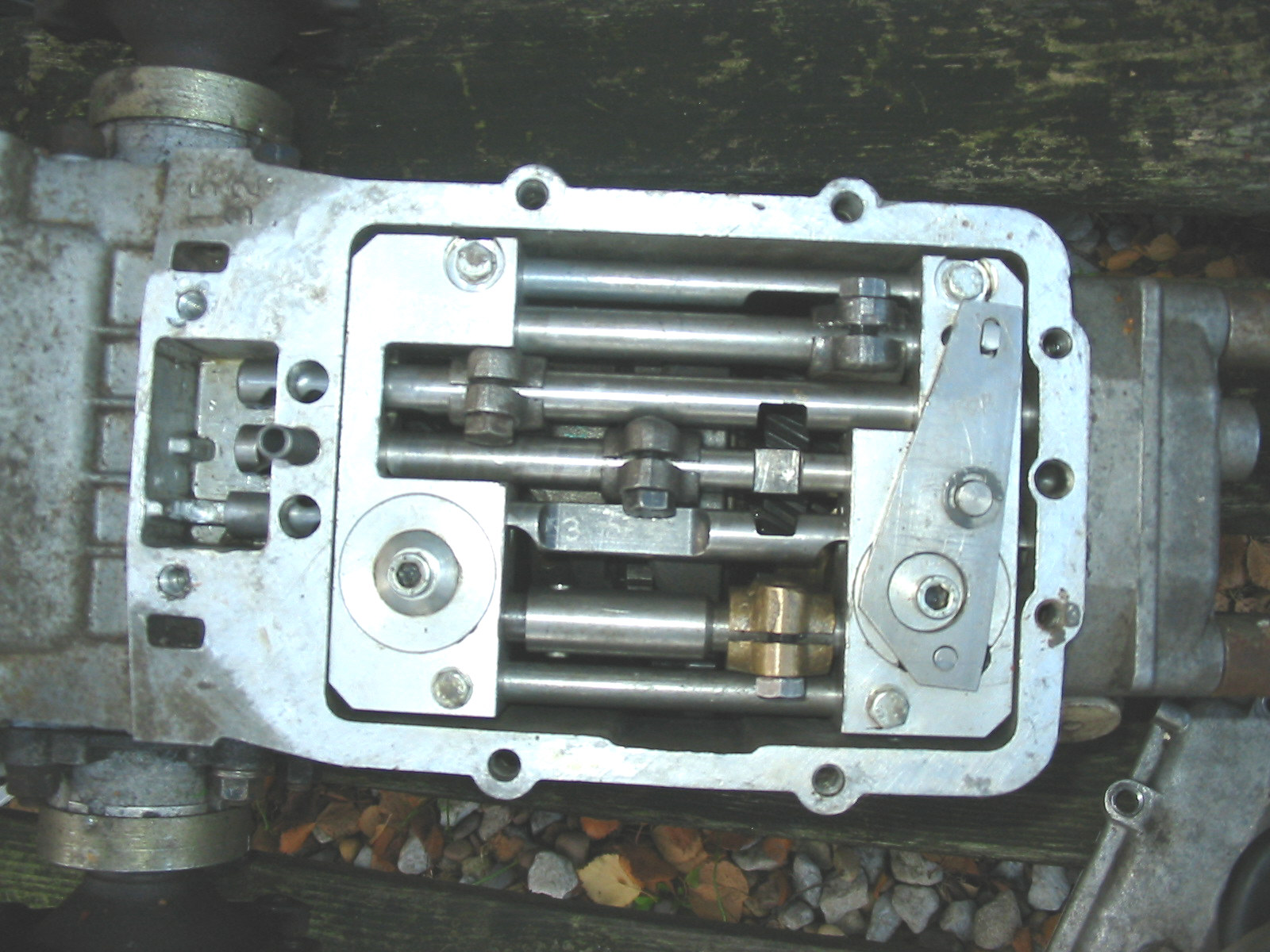

How would you make it five speed?
Topic topic topic :D

Geo, thanks for the info. Nice "mystery" that gearchange mechanism...
The idea came some years ago, and the 5th speed could be made by adding another pair of gears (so called 3rd gears, from back of the box) from 435cc box. So the gearing should be "rising at the same curve" than all other four...
And when looked those sites Geo put, Weber had same idea. There is enough space for the extra gears, just measured the parts yesterday. There is couple of issues to solve, easier is how to engage the gears, much harder is how to operate the engaging. Is it necessary to make that kind of mechanism, or is there another way -time will tell that...
I have made a scetch about gearing, but can't find it now. I'll put it there, or on a new topic, when I find it...

Online
Posts: 2258
FYI
