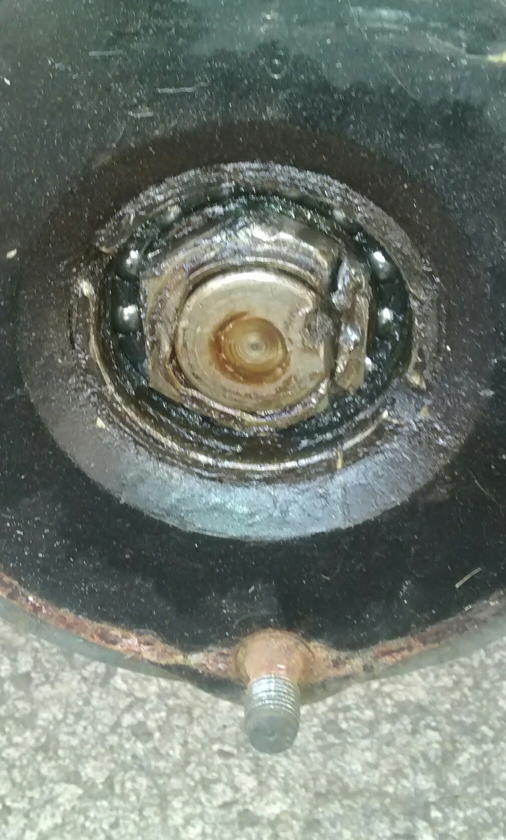

I discovered that this!
WTF !
September 28th, 2017, 10:06 pm
Online
Posts: 2258
My cockup was accidental :D that looks planned :o
