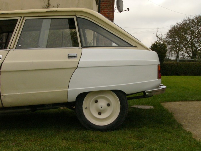

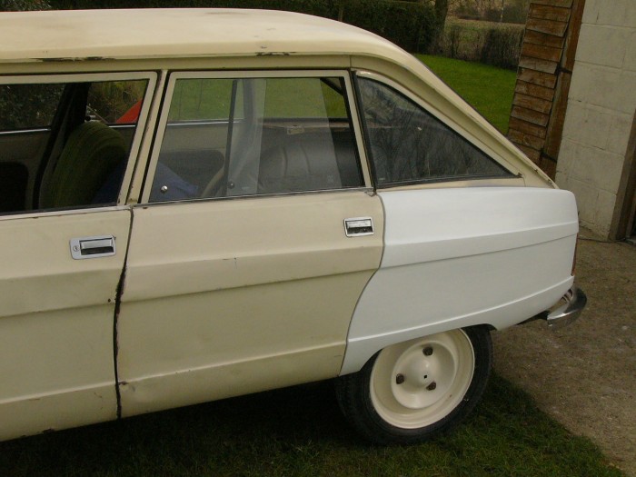

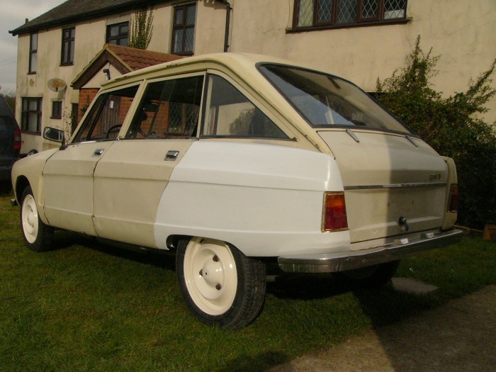

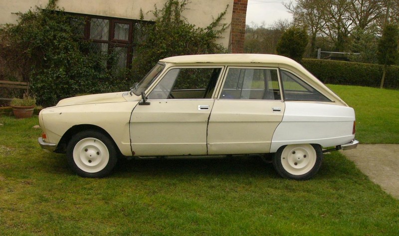

As promised, latest on the Ami Super ;)
..the newly reshaped rear wing (with cut out arch) hand painted in epoxy primer. It's not yet attached, but just resting there for the piccie.
I'm happier with the look (than with the standard wing), and it'll be so much easier to change the wheel now ..as & when that's necessary.! It's a better fit now than the original steel panel, and it'll not rust.. 8-)
