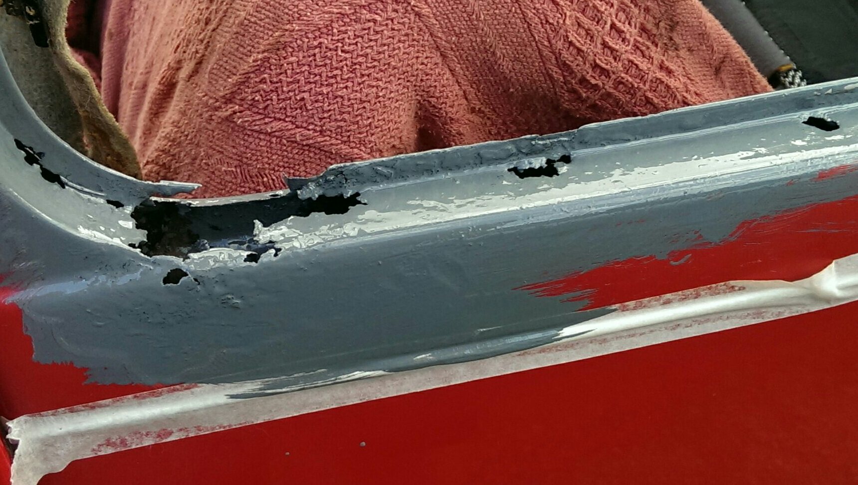

Popped the window back in. I'm pleased with this repair. It went from this large rusty mess (It didn't look this bad until I started poking at it!)

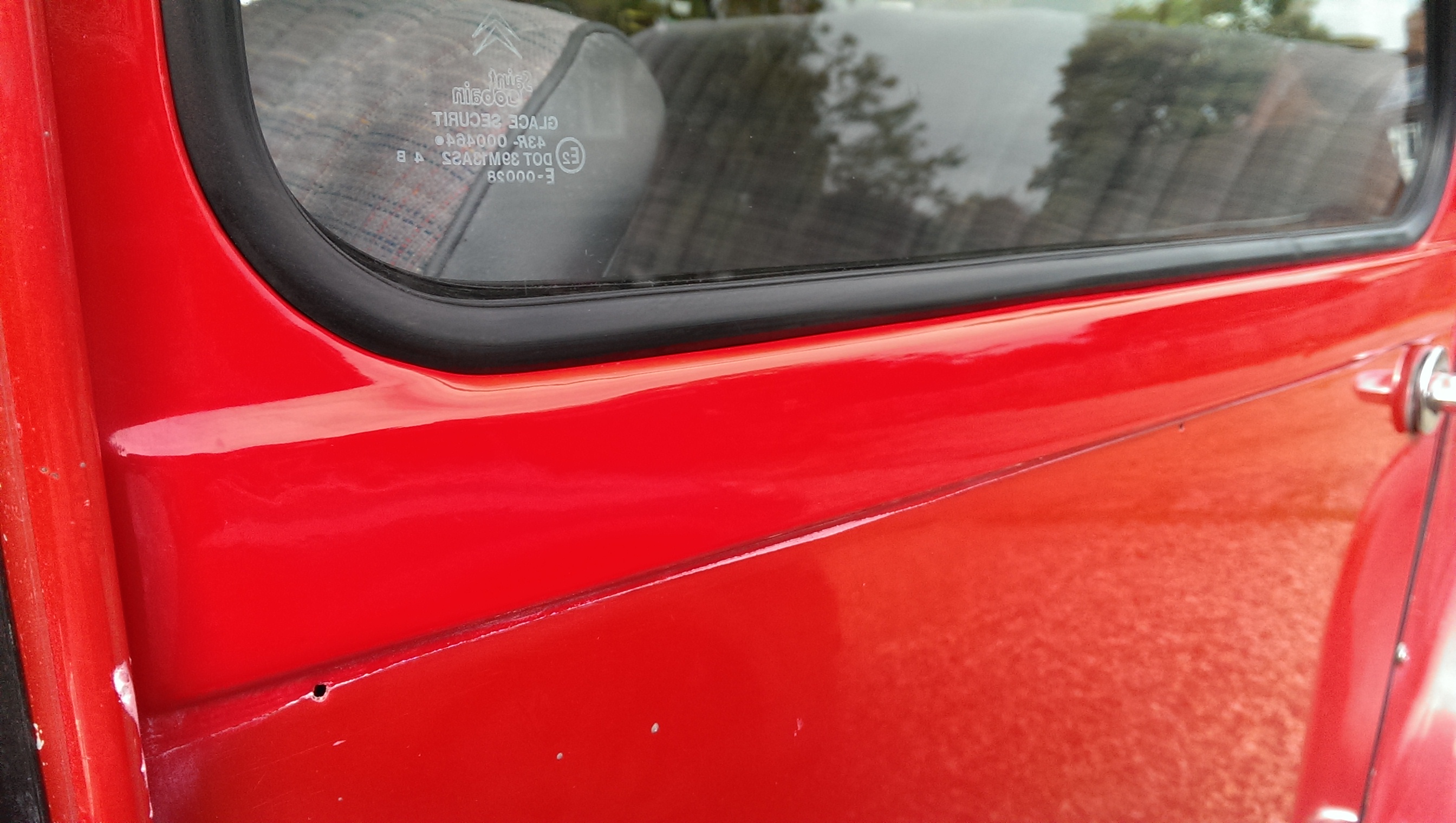

To this. Ta-da. I can't weld or anything so I killed the rust as best I could (Bilt Hamber converter then POR15 paint) & recreated the area & lip with chemical metal filler. Its taken bloody ages! The spray is from ECAS & a fair match.
Still working the on the top of the windscreen panel & above the B pillars on each side....

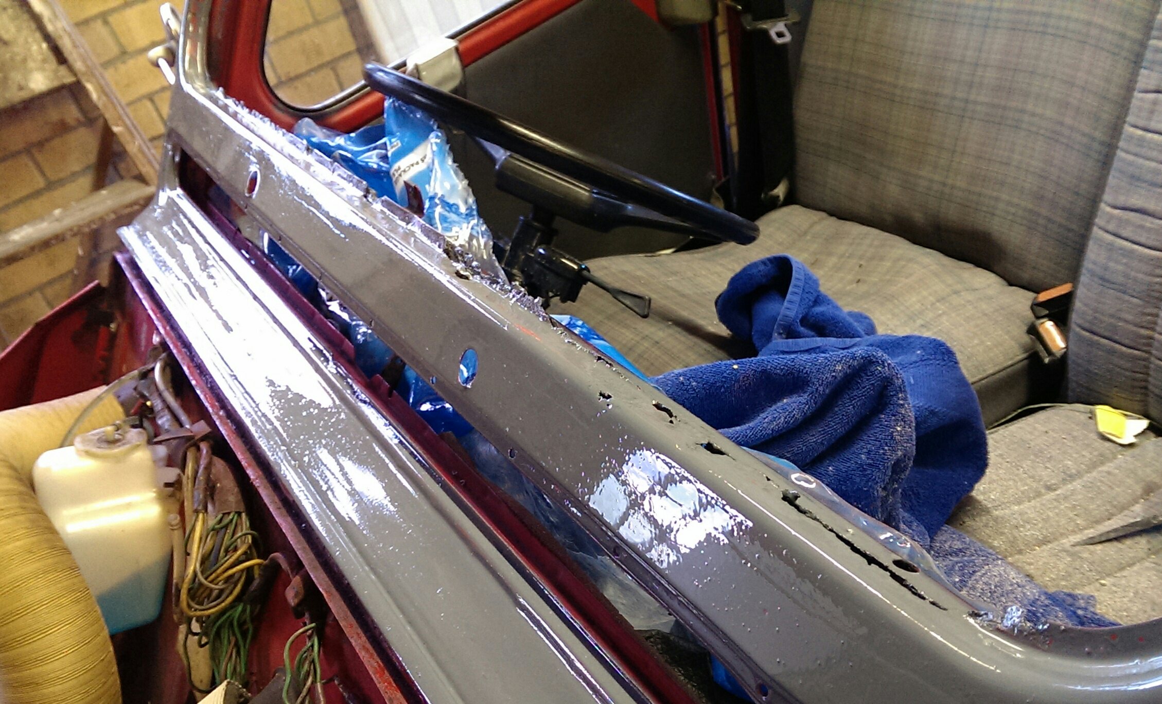

More of this.. Windscreen out etc. Bloody rust. I will proof it as well as I can & recreate the lip like I did on the door.
The grey paint is POR15, awesome stuff.
I have new wiper spindles, new flap fixing strip, & new windscreen seal. Hoping it will be super watertight after this! The new windscreen seal is a lot more supple than the old one so I'm sure that'll help.
I have some decent windscreen sealant too for good measure.
